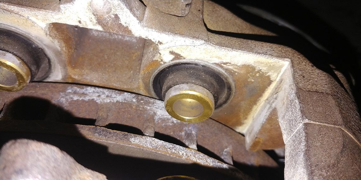

Thanks. That makes since. I do think they are rebuilt because the pistons look pretty new. They have set up and 2 of them started leaking so I figured I should put in the o-rings. Here is a picture I took of the drivers rear caliper.
