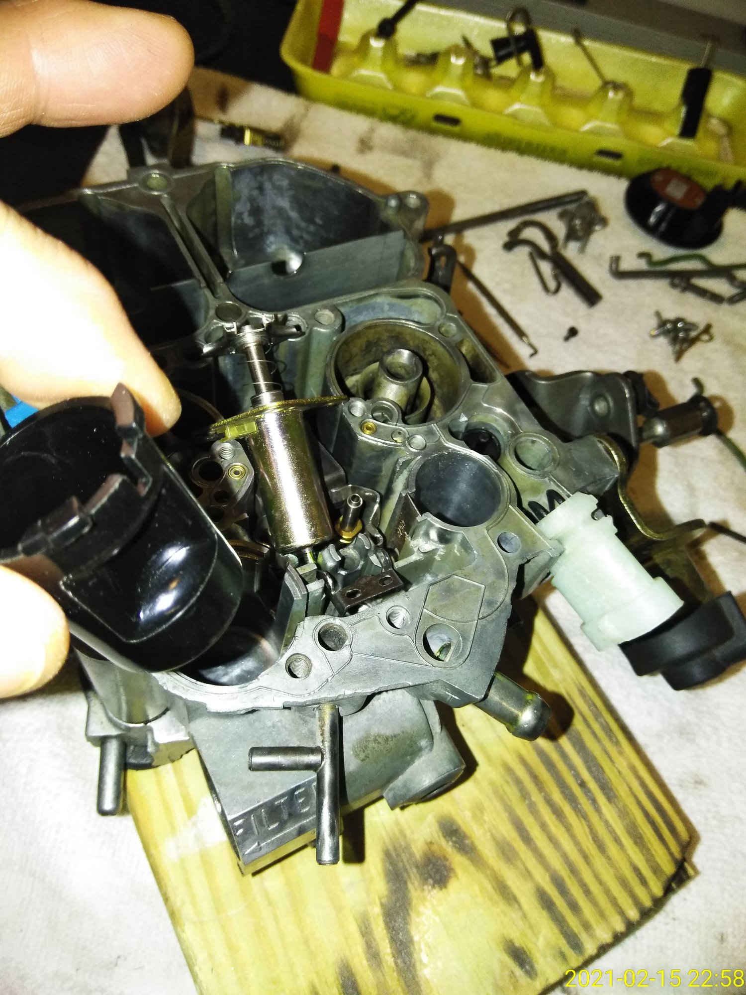

I have a couple of questions. 1-The manual says not to install the choke gasket because of grounding issues. I've used it with a gasket in the past with no issues. 2- Does anyone use the plastic insert that installs below the m/c solenoid?

2. Are you referring to the float bowl fitting? It's been a while since I've looked at an E4M. Do you have a picture of what you're talking abouT?
