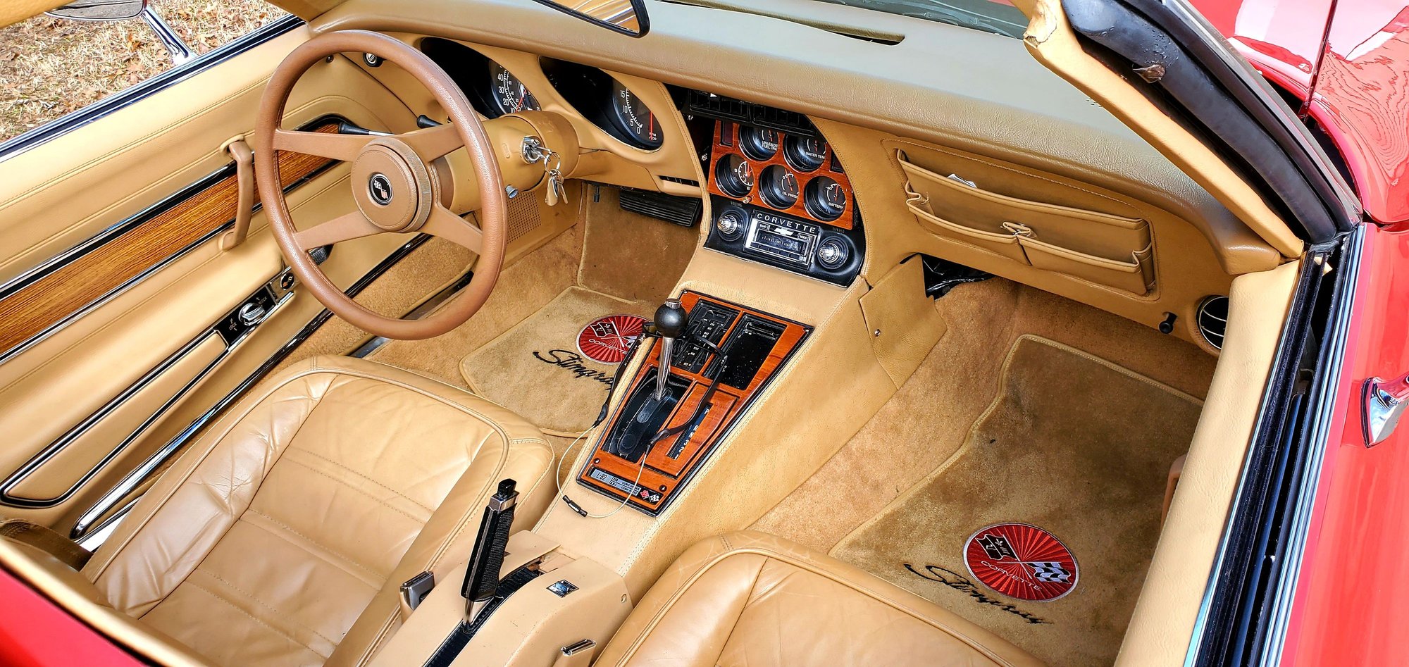

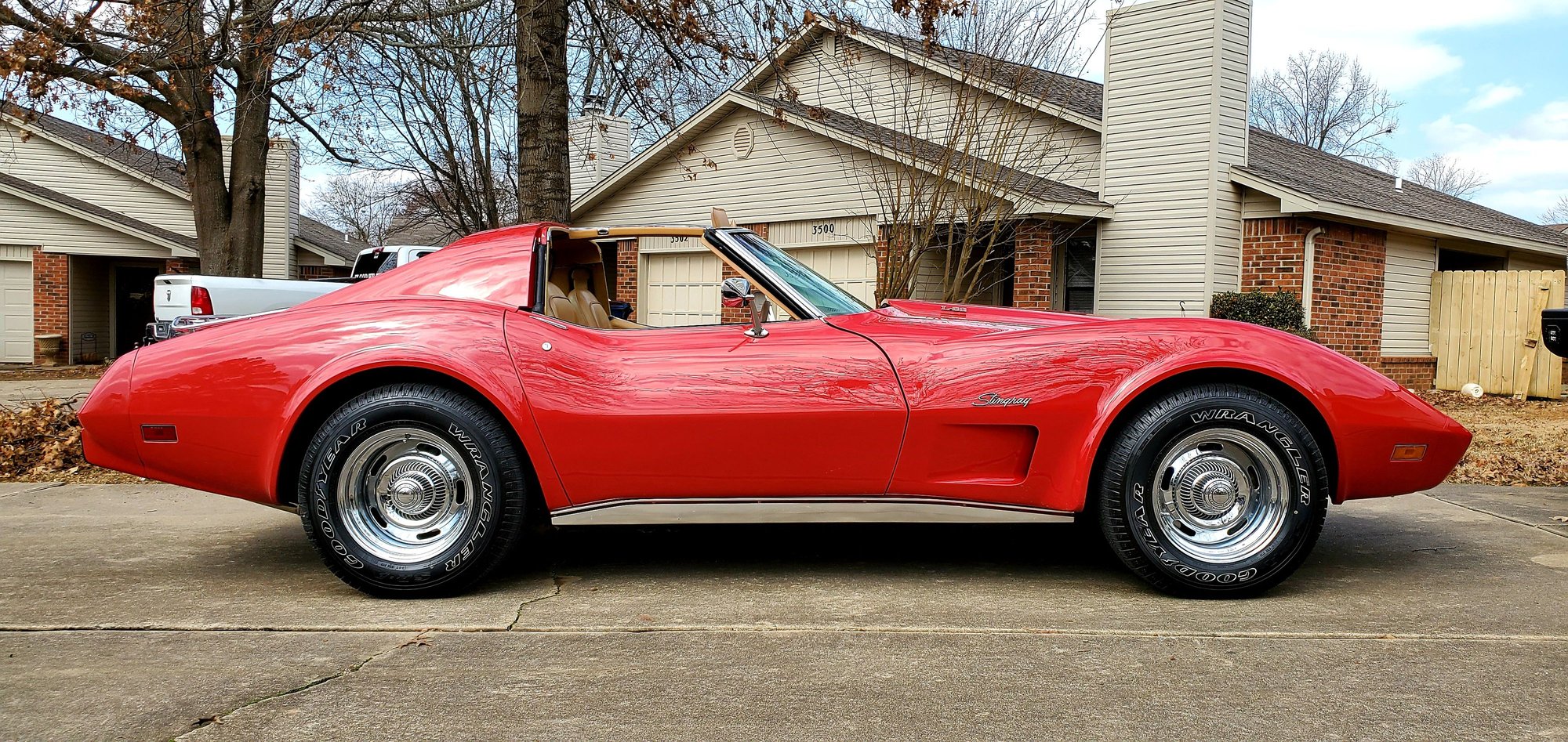

Gladly !!!

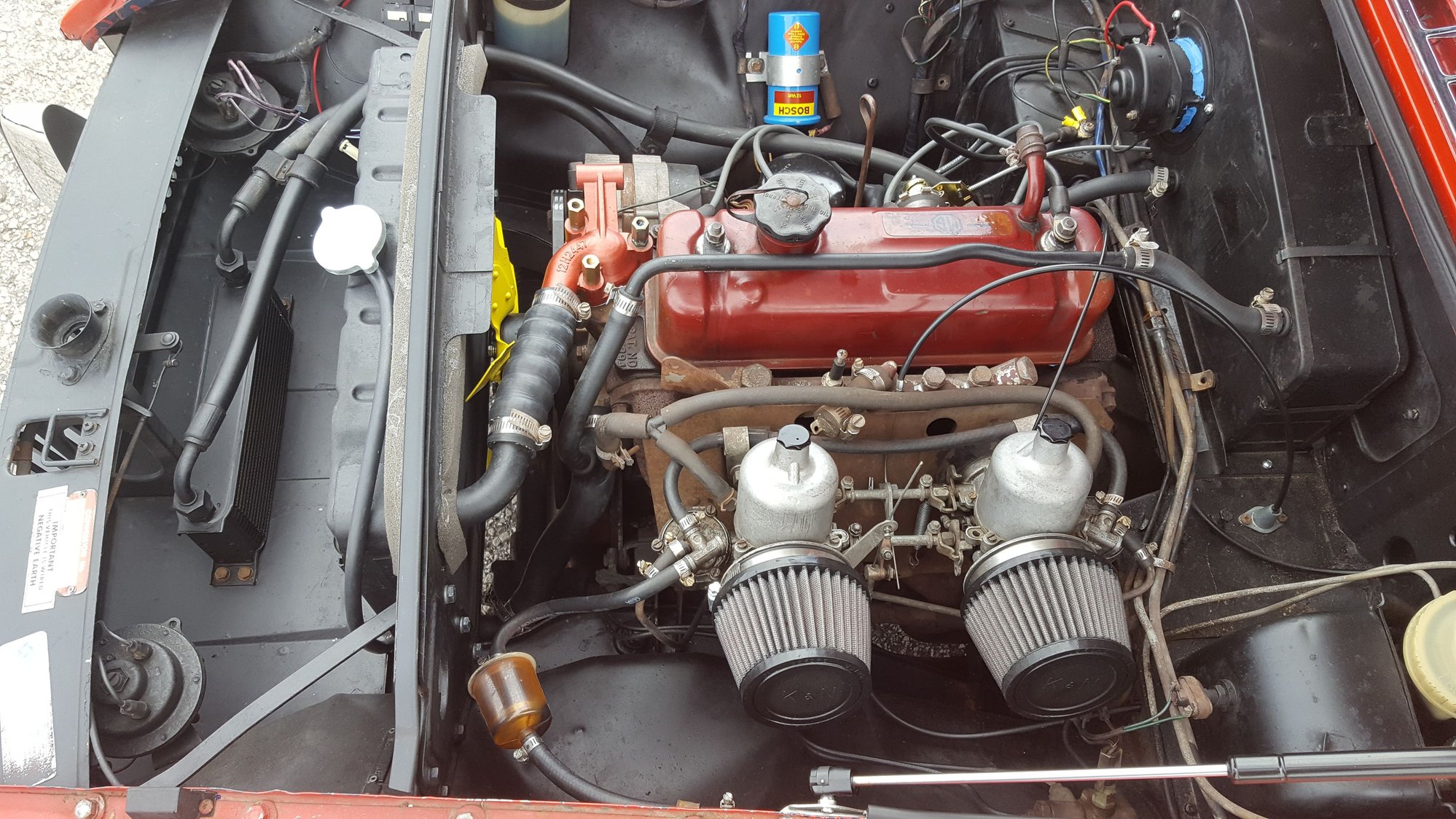

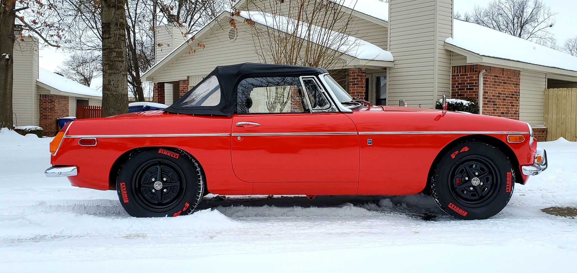

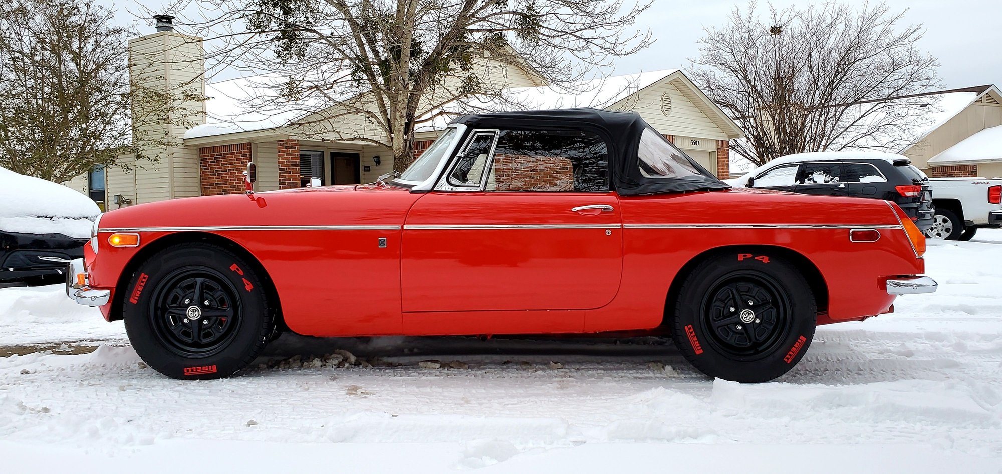

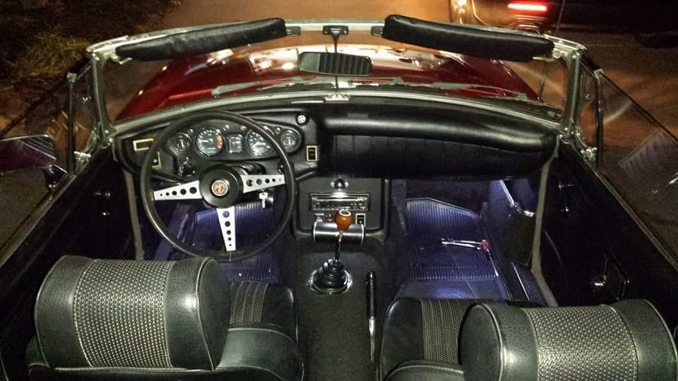

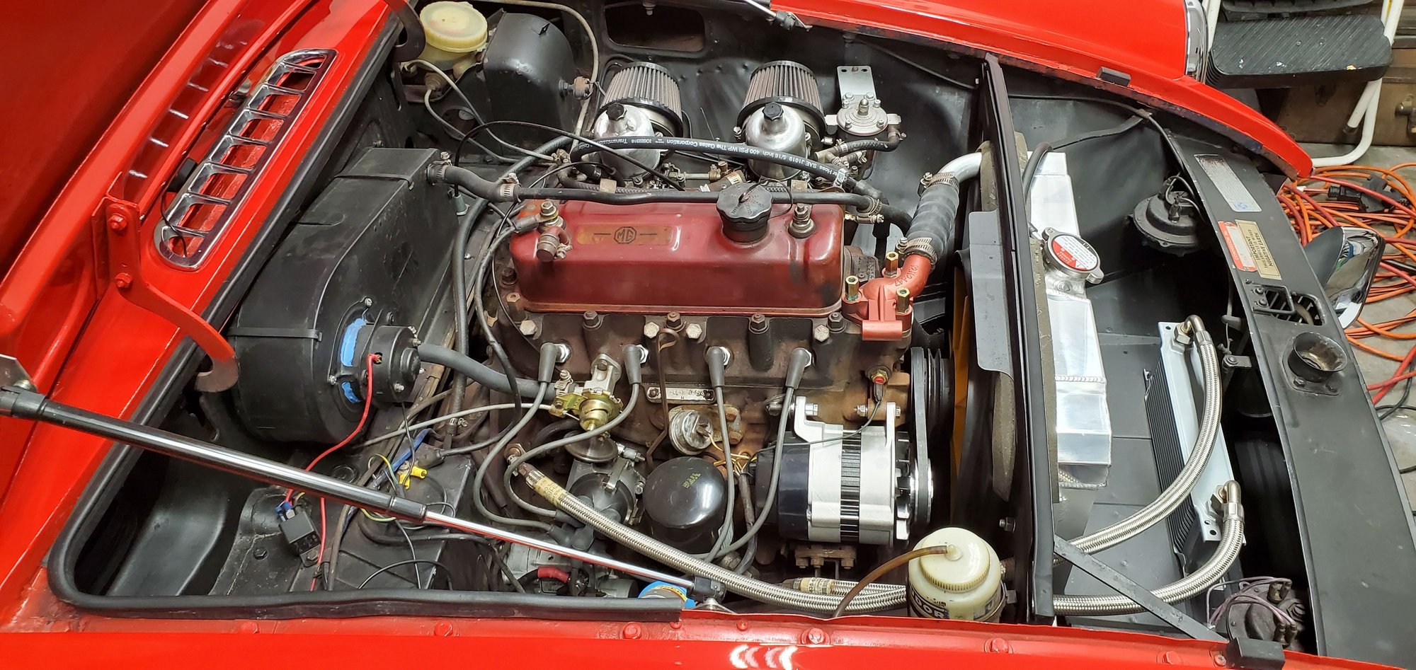

I've restored my 70 MG. I'm getting ready to replace the interior. I've built it from the ground up. I'll give you some photos. MG's I know. HaHa. Let me know if there's anything I can do to help you. I know it backwards and forwards. I even have the original mechanics manual from England. It was impossible to get
