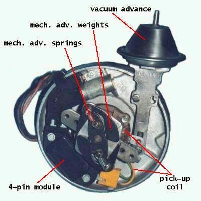

I think I see a problem. Note the connector that goes to the Modge. (post 19) The letters "G" & 'W" are engraved.
I believe those stand for: Gold & White.
Flip it over.
And, just because. Put a dab of heat resistant grease under those weights.
And the occasional On again / Off again ignition issue is a classic sign of those modules. They get hot inside which breaks the circuits. After a cool-down the connections are restored.

Pretty sure it stands for Green and White. I would replace the electronics in the distributor myself rather than a whole new distributor.. After doublechecking the wires.
Like in this pic.

But the wires there are: Gold & White. No green. Post / picture 19

are you sure? What I see could be a very faded olive green wire and a white.

Has anyone ever had to replace a distributor pickup coil ? Any good tips on how to do it ?

Just wondering why you bought a bunch more parts to try to do the distributor again?
The amazon link I sent was the correct one....the other link was just for a description....
Buy the GM unit, drop it in and be done with it....
There are no tips on changing the pickup coil....knock the pin out for the distributor gear and slide the shaft out....swap pickups and slide the shaft back in....you have to pull the distributor to change the pickup so why not just put a new unit in? And the GM unit will run better as it has a proper curve in it....
Pulling the distributor is easy....so is setting timing...
Of course.....do what you like, but just trying to save you a headache.....

You have to put the distributor, knock the roll pin out of the distributor gear, remove gear and shims (if any) pull shaft out, remove the (3) screws holding the pick-up coil retainer, remove retainer and coil (notice where the wire are position "clocked", re-install new coil and retainer, slip shaft in, install shims and gear then tap roll pin back in.
When removing distributor rotate the engine so the rotor is pointing straight ahead. After loosening the distributor clamp bolt (you will notice it can be slid back does not have to be totally removed). (now hold the base of the distributor and note orientation to engine and do not let it spin while you are pulling it out). pull the distributor up and you will see the rotor rotate as you are pulling it up. try and pay attention to how far it rotates and direction when you have it completly pull it out. (you will need to know this so you can put the distributor back in at the same timing position
The distributor also drives the oil pump, The roll pin you removed is the pin that engages the oil pump shaft. After you have totally removed the distributor you will need to re-clock the oil pump shaft using a long bladed screwdriver. (it is simple) Hold the distributor in your hands by the bas with the same orientation that to had when you took it out, spin the rotor to the same position as it was when it stopped turning when you pulled it out. Now notice the orientation of the roll pin as to the front of the motor, is it at a 45 degree angle from centerline of the motor or 90 degree or is it on centerline? It doesn't matter just notice the position so you can look down the distributor shaft hole with a flash light and rotate the slotted oil pump shaft to the same orientation as the roll pin on the distributor gear. Now insert distributor into hole, the rotor wil now spin the opposite direction than when you pulled it out and if you did everything correctly the distributor should sit ALL the way down tight to the intake, if there is an air gap you did not have the oil pump shaft lined up with the roll pin on the distributor, just pull it out again and rotate the oil pump shaft to match the roll pin position and try inserting it again, it might take a couple of tries but you will get it. One you have it down slide the distributor hold down camp over the bottom distributor flange and snug up the bolt. Re-install cap, wires ans start motor and check timing.
I have had to do this on the side of the road when my pick-up coil died in my '78 Camaro. when I got it home and checked my timing I was off only 2 degrees. hope this helps
