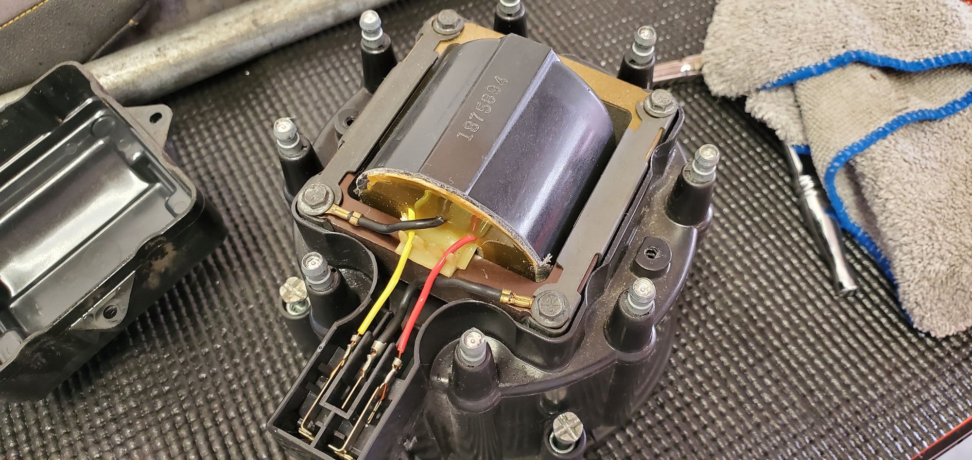

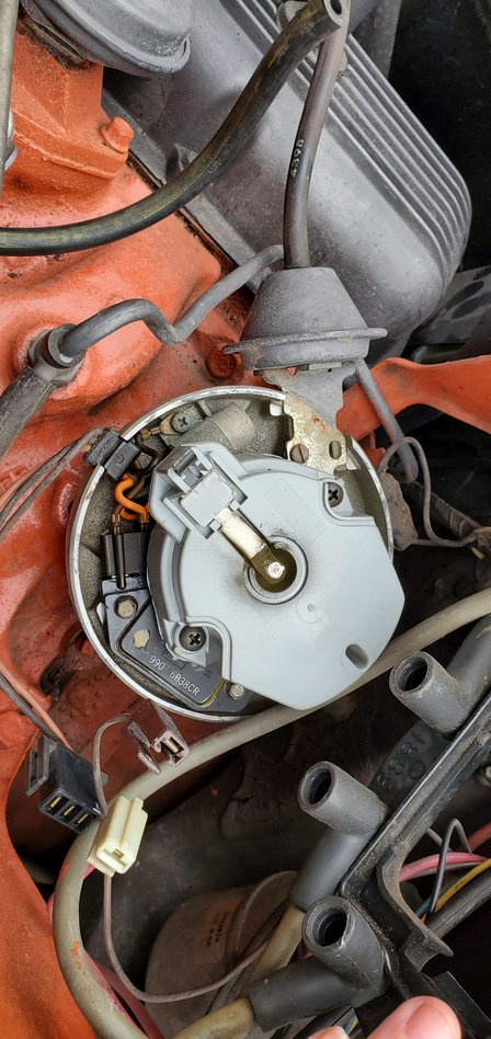

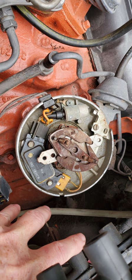

I got it apart. Here are some photos

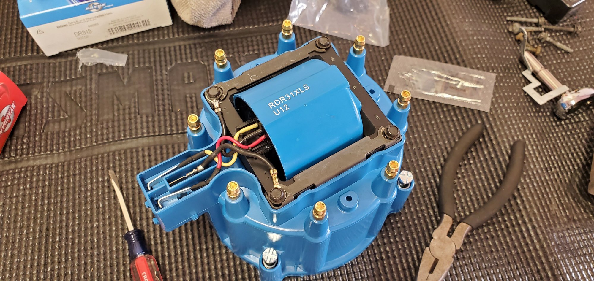

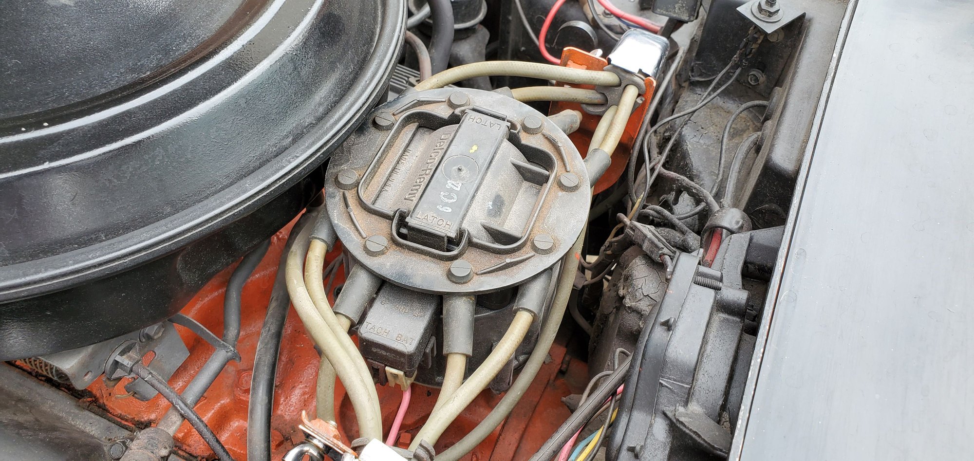

I took pictures. I always do. Here's after I installed the module and the new cap and coil. I put the pin with the spring in under the rubber washer. The only thing I didn't replace were the weights and the distributor pick up coil
