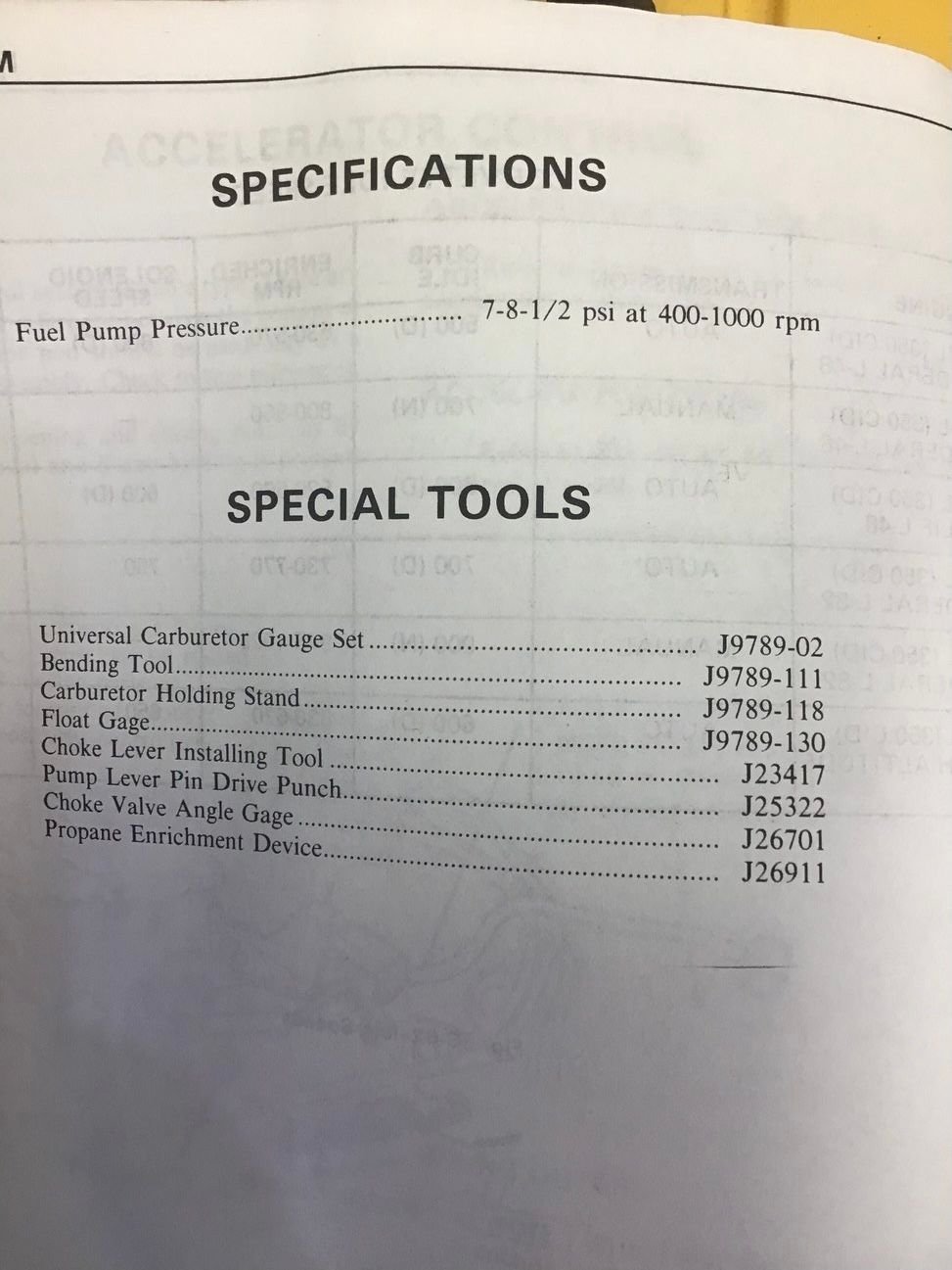

I would pull line to carb and measure pressure and flow while cranking..pressure spec n pic..flow i have to look up..
other than that maybe float stuck or misadjusted? Clogged sock in tank?

Ive yet to T- in my gauge, but the sock in my fuel tank is visibly dirty. When I had the gas tank out, I checked it, it seemed to flow ok, but I already ordered another one. once I get the tank back in, ill check the floats, thanks.
