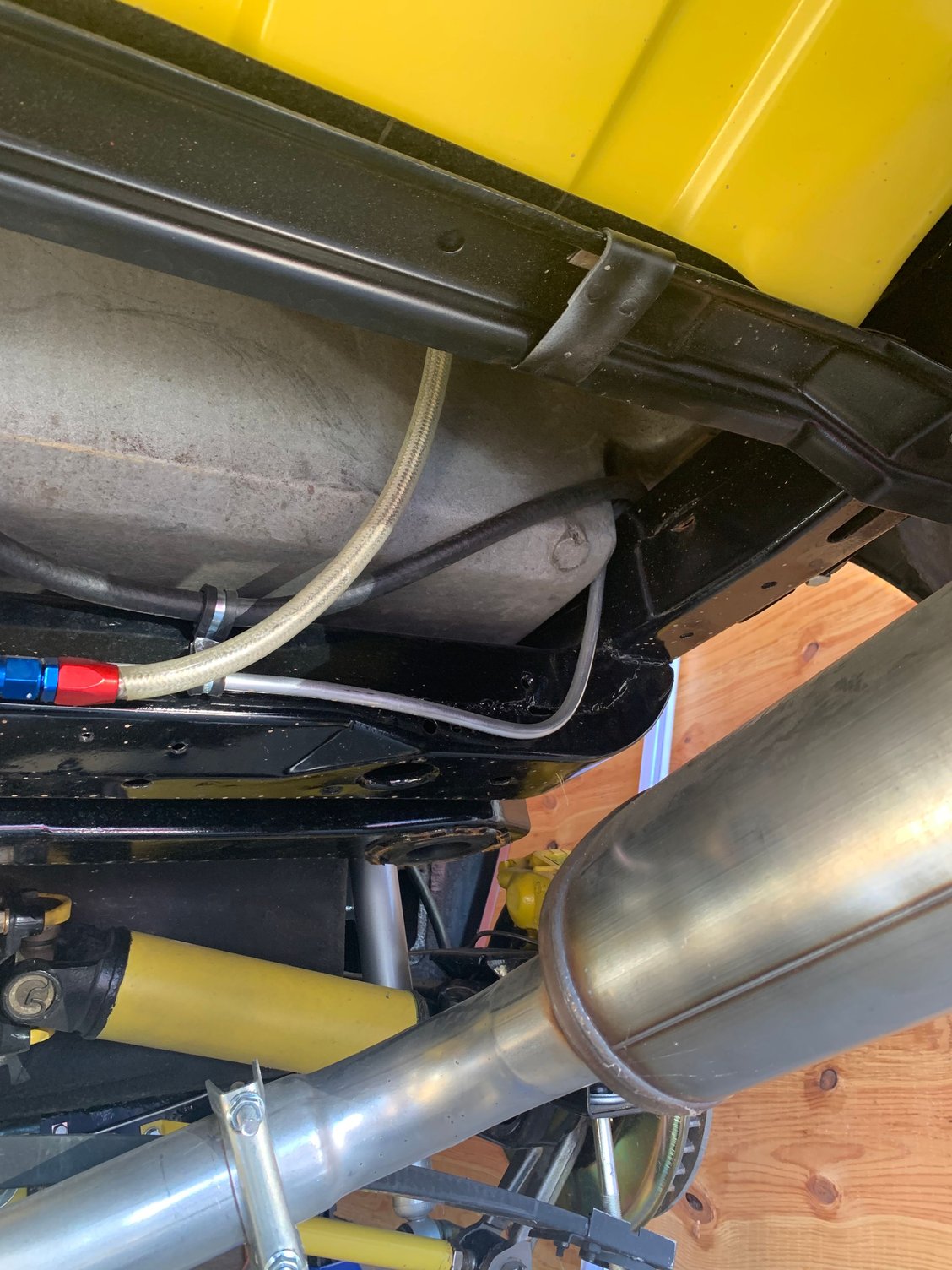

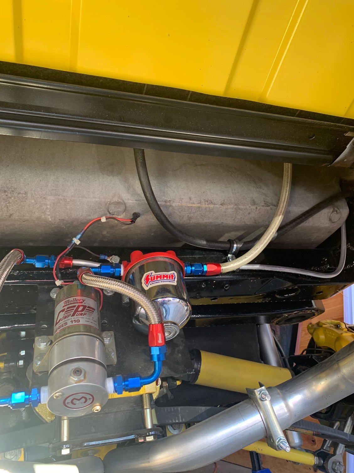

Running the return line for the FiTech fuel injection. So thought I would post a few pickies of progress so far. The fuel pump seen in one of the pictures is the low pressure fuel pump used for the carb. I will be keeping it since I am using the Force Fuel system.
Return line adapter next to filler neck.
Low pressure pump and in line pre filter. Return line in rubber in front of the tank.

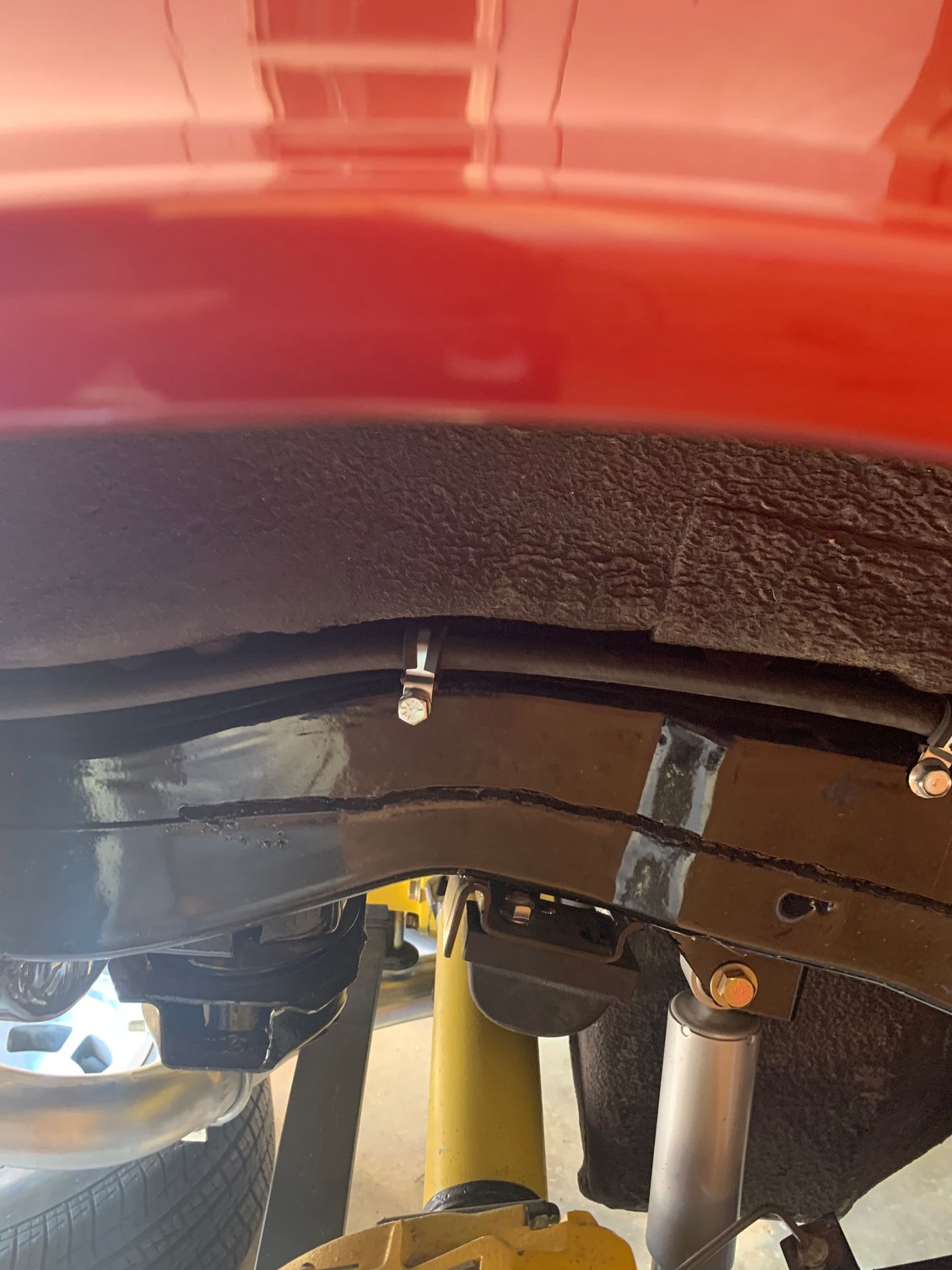

Pressure and return lines follow a common route.
Pressure and return line nicely tucked out of harms way. I might install a stone deflector.
