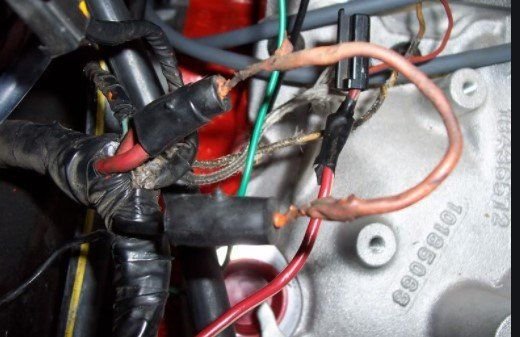

Your fusible link is down by the starter, it looks like this:
Find the starter solenoid on page 1 of the schematic and follow the red wire down to the 'fusible link'.
Let's see if you have power coming into the light switch.
Hi Peterbuilt - You're one of the forum members who I know knows electrical, but I THINK if that fusible link was blown, then he wouldn't have any power to the rest of the car? And I THINK (and I might be wrong) that once you get past that fusible link, there are no other fuses/links, etc for the headlights other than the breaker in the switch? If I'm wrong, let me know (it wouldn't be the first time....or the second...or the...)
I do agree that he needs to verify power to the switch. I forget if the dash lights have a separate power feed than the headlights, but I think they might? I'll spend a few minutes in the morning going over the schematic.

Yes! if the fusible link by the starter is good then your need to check the one at the horn relay
See 'Horn Relay' on page 2.
Before you do that check the new high beam switch at each terminal to see if it failed and sent power to ground.

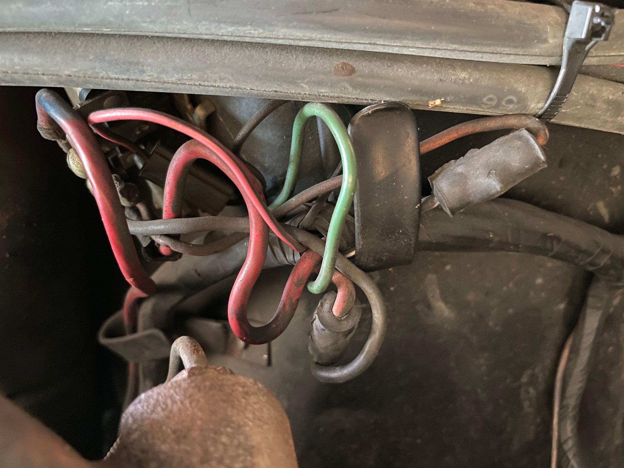

Pic of my harness connector:
Pic of the only wires I could find on the drivers side fender:

OK, the connector actually looks pretty good. I did some more research, and I think there ARE two voltage sources coming into the headlight switch (I thought that was the case, but initially couldn't find it in the diagram). So now we need to verify your fusible links. The hardest one to get to (by the starter), should be OK, because if that burns out, the whole car is basically dead. This leaves two that are in the area that you took a picture of. Below is a picture of my horn relay. Both of the screw terminals (labeled A & B) should have 11-13 volts (battery voltage) on them at all times (even with key off) - at least my 69 does. If you're not seeing battery voltage on those two terminals, then let us know. You can use either the master cylinder or the alternator case for a ground point.
Terminal B is where the two fusible links attach to - one should be orange and one is black). You'll have to follow those to where they enter the wire harness and expose a couple of inches of the wire. I THINK it's the black fusible link that supplies the headlight power, so check that first. Once you have a couple of inches of wire exposed, I usually use a safety pin to poke thru the wire insulation and then use the meter to see if there is voltage on that side of the fusible link. The fusible link 'ends' at the round rubber looking thing.

Okay, new pic, this is oriented correctly, so top screw is above bottom screw as it sits in my car. Both screws get 12.3V with key on, nothing with key off.
Top screw goes to a thin black and dirty red wire that have a rubber boot about 5 inches out from the screw. Bottom screw goes to a thick red wire that I don't see a boot on.
When you say expose wire from the harness, do you just mean any wire past the boot on the side away from the screw?
Old Mar 9, 2021 | 05:43 PM

Yes, follow the black wire (fusible link) from the screw terminal to the rubber boot, then insert a pin in that wire anyplace after the boot. The key needing to be on to get voltage here might be something that changed after 69, but this also means that your headlights won't come on unless the key is 'on', which doesn't sound right either (even our 79 allows the headlights to be turned on without the key).
Basically, the fusible link functions like a wire when it is 'good', so if there is voltage on the screw terminal, there should also be voltage after the rubber boot also (unless the link 'burned open' inside of the insulation).
