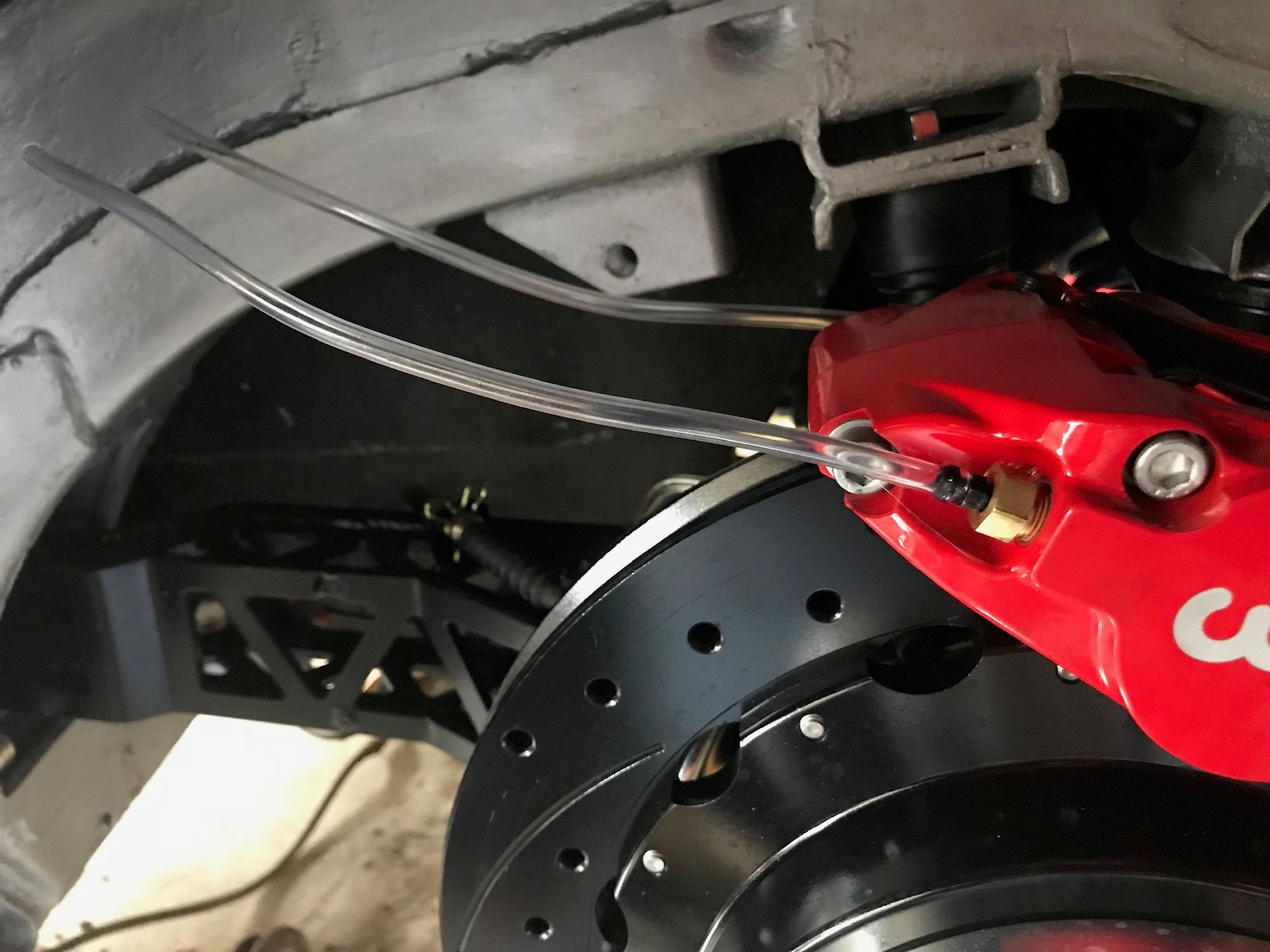

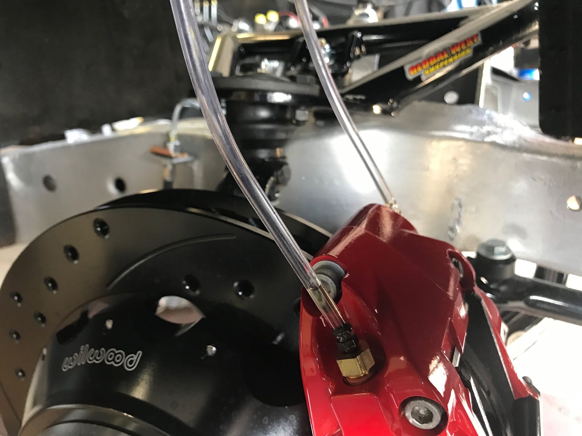

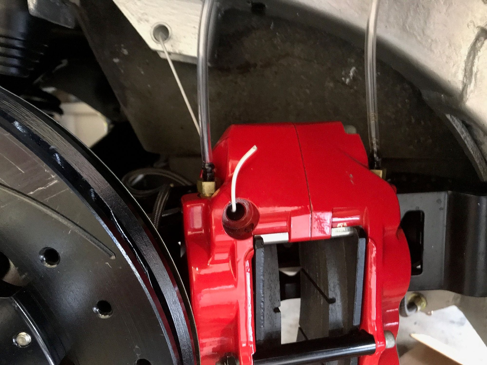

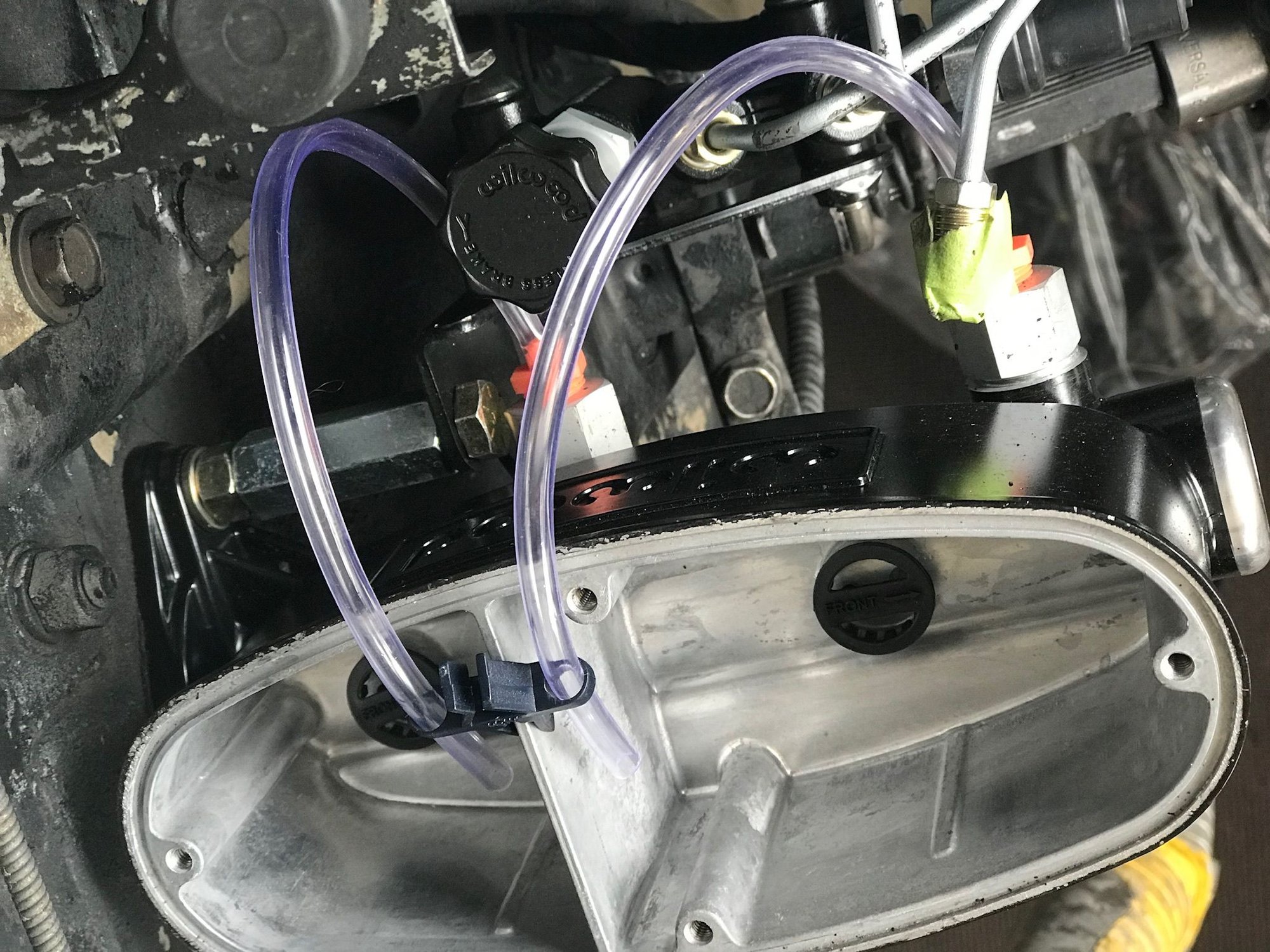

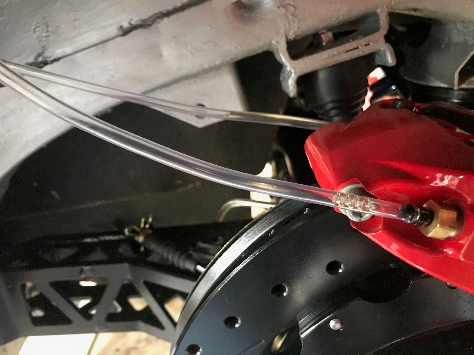

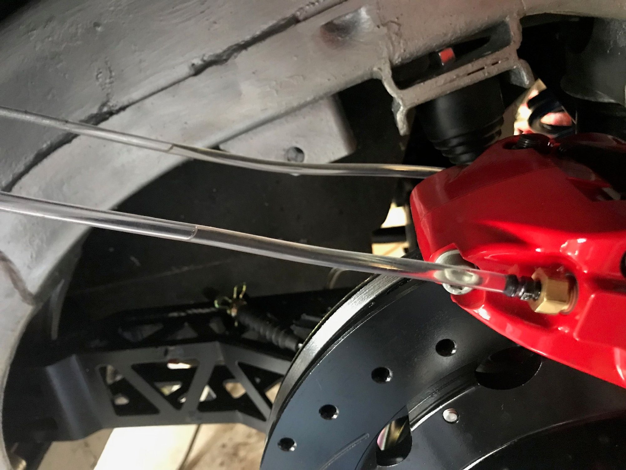

This is my C2, but the concept is the same. Keep these lines submerged in brake fluid and pump the pedal until no more bubbles appear. Being on the car, it is almost impossible to overextend the piston.
Gravity bleeding is just crack the bleeders and watch the bubbles.
Crack the bleeder, drink a beer and let gravity do the work.
Contrary to popular belief, it doesn’t matter where you start.
What does matter on dual bleeder calipers is to bleed the inner one first, then the outer.
For these Wilwood calipers, the rears needed to be hung vertically and given a few taps with the handle of a screw driver to get the last few bubbles out.
