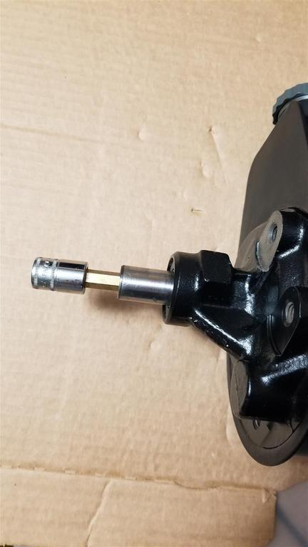

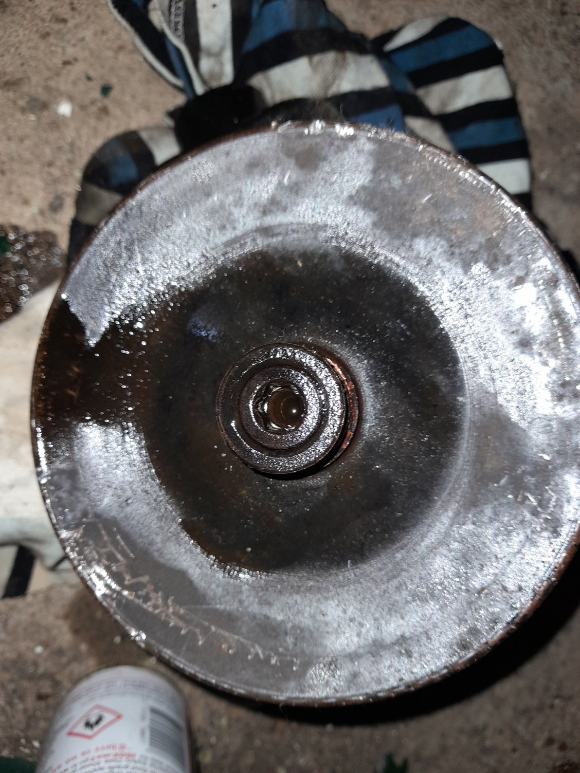

been about 25 years or so since I last changed out my power steering pump. I need to get the pulley off to put on the new pump. Bolt won't budge.
This "Little Darling ". I've tryed my 1/2 inch impact , heat , long breaker bar with heat. currently soaking in penetrating oil. Any idea's Guy's. getting another pulley here in Australia could take weeks.

yes, and retained by this bolt. bolt needs to be removed, then pulley removed with a puller. Unless you know something I don't.

You talking about what fits a 9mm Allen head?
It's just part of the shaft. You need the correct puller and installer to get that pulley off/on.

Allen head yes, metric anything absolutely not . not part of the shaft on the new pump to be certain. hole with threads absolutely certain. allen head more like 3/8ths. I do NOT own a Japanese Corvette.

Son, this is a original pump off my 1977 Corvette rebuilt.
You have internal threads because you need them for the tools required to R&R the pulley.

tryed tons of heat. nothing moves. one can only get it so hot. once glowing red, any hotter will melt the pulley

I watched the video posted by bmotojoe and it was ok, but the one right after it showed the pulley being removed from the pump. The pulley was removed using a puller. What you believe to be a bolt is the shaft for the pump.

There is no bolt.
The pulley is removed/installed the same as a harmonic balancer, only difference being the type of puller.

You need to buy the $27 power steering pulley puller kit - you cannot remove the pulley without the correct tools. Get the right tools and it comes right off. The puller kit also includes the special installation tool, that you MUST use to install the pulley.
No - you don't use heat.
