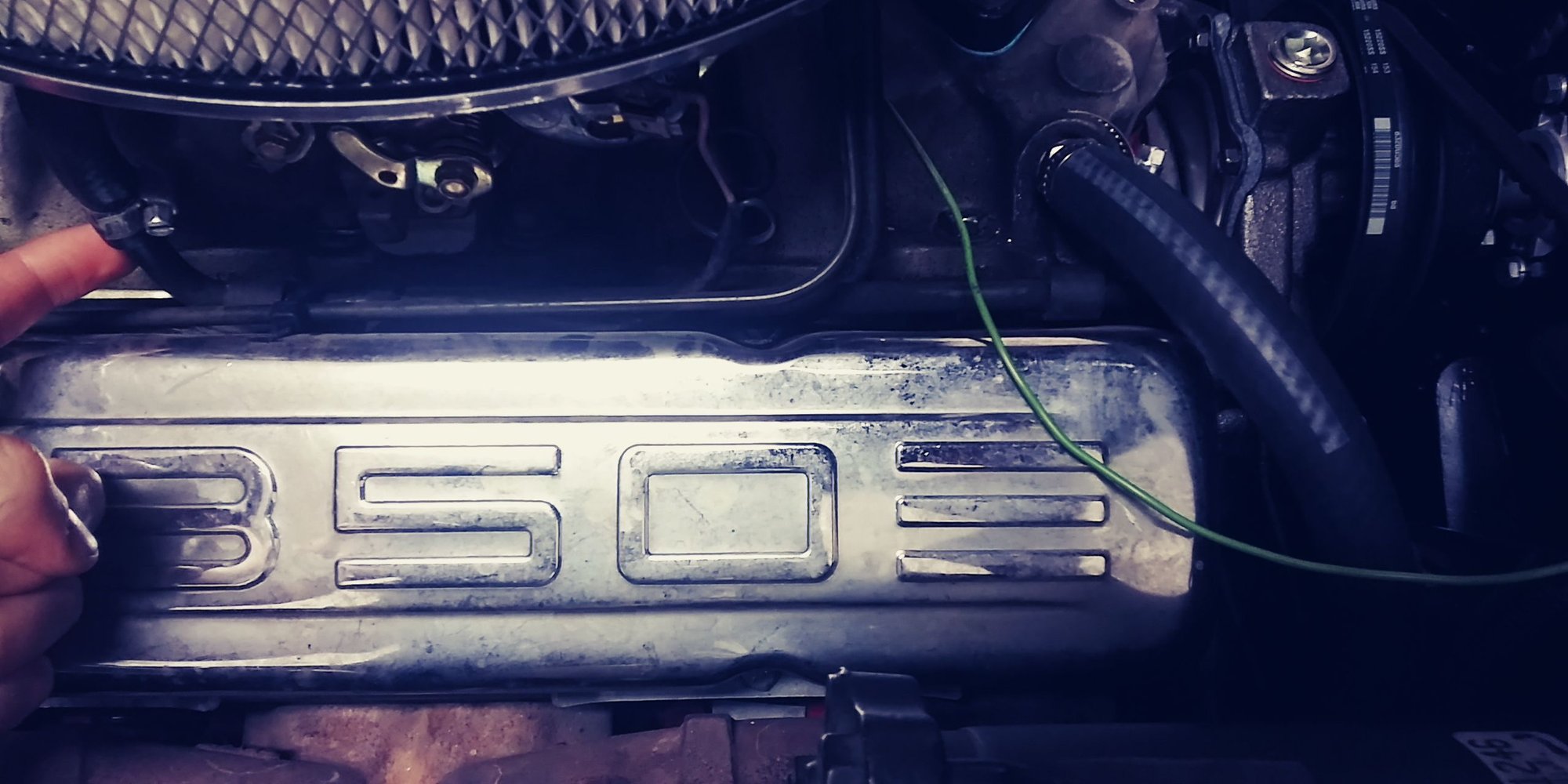

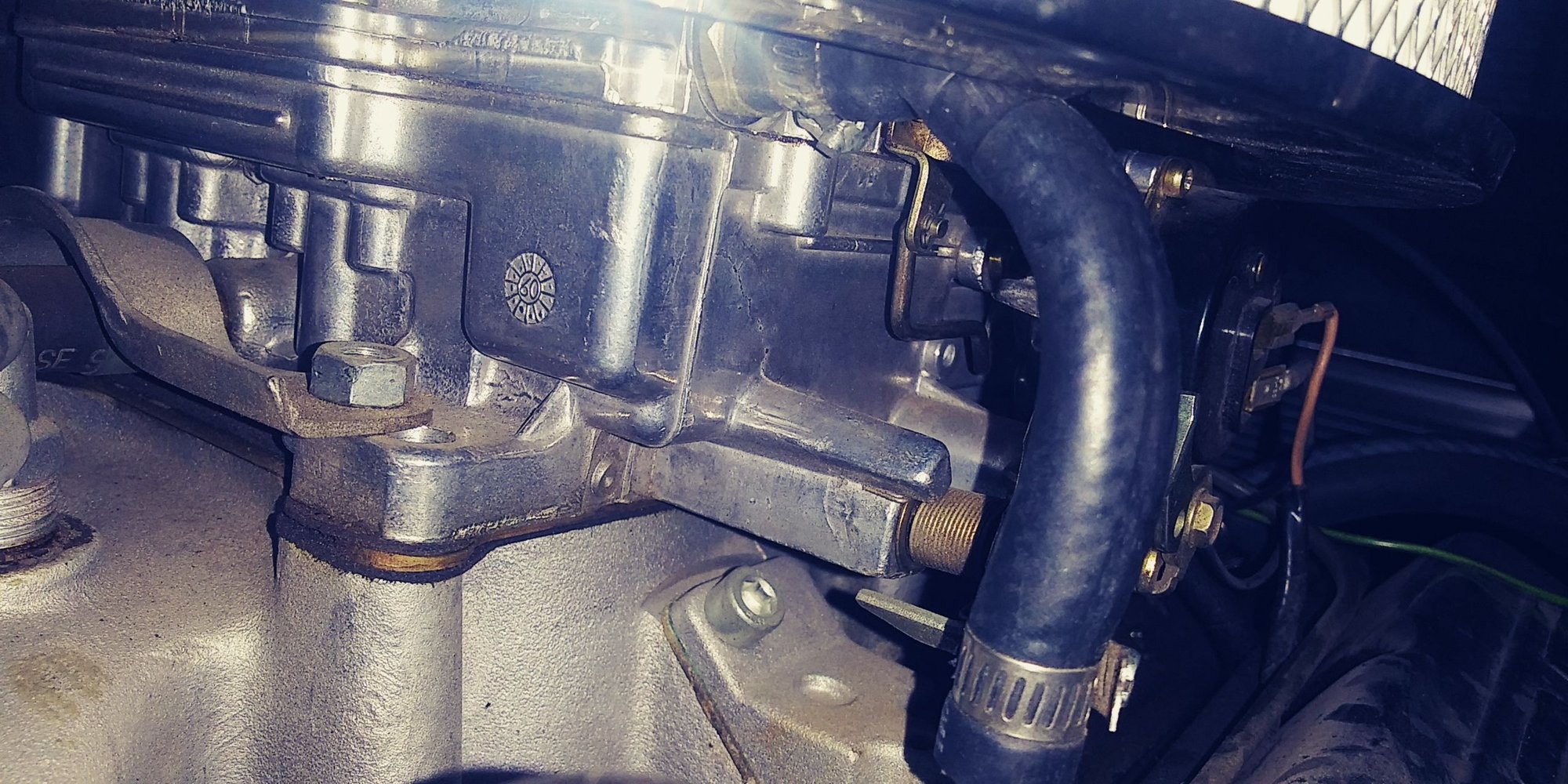

I've got the L48 in my 74 convertible that many hands have touched and "repaired" before me so I'm having to deal with a lot of non-stock parts and bubba work. The previous owner threw away the Quadrajet and replaced it with an Edelbrock intake and 1406 carburetor. In doing so, obviously the routing of the steel fuel line from the pump to the carb is different and there is no fuel filter between the two. Also, the fuel pump appears to not be factory correct as the inlet and outlets face the front of the car and not towards the passenger side. I easily replaced these two 3/8" and 5/16" rubber hoses with local auto parts store fuel line without having to use the correct S molded hoses since there was plenty of room to make a long 180 degree loop. The previous owner had installed a 20 micron fuel filter before the mechanical pump and called it good. It shouldn't have been on the suction side from what I've read and did not really fit well so I removed it and now I'm looking at options of how to properly get a fuel filter between the pump and carb. Below are some photos of my current setup. I do not have a pipe bender or flaring tool but am willing to learn if necessary. Any thoughts or suggestions would be great.
P.S. I will be replacing those tinny looking valve covers in the future.
Passenger side of the car showing how the steel fuel line connects to the pump and is routed up the front of the engine. Note the 3/8" rubber line next to the lower radiator hose is the fuel supply to the pump from the metal lines running along the frame.
After coming up past the intake, the fuel line runs against the valve cover and makes a 90 degree bend up towards the Edelbrock fuel supply fitting.
Final connection to the carb.

Fuel filters have commonly been plumbed between the pump and carb, on that vertical run you show in your picture. Your line is a little close to the engine, so it will have to be a small diameter filter, and you may have to tweak the lower bends to get some clearance. Earls (sold by Holley) makes a good filter that is about an inch in diameter that may work for you. I am using it in the same location, but I bent the metal line to move the line forward, provided some better room between filter and engine.
