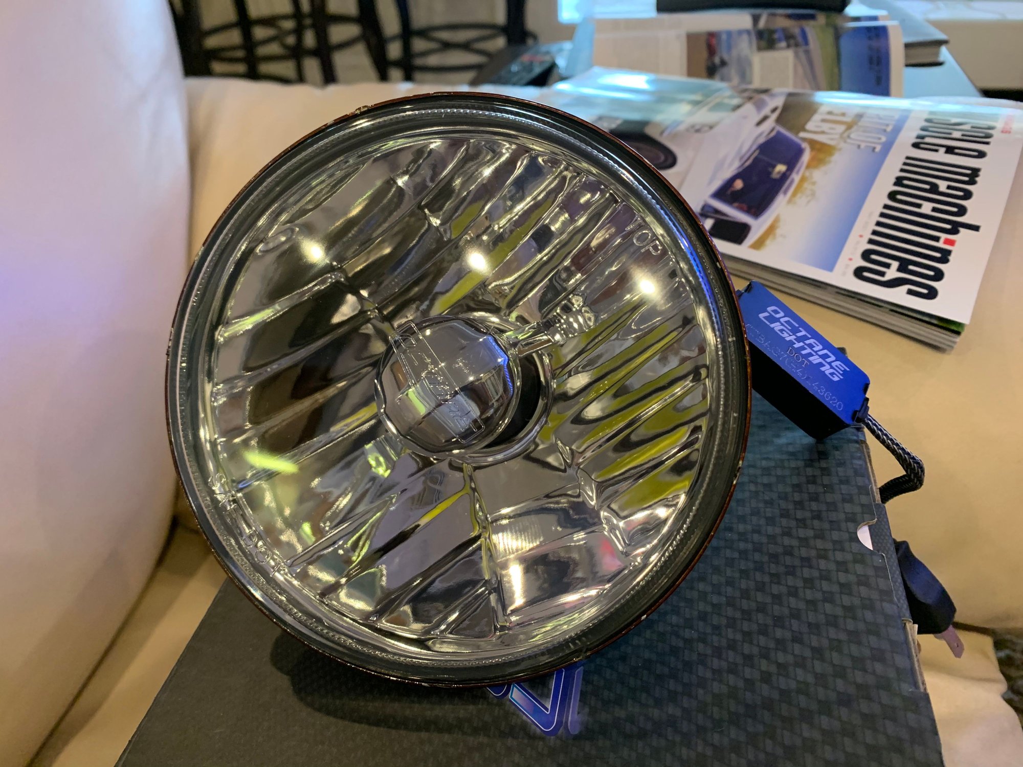

Big shout out to Scott, 69_Shark, for telling me about these wonderful lights. They are LED with glass lens and metal backs. No childish halo rings or weird looking bulbs. Just bright as hell replacements for my old *** sealed beams. And they bolt right in. My C3 lighting now rivals my C6 lighting!
Octane Lighting 5-3/4 Crystal Clear Metal Glass Headlight Led 4000Lm H4 Light Bulb Headlamp Set
Amazon.com: Octane Lighting 5-3/4 Crystal Clear Metal Glass Headlight Led 4000Lm H4 Light Bulb Headlamp Set: Automotive Amazon.com: Octane Lighting 5-3/4 Crystal Clear Metal Glass Headlight Led 4000Lm H4 Light Bulb Headlamp Set: Automotive
New lights on right!

I was not happy with the low beam brightness. It was brighter than the sealed beam halogens, but not as spectacular as the high beams. So I did some investigating. The outside, low beam, lights have four led’s. But only two come on in the low beam mode. All four leds come on when hi-beam is selected. So, I disconnected the high beam wires to the low beam lights, and bridged the low beam and high beam socket prongs. So now all four leds light up when the lights are switched on. My low beam lights are doubled in brightness. Aimed at the same spot down the road, but much brighter.

The low beam lights (Outer) are now in high beam mode at all times. The high beam lights (inner) only come on in high beam mode. The high beam lights have four leds also. So, in high beam mode, there are 16 leds on, in low beam mode, 8 leds. I drove the car to SLC6 at 0600 this morning. I am even happier now. What's next?
