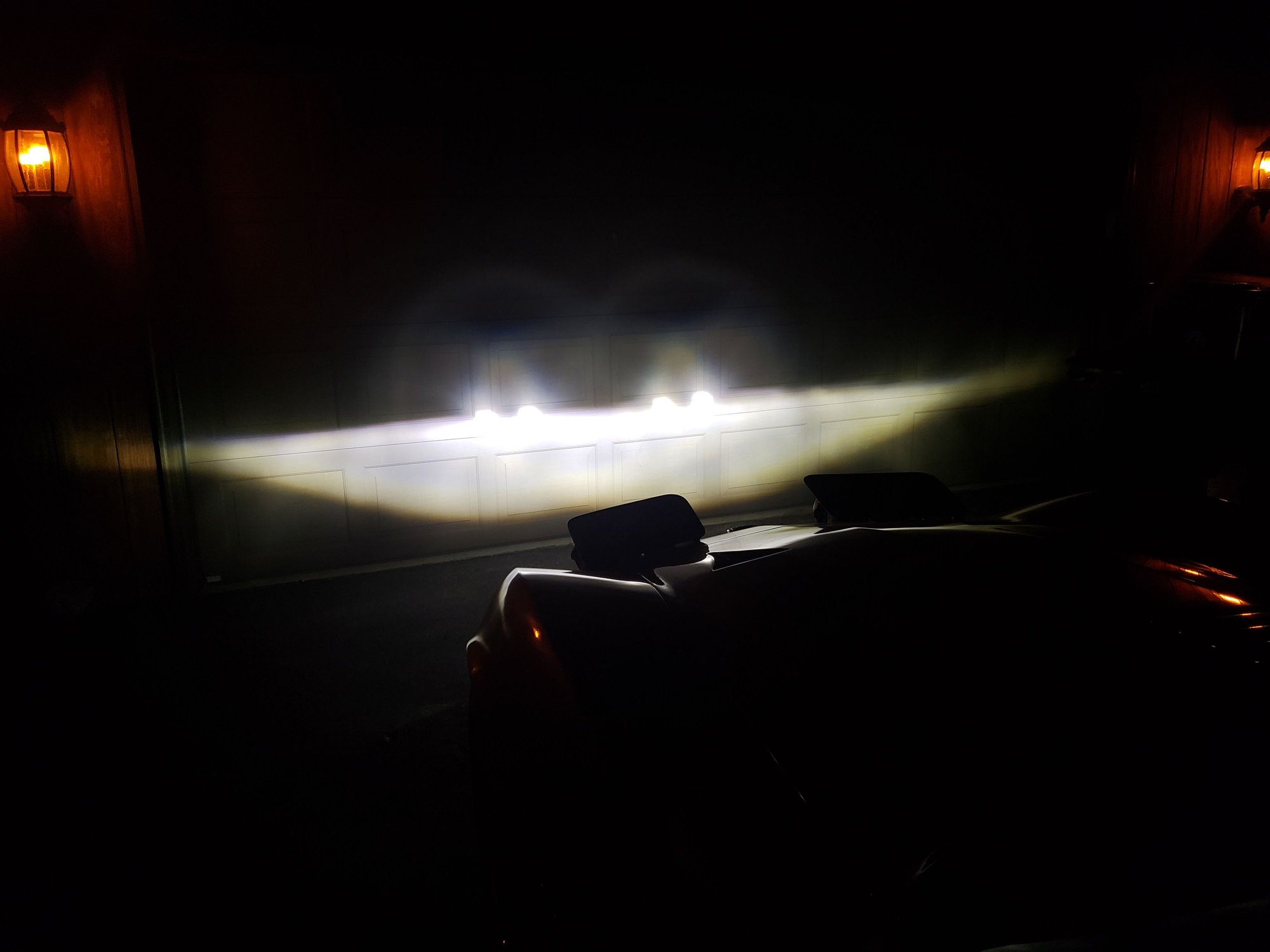

heres the cutoff of the cheap ebay led lights im using.. they are legal and DOT approved too it looks like all 4 are lit but this is just the low beams here..

Its very possible they cant be adjusted. Thats why some want pics. to see the beam pattern which will tell the story of whether they make suitable street low beams

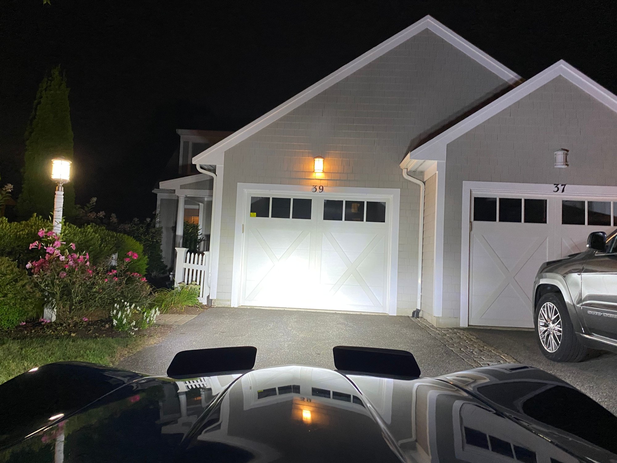

Low Beams
Hi Beams
Low Beams reflecting off the garage door (driveway is slightly elevated from street)
Hi Beams reflecting off the garage door (driveway is slightly elevated from street))
I used the same LED's and am very pleased with the result. Truly plug & play (no cutting cups or wires). The fans are quiet and so far the current draw has put no stress on my 53 year-old 1968 'original wires and circuits' Vette. The road test was great on low beams and I could easily read road signs with great visibility. Hi beams was a dramatic improvement from the lo beams. I no longer dread driving at night as was the case with the original sealed beam units.

Those output shots are not great. No real defined off, no width and lots of scatter. High beams look like a flood light basically which you can see lots of light illuminating the top of the house/garage which is wasted lumens and blinding (you won't have great distance but more flood). I'm not impressed... and I would bet $20 that those reflector lenses would perform better with a good halogen bulb or possibly a low 35w HID kit.
