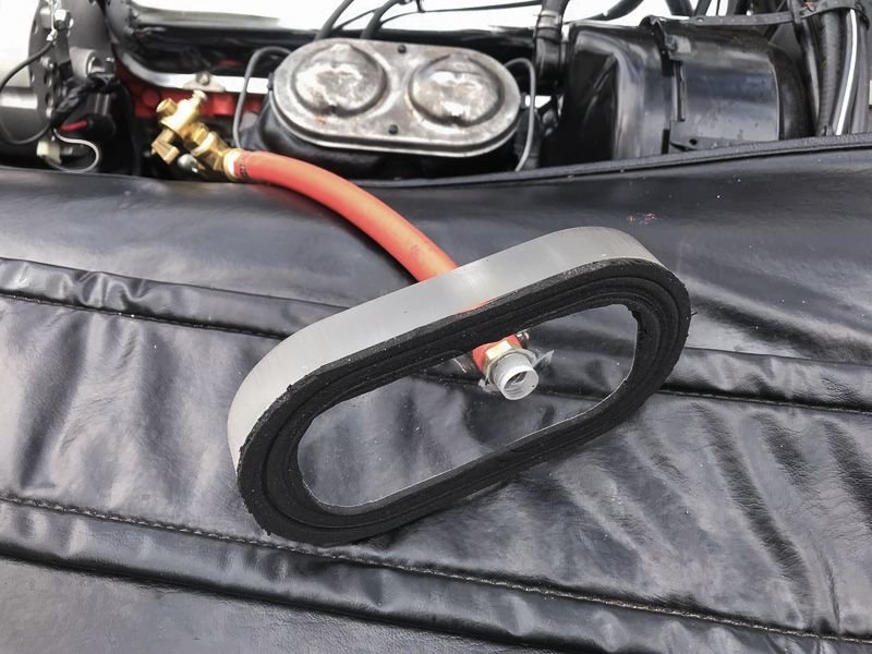

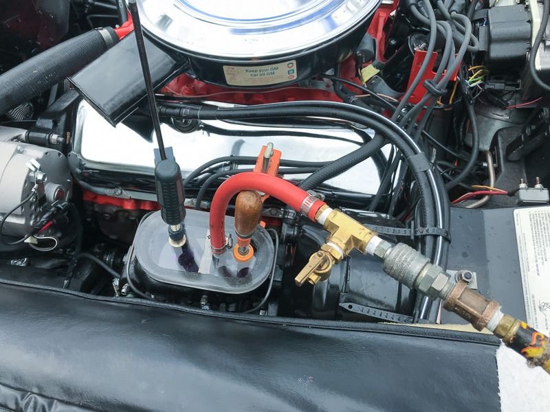

Taking all of these comments into consideration and not really wanting to spend $$ on a Motive just to use it as a pressure tank, I elected to make my own MC pressure plate and use my shop compressor, using cagotzmann's setup as a model. With HeadsU.P.'s observation about frequently checking fluid and ignatz's glass test tube reply, I remembered I have a bunch of 1" acrylic and polycarbonate scraps I picked up while dumpster diving a few years ago. Taadah, a see-through pressure plate! Traced the stock MC cap perimeter, cut it out on a bandsaw, sanded the edges, drilled, tapped, and JB Welded for a barb fitting, and stuck 1/8" neoprene on the MC mating surface. I also had a 1/4 turn bleed valve in my parts stash so included that in the air hose line to relieve the pressure slowly when removing the plate.
I started with bleeding the MC on the car; though instead of raising the rear I unbolted the MC from the booster, pulled it off the studs and pushrod, and positioned it with the rear slightly higher than the front. I then used the plate and a rotary vane vacuum pump to pull a vacuum on the MC for about 5 seconds to see if any air bubbles came up -- a few small ones did. Then I connected the compressor air line which was dialed way back to only send ~15 lbs to the plate. Everything worked very well and I came to the observation that jacking the car, removing and replacing the wheel at each corner, and lowering the car again took longer than the actual bleeding process.
