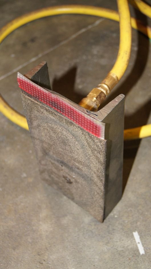

or make one like this. Use your air compressor.

That would work cagotzmann. But it would be a constant battle to keep checking / adding to the fluid level.
If the MC goes dry, you are screwed.

I've been thinking about that too. Floats in glass test tubes would do the trick I think. I don't need this ..... yet

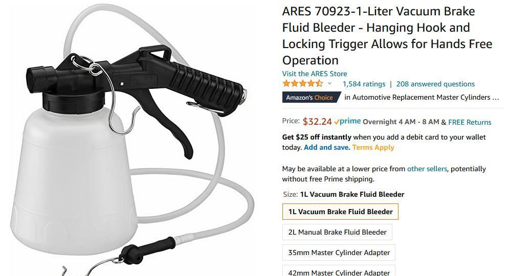

I bleed and flush mine using this (you do need an air compressor):

No battle with fluid, I have a 6ft clear plastic tube connected to the bleeder screws and can bleed 4-5 complete runs down the tube.
The first bleed is easy, open the bleeder until fluid reaches the end of the tube, close bleeder, remove tube to let air into the tube and reconnected, open bleeder push fluid unit the air reaches the end of the tube again.
If you wanted to do the math you could calculate the volume of fluid in the length of the tube vs the fluid capacity of the MC.
During initial testing I found with my setup, rear brakes are about 3-4 full bleeds of a 6 ft clear tubing, and front brakes are about 5-6 full bleeds.
after you hit the limit, add fluid. I set the air pressure to 20-25 PSI and does a great job removing air in commonly trapped area's.
If the MC goes dry no big problem do this. When I installed the MC I did bench bleed, but this doesn't get all the air. This has never failed to get the last bit of air from the MC.
