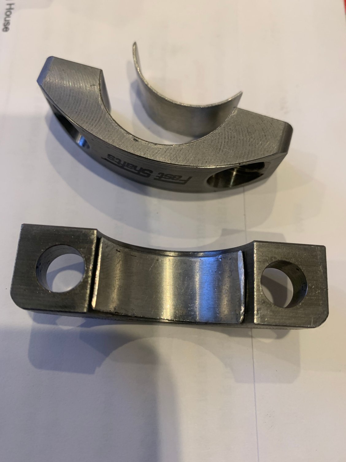

Originally Posted by BOOT77
I just looked up that strap kit part number to see if it was steel or alum like some I've seen and it says you got the 1310 kit BBSK-10, BBSK-FS is the 1330 kit. Now I've seen that some have 1310/1330 straps on dennydriveshaft or other places BUT I'm no expert like https://www.dennysdriveshaft.com/p83...30_series.html
It just bugs me that they have a kit for each size and now I wanna know the diff(no pun intended LOL)
I just found out what the diff is. BBSK-10 has a 1.415" distance bolt to bolt. Too small for the Corvette rear end yoke. BBSK-FS has a 1.576" distance bolt to bolt, which I hope will fit. I just ordered the correct (I hope part). I hope Summit is quick again.

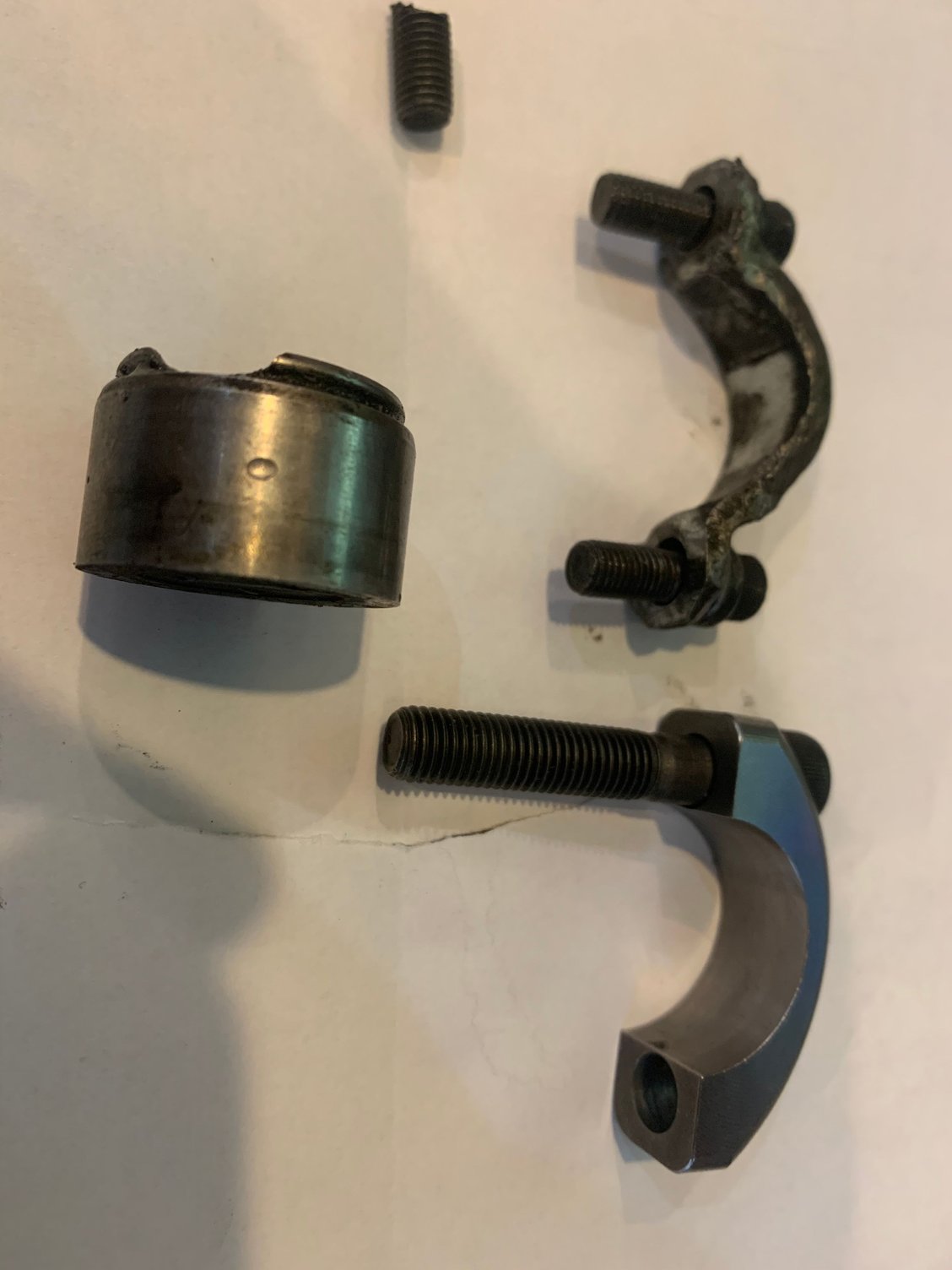

Disassembly and autopsy completed. Looks like one of the strap bolts failed. GM expected these tiny bolts to hold 200hp? I expected it to hold 500hp! And I get a huge torque spike at wot 1-2 shifts according to my dyno. My 2500 rpm stall torque converter and sticky 315 tires was too much. Hopefully this billet strap and thicker bolts can do the job. I have to drill and tap the yokes up in the car.
1/4" 12 point correct? That is why I moved on to the manual parts. They use 5/16" 12 points instead of the 1/4" 12 point bolts. I also tracked down 170,000 tensile strength, 5/16" 12 point bolts to replace the stock ones which were too short after I went to the billet caps Dave made me.

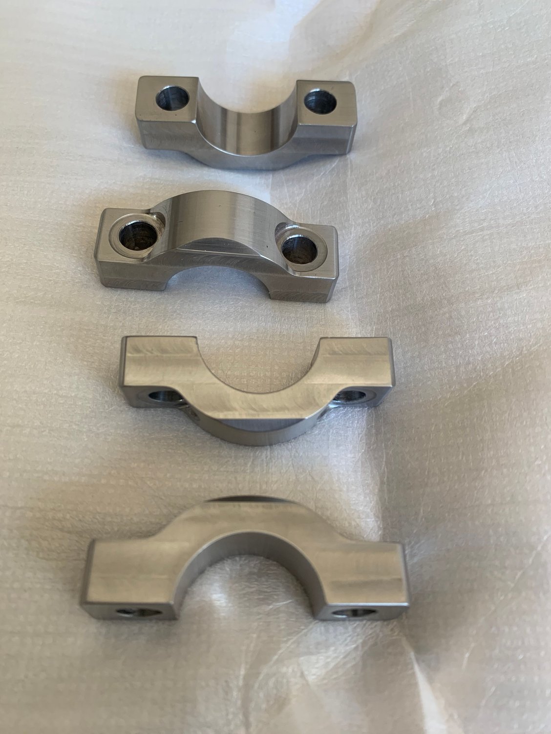

Just got a set of billet caps from stroker Vette! Damn they are pretty. I’m going home for Mother’s Day, so I’ll wait a couple of weeks to install. I’ll modify my gas tank while I’m in there.

WOW...some machinist time went into those rascals!
They are! I know there was no way I could paint mine black so they are just clear coated. LOLOL. He does do nice work!

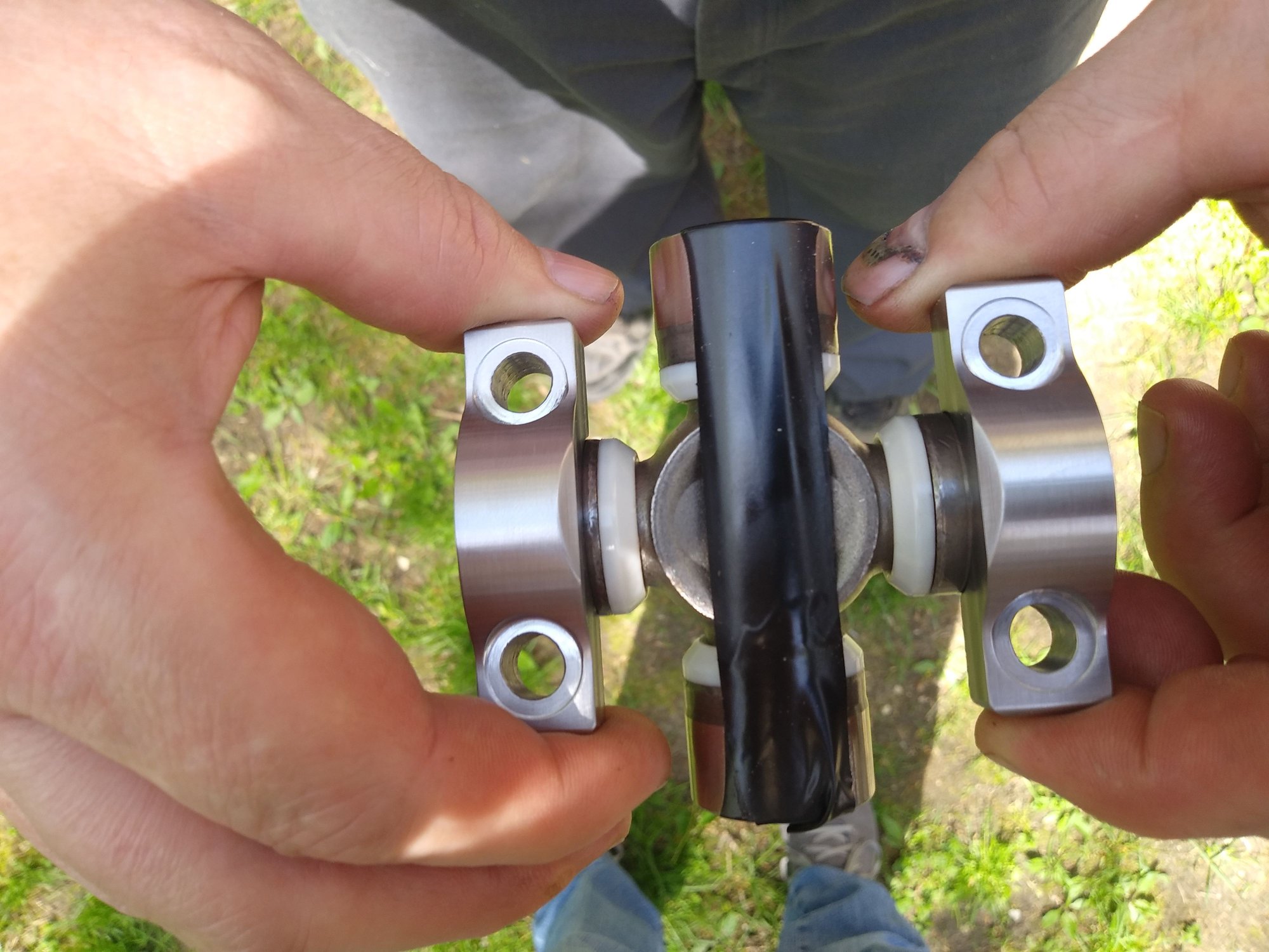

Bee Jay,
I f you want to clear them I would skip the id due to the exact fit. I use something like amsoil metal protector for the id corrosion resistance after the clear dries. Attached is picture of your caps on new spicer u-joint.
To I broke another u joint!
