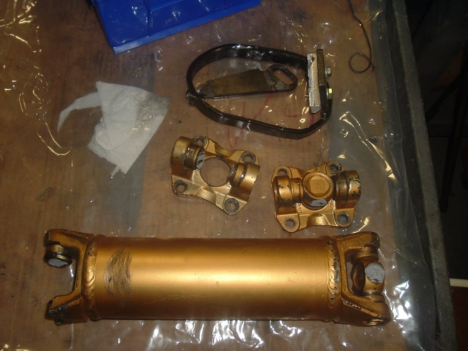

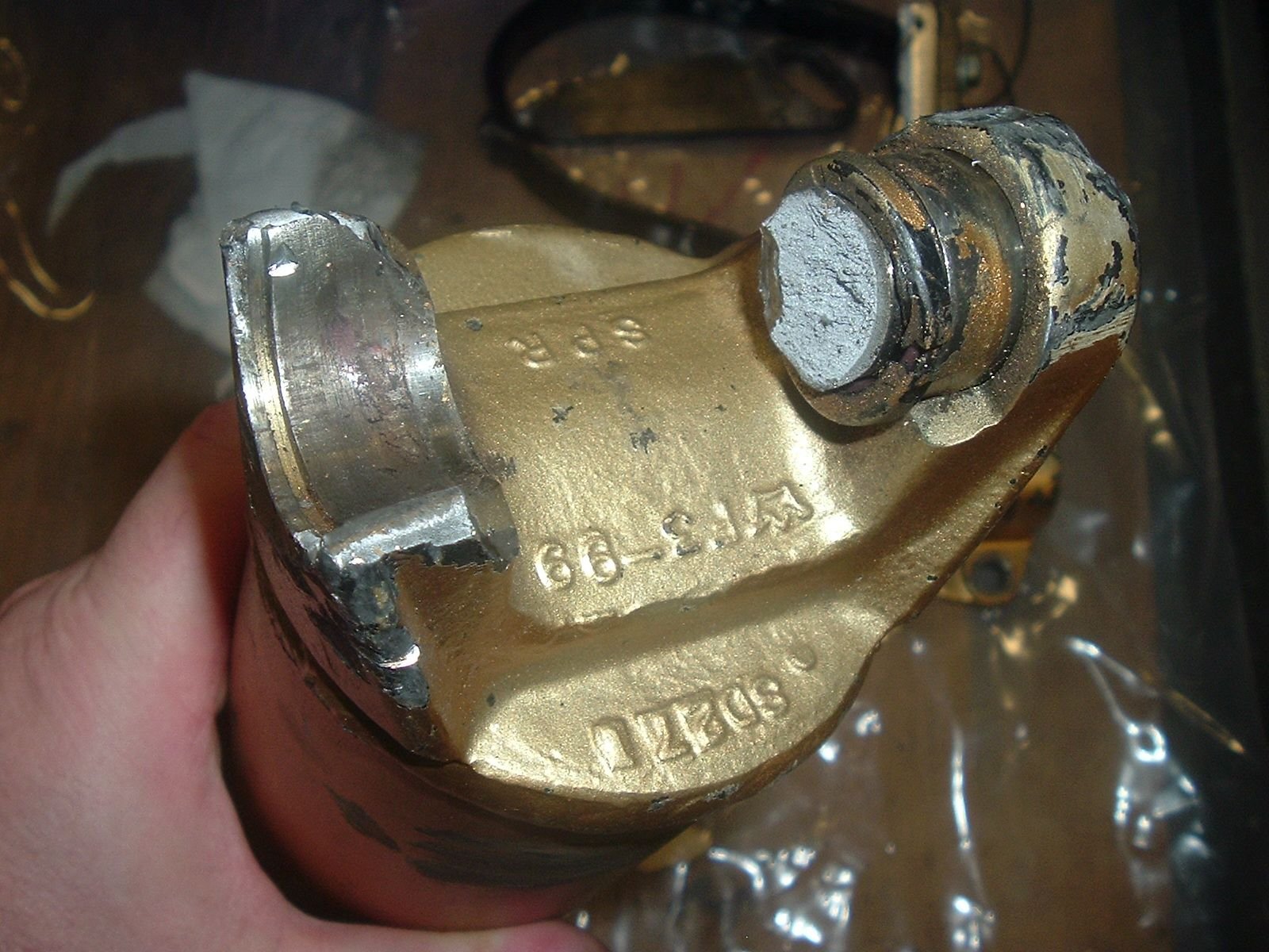

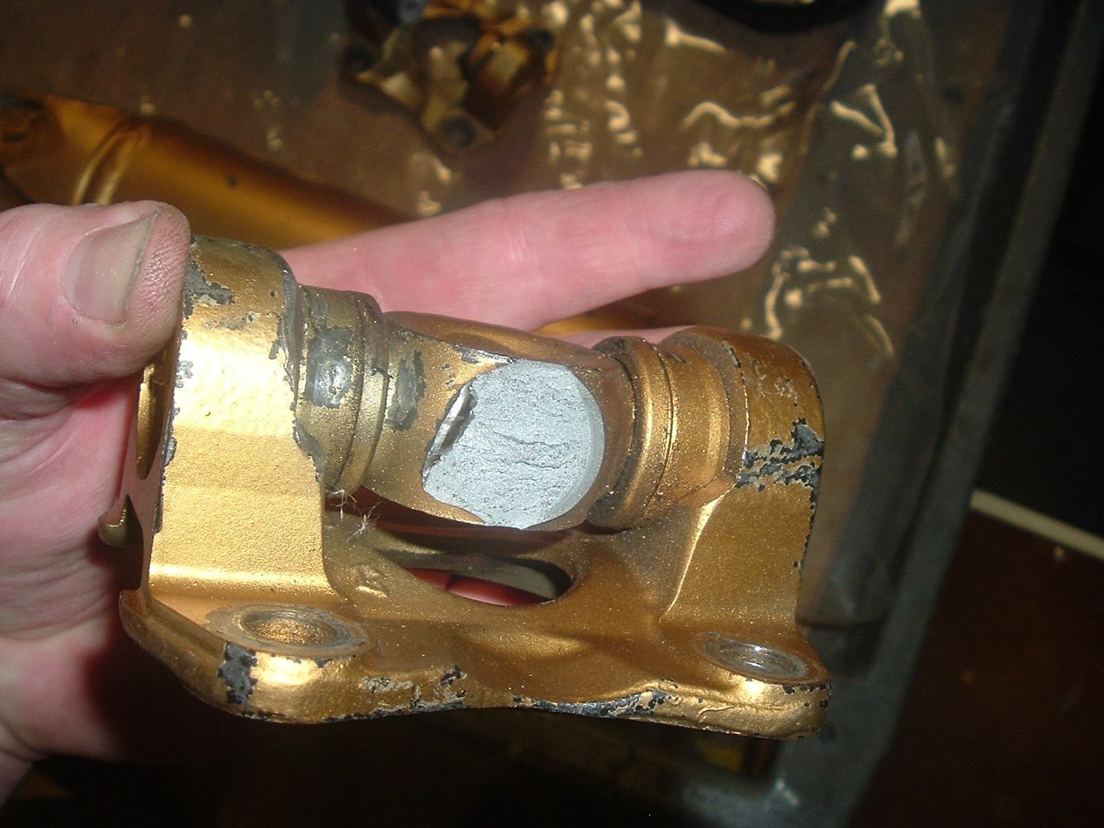

You broke the inner LH 1/2 joint. What do you have for a diff- an iron or Aluminum Dana? I don't know what L82 axles are, there were "HD" stock axles with caps but if they are 79's they are soft faced. Sometimes the load moves inward and the axle may push the axle bearings inward before the joint shears. It takes some force but u-joints don't just snap. If you wanted to, you can buy solid spicers and cryo them. If you wanted to and have an iron diff you can mod them for 1480 axles- that would be expensive since you would have to rebuild the posi too.
Does it look like this, we took out both inner and outer solid spicer 1350 with a 500hp dead hook and 4-5k manual shift launch

Daaaamn, that’s way nastier than mine. I have an aluminum Dana from an automatic 80-82, with my stock 79 axles, so I need 1330/1350 conversion u joints. Where can I get them solid. I also need 1330 straps or caps.
