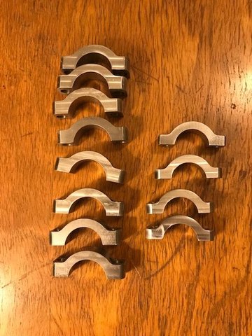

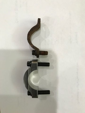

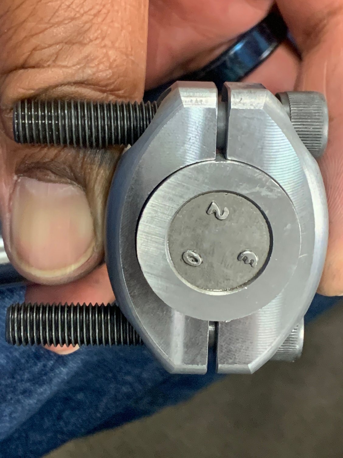

The spline count is 29 on the dana 44 for 80-82 corvettes. The dana can hold your power output with a steel cap.
Here are a few pictures of the dana stub axle and u-joint caps.

Those are bootyful! Where do I get those in 1330 size?

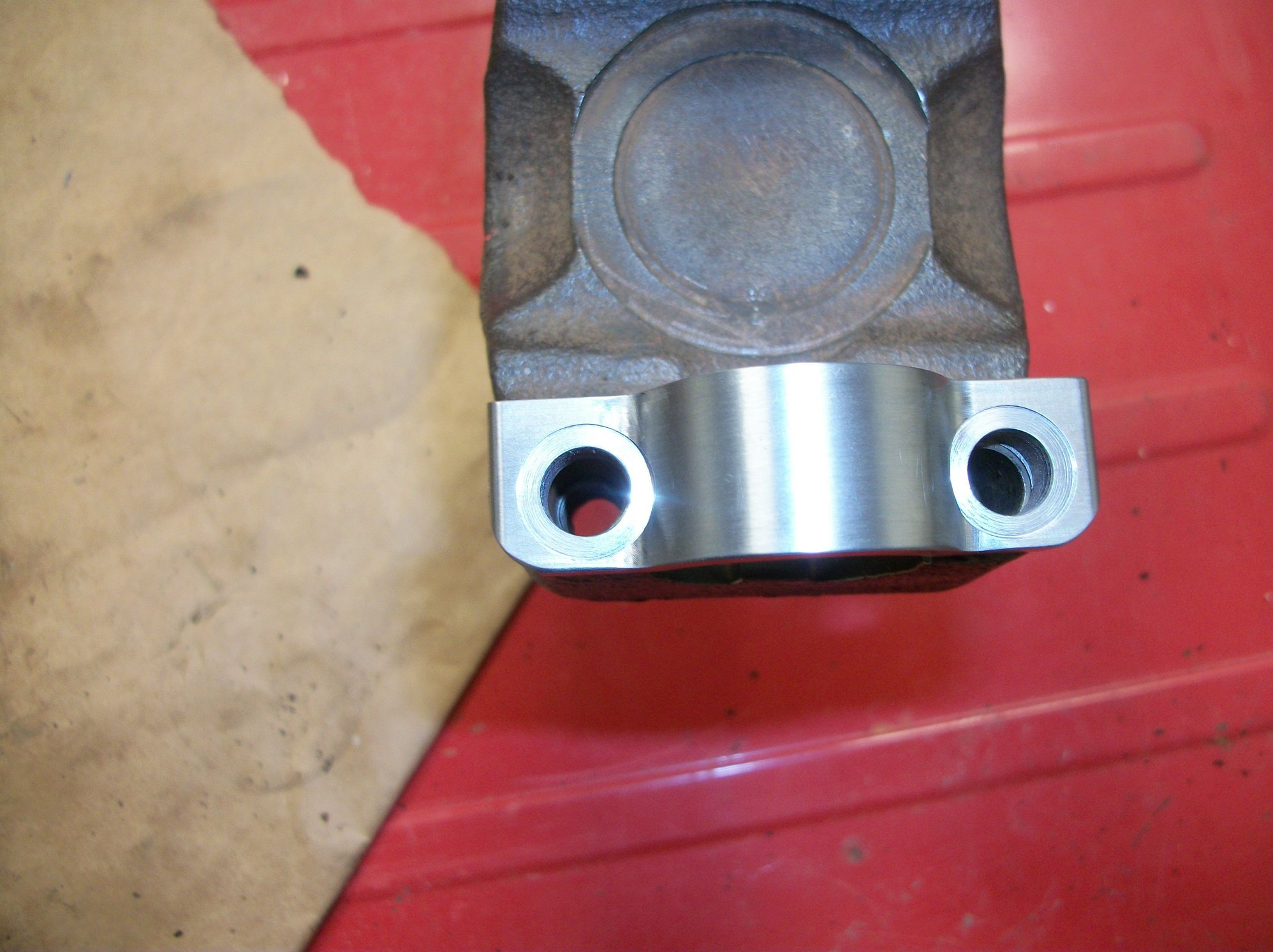

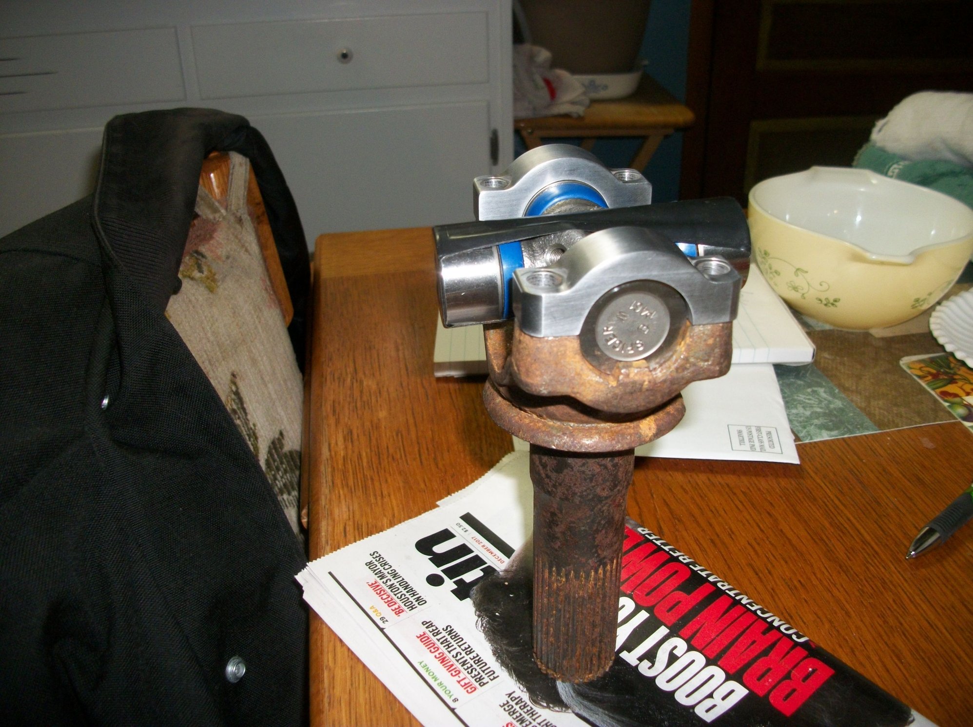

Here is picture of 1330 cap on my slip yoke.

Hot damn Stroker, stop teasing me. I need two. How do I get a pair?

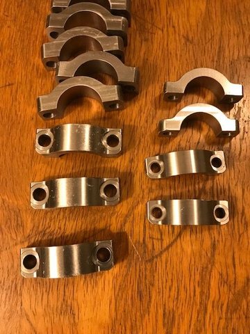

These should look familiar to Dave. LOL My full set of caps for the 81 Dana 44. He does beautiful work.
Those do look nice!

Originally Posted by BOOT77
Those do look nice!
Dave did a beautiful job on them. Fit perfect!

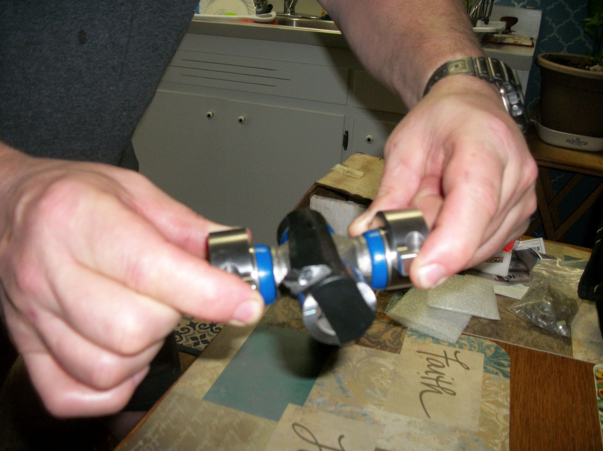

Summit Racing is awesome! I ordered on Friday, and these parts showed up Saturday. I could not find solid 1330/1350 conversion u joints, but Moog said that their greaseable u joints were just as strong. Check out the 1330 straps! Maybe this will solve my ujoint problem, then on to the next weakest link. Thank goodness it’s not my 700r4 anymore. I used to break that regularly, but after I splurged on a good hi performance tranny and torque converter, it’s been 10 Autocross seasons, and a year of this 427 LS , with no tranny issues. I hope this rear end holds up.
1330 strap fit.
1330 strap and 1330/1350 conversion u joint.
1330 vs 1350

Summit Racing is awesome! I ordered on Friday, and these parts showed up Saturday. I could not find solid 1330/1350 conversion u joints, but Moog said that their greaseable u joints were just as strong. Check out the 1330 straps! Maybe this will solve my ujoint problem, then on to the next weakest link. 1330 strap fit.
I just looked up that strap kit part number to see if it was steel or alum like some I've seen and it says you got the 1310 kit BBSK-10, BBSK-FS is the 1330 kit. Now I've seen that some have 1310/1330 straps on dennydriveshaft or other places BUT I'm no expert like https://www.dennysdriveshaft.com/p83...30_series.html
It just bugs me that they have a kit for each size and now I wanna know the diff(no pun intended LOL)
https://www.summitracing.com/search/...s?fr=part-type
Lastly who did you ask at moog, all tech has to be questioned these day and it's 9/10 times a low paid person who may know less than you. I think it's well documented that the zerk hole/threads is a weak/failure point.
