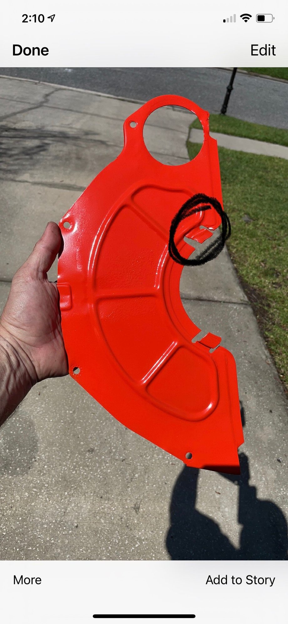

I am posting a picture but o e of the tabs to the inspection plate bent into the clutch area. I bent it back and paint it orange. But this was the culprit. I bent it when I was trying to wedge the old oil pan out.

nice when it is a piece of bent sheet metal instead of connecting fods...
