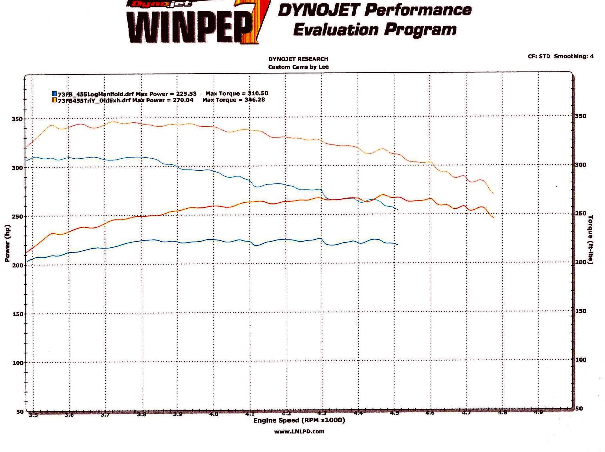

On a fairly mild Pontiac 455, I gained 45rwhp (peak compared to peak) by swapping from the factory log exhaust manifolds, to a set of Tri-Y headers. Same pipes & mufflers behind the collectors.
I then replaced the pipes & mufflers with a full 3" system. All the keyboard "experts" swore that I going TOO big and power was going to drop. I'm planning on going bigger on power down the road, so I figured "what the heck" and did it anyway. Power again increased, all across the board. At 4500rpm, the total gain was close to 75hp at the wheels. I can speculate that with a more radical motor, the gains would be substantially greater.
This is great! And unfortunate that the runs started relatively "high" in the powerband. Despite many internet warriors' opinions, long-tube headers will actually help pick up power in the low range over any manifold or shorty header setup.
Thanks! The relatively (to the rest of the powerband) "high" rpm start was due to the stock transmission downshifting when I tried to start any lower. I could have disconnected the kickdown cable, but didn't want to risk losing the tranny to lower line pressure (old tranny).

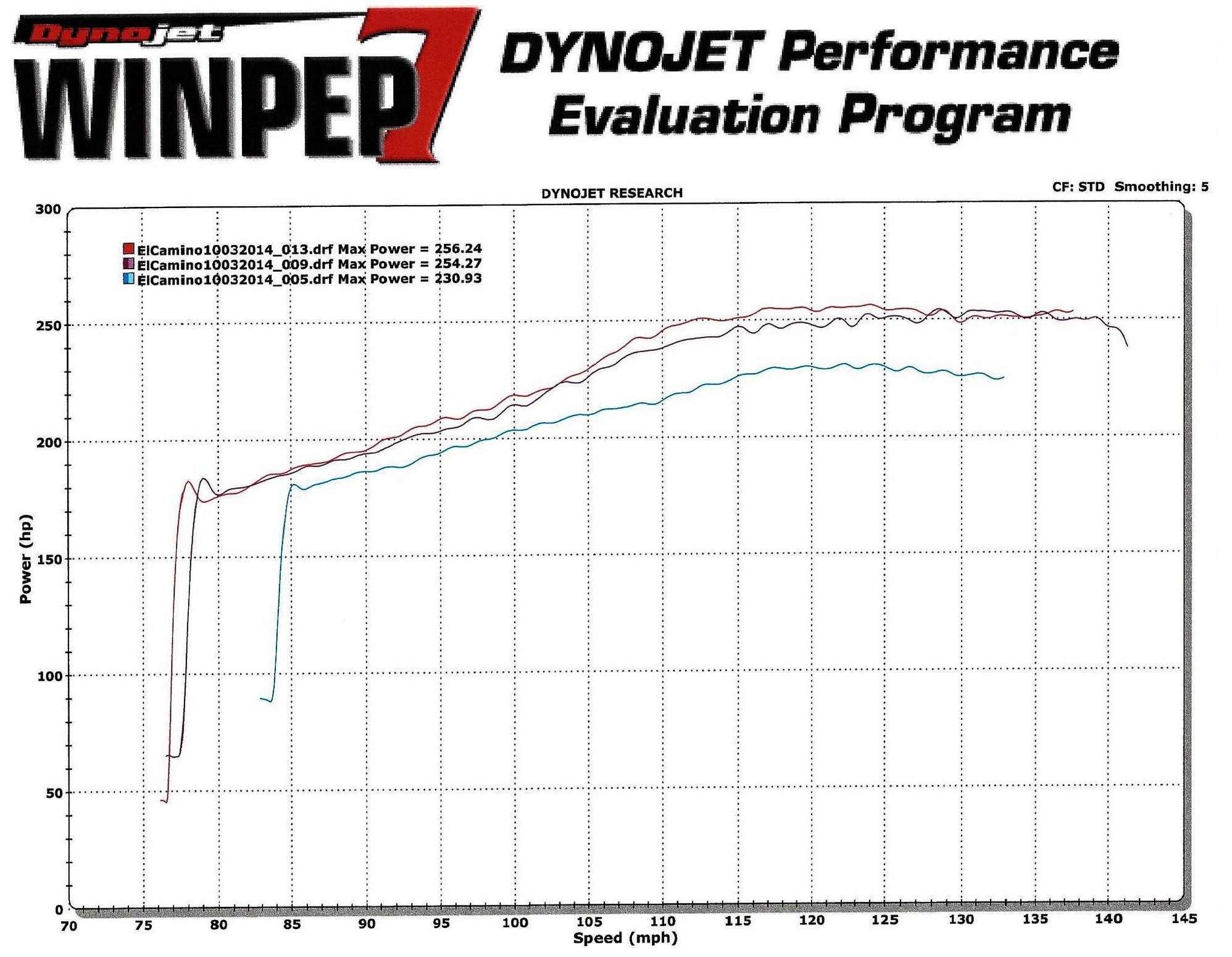

To keep this thread on topic, I'll share another dyno graph - this one from a '72 El Camino. When I got the Elky, it had a 1406 on a Performer EPS, a set of unknown brand headers, HEI, an old school single-pattern Comp 268Magnum, and a 2.25" dual exhaust. I installed a wideband O2 sensor, and the 1406 was pretty much off everywhere. Before any tuning, the motor was making a bit under 190hp at the wheels. After working with the carb and playing with the timing, I got it to 213rwhp.
I then added a FAST EZ 2.0 efi system. I first tried to get it to work with the HEI, but that was futile. It was a chinese HEI, and the tach signal so noisy (even with a filter) that the tach reading was all over the place, causing erratic performance. So, I added the FAST Dual Sync distributor, and it made an amazing difference. Back on the dyno, I was able to tune the AFR, the total timing, and the timing curve as well. Power jumped to 229rwhp.
Next, I found a set of the larger chamber Edelbrock E-street heads for $700 shipped, on eBay. Never used. A cylinder head porting buddy of mine gave them a look over - rehoned the guides, back-cut the intake valves, and installed better seals. I installed the heads with no other changes, other than head bolts and pushrods to correct the geometry. On the graph below, the bottom graph is with the stock heads (but with the cam, headers & efi mentioned above). The middle graph is with the EFI set the same as with the original heads, but with the E-streets in place. The top graph is after I played around with the timing settings. The E-streets wanted a bit less total timing, and REALLY liked the total timing coming in at an earlier RPM, which is the "bump" in power you see in the midrange. [note: the dyno's tach lead was bad at that time, so I could not get TQ or RPM readings] Also to note, ALL these dyno runs were done on cheap 87 octane.
