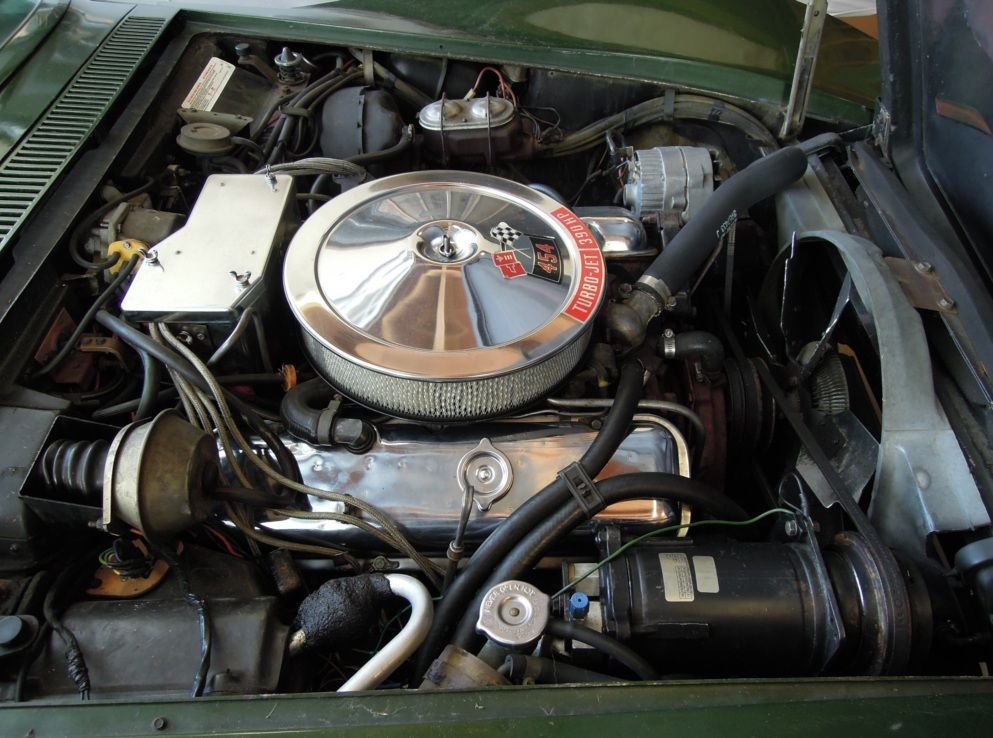

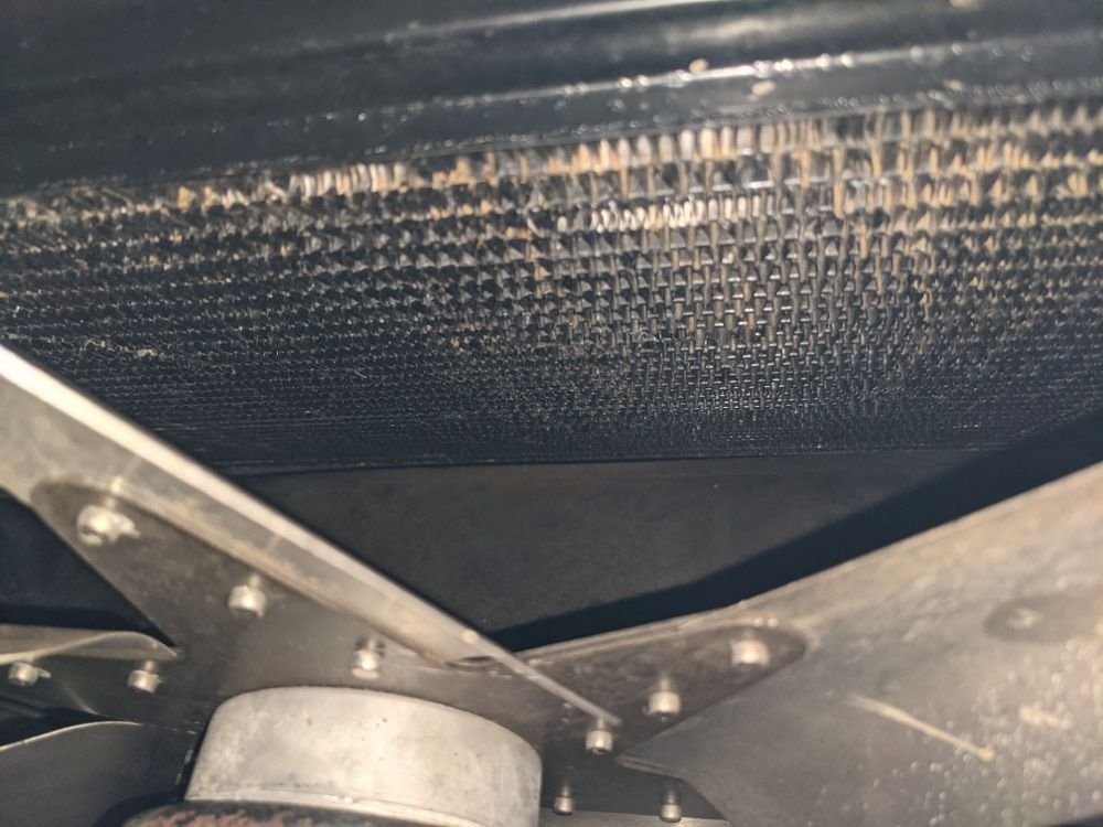

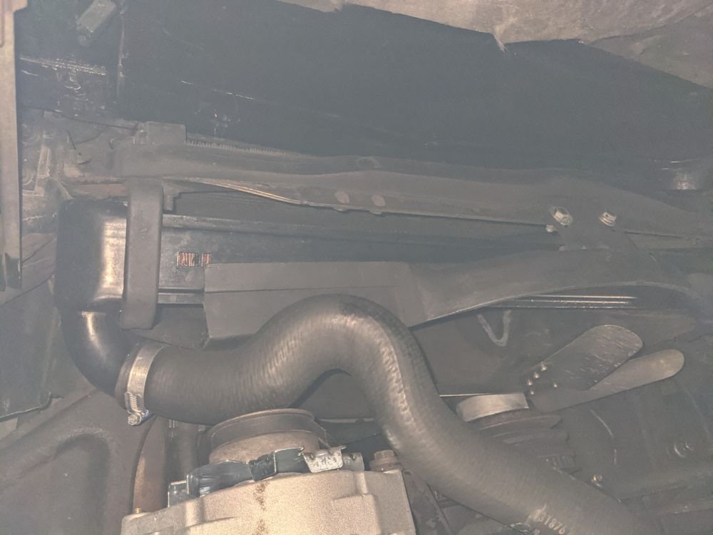

Thank you very much for all the very helpful suggestions!
I'll try to make sense of it all and get this sorted - in the meantime, I made some pictures, not sure what the shroud and seals should look like.
So if you see something that looks wrong below, I'd be happy to hear it.
Again thanks a bunch for all the helpful info. I'm joining some clubs here and I'm amazed how helpful the community (you guys here and also the locals) are!
As someone said, this is an almost 50 year old car, there will be trouble regularly, but that's fine. Part of the reason to buy it was to tinker, and it seems like on that account, there will be no shortage. :-)

thanks for the pics.
you should look for some stock original fans and housing pics for comparison. Someone replace your clutch fan with a flex fan, you want to to get rid of that, and it looks like they cut the shroud up presumably to get the fan in and out easier. ITs hard to tell with the lighting in the pics. The clutch fan would stick out further into that oopenning
The easiest way to remove the fan and the housing is to remove the hood and undo the radiator support bolts on the fenders and tile the hole thing toward the headlights....
So what is happening at low speeds is you fan is just sucking air from the side and throwing it at the motor, without a complete shroud it wont suck air through the radiator itself. So luckily some reasonable fixes to get you cool again

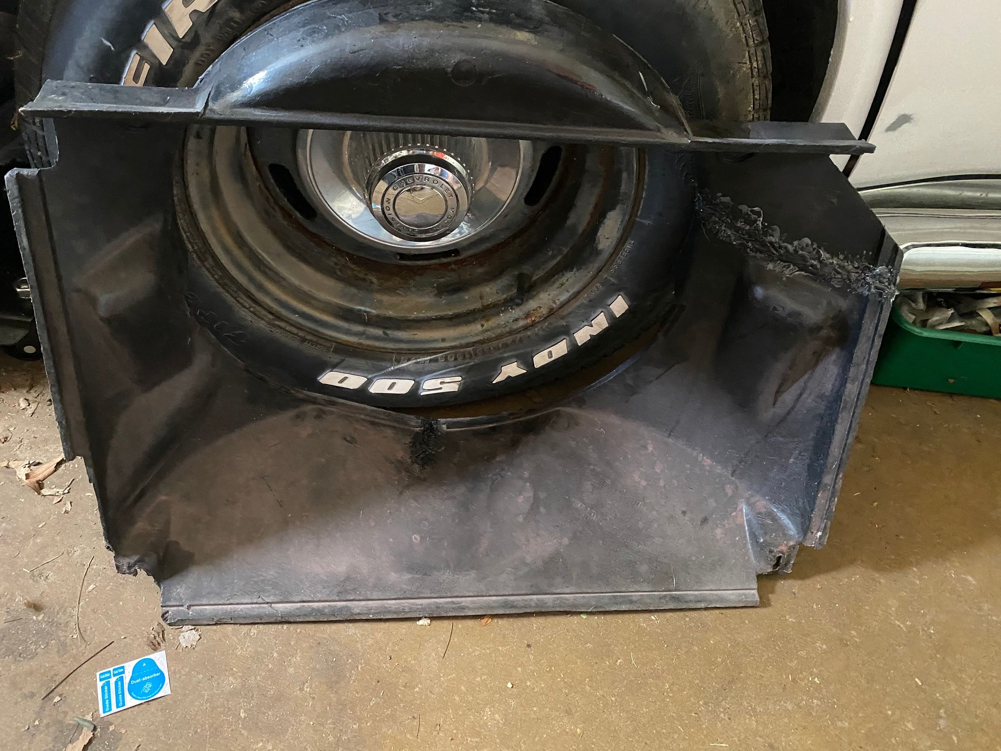

Old May 8, 2021 | 08:36 AM
Rescue Rogers's Avatar
Rescue Rogers
Is my vette stock?? HAHA
Joined: Oct 2015
Posts: 20,221
Likes: 9,359
2016 C3 of Year Finalist
similar to this
pic from the internet

Those pictures really tell the story. I would bet the family ranch your problem will be solved when you install the correct fan blade, fan clutch, and shroud.

Some one cut up and removed a good portion of your shroud and installed a solid mount flex fan.
It was a big deal back in the 70’s to remove the clutch from the fan, replace it with a solid mount and install a light weight aluminum or fiberglass flex fan.
I can’t tell from you photo, but is the front lower air dam (chin spoiler) still in place or has it been removed?
Replacing the fan and shroud would help a lot with the cooling.
If the front air dam is missing that will also add to your low speed cooling problems.
Make a plan, save your pennies and do it right.
If you are having to replace the shroud, fan and clutch, now may be the perfect time to upgrade to dual electric fans and new shroud set up.
Look at DeWitts Radiator website to see their package deals on radiator set ups and replace the factory radiator, fan, shroud with a new and improved system.
There are cheaper packages available that may work, but DeWitts is the best.

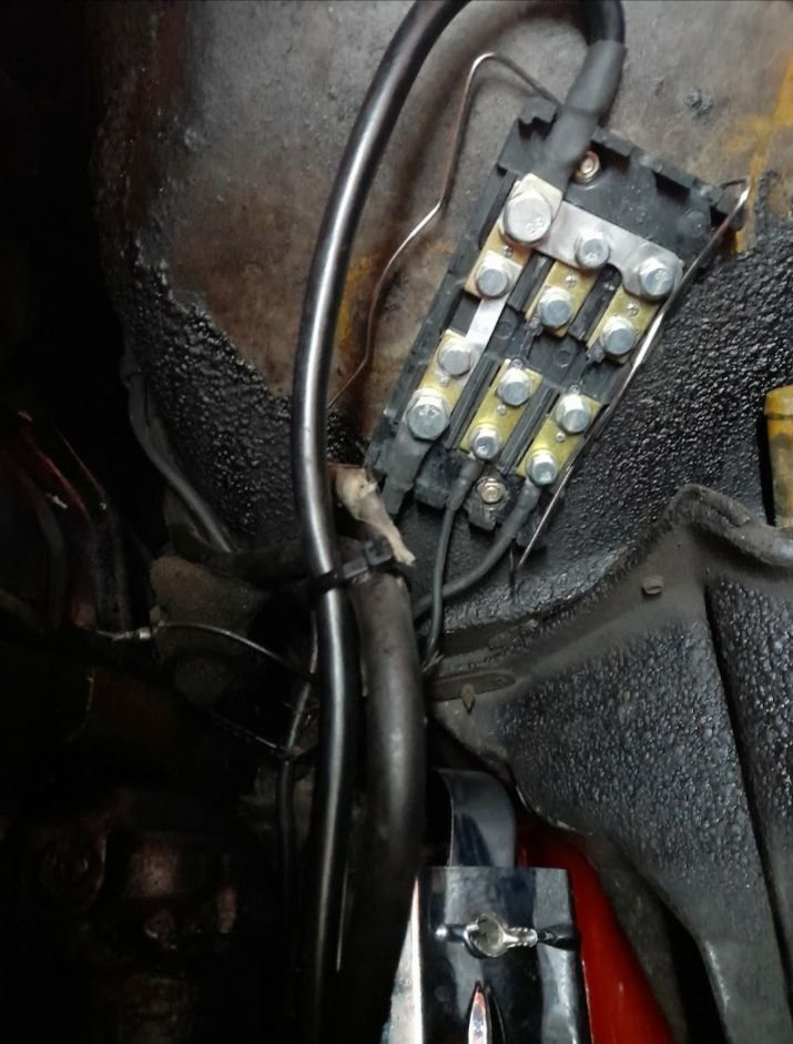

I'm running twin electric fans on my car. And yes it may very well be easier to install twin electric fans than to source the factory replacement parts.
But there is a bit to it. A larger capacity Alternator will be needed to keep up with the amperage demand, along with the upgraded wiring necessary to support the increase in current flow. And of course the proper wiring and switching for the fans.
Trust me I know. I put twin electric fans in my car 15 years ago. I think shortly before I joined this forum. I think I made every mistake in the beginning.
here's what I have now, extra panel mounted on engine side of right footwell.
The extra large looking cable is the positive Battery cable heading to the starter. the smaller heavy cable, (about the size of a Harley battery cable) is a cable from starter solenoid to strip fuse panel, cable is capable of handling over 250 amps and is only about a foot long. In panel, 100 amp strip fuse handling the charging, (Alternator, 140 amp S10 style). 60 amp strip fuse handling power to both fans run through a 60 amp relay temp controlled by my ECM. (yes I run aftermarket EFI). third fuse is power to my headlight relays. This type of electrical upgrading is necessary if you want it reliable. And remember, better to use wire that is way to heavy than to thin. grounds included.

i don't usually disagree openly with people on here, but most of his shroud is gone. great big opening behind and below radiator so virtually all fan air is pulled from below the radiator. a cheap crappy dangerous flex fan will pull air through a radiator at idle. the fan has to leave because it is a hazard and power hog at rpm's. but his lack of a shroud is where the most of the overheat issue is coming from.
Old May 9, 2021 | 10:55 AM
  #40
barkingrats's Avatar
barkingrats
1967 Pedal Car Champion
Joined: Mar 2020
Posts: 9,140
Likes: 4,248
From: US-PNW
The only part of the shroud that I see missing is the chunk from the right side around the circular fan opening. The long lower section between the radiator and frame crossmember looks intact to me. There is a 2"-3" wide bolt-in extension that runs along the bottom of the '72 shroud that appears missing if this one should have had it.
