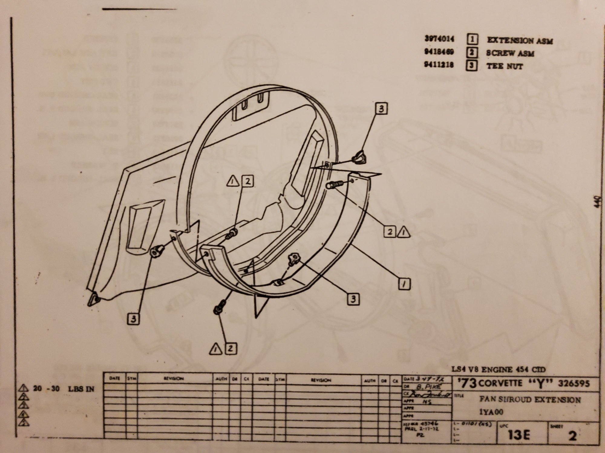

Originally Posted by mlauritsen
I'll try to make sense of it all and get this sorted - in the meantime, I made some pictures, not sure what the shroud and seals should look like.
So if you see something that looks wrong below, I'd be happy to hear it.
It's hard to tell from your picture. Do you have the shroud extension installed?
Fan Shroud Extension for 1973 with 454

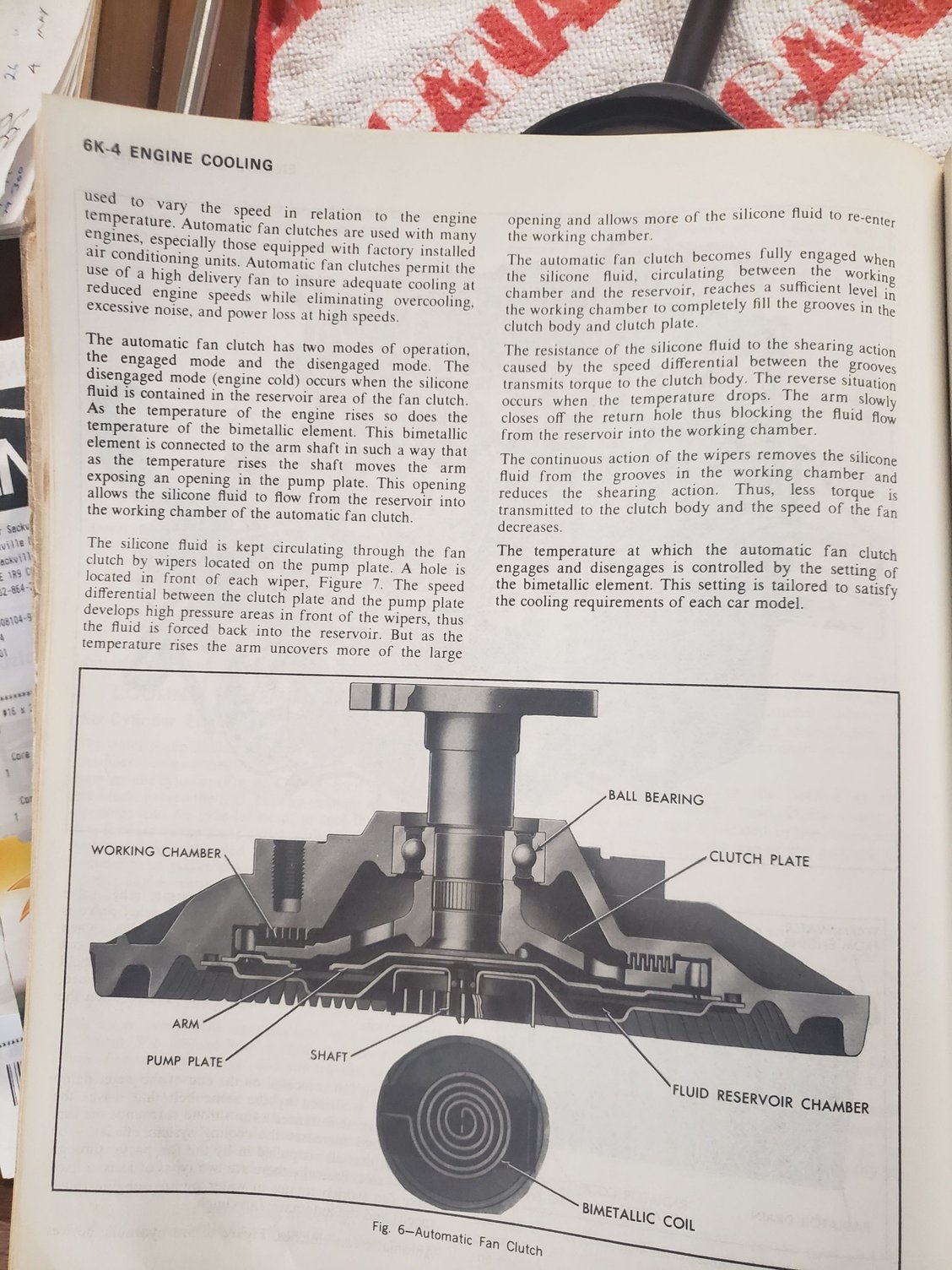

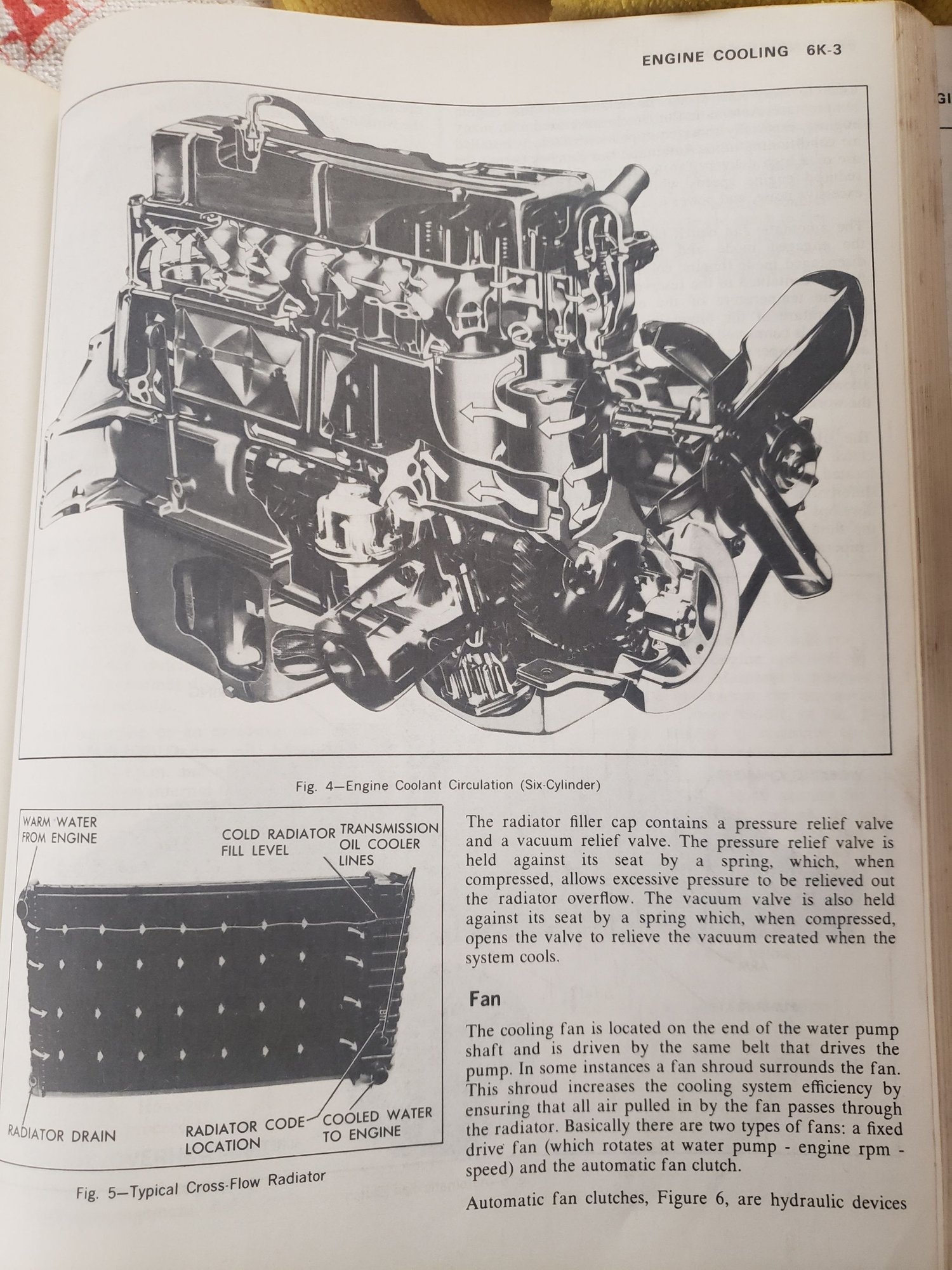

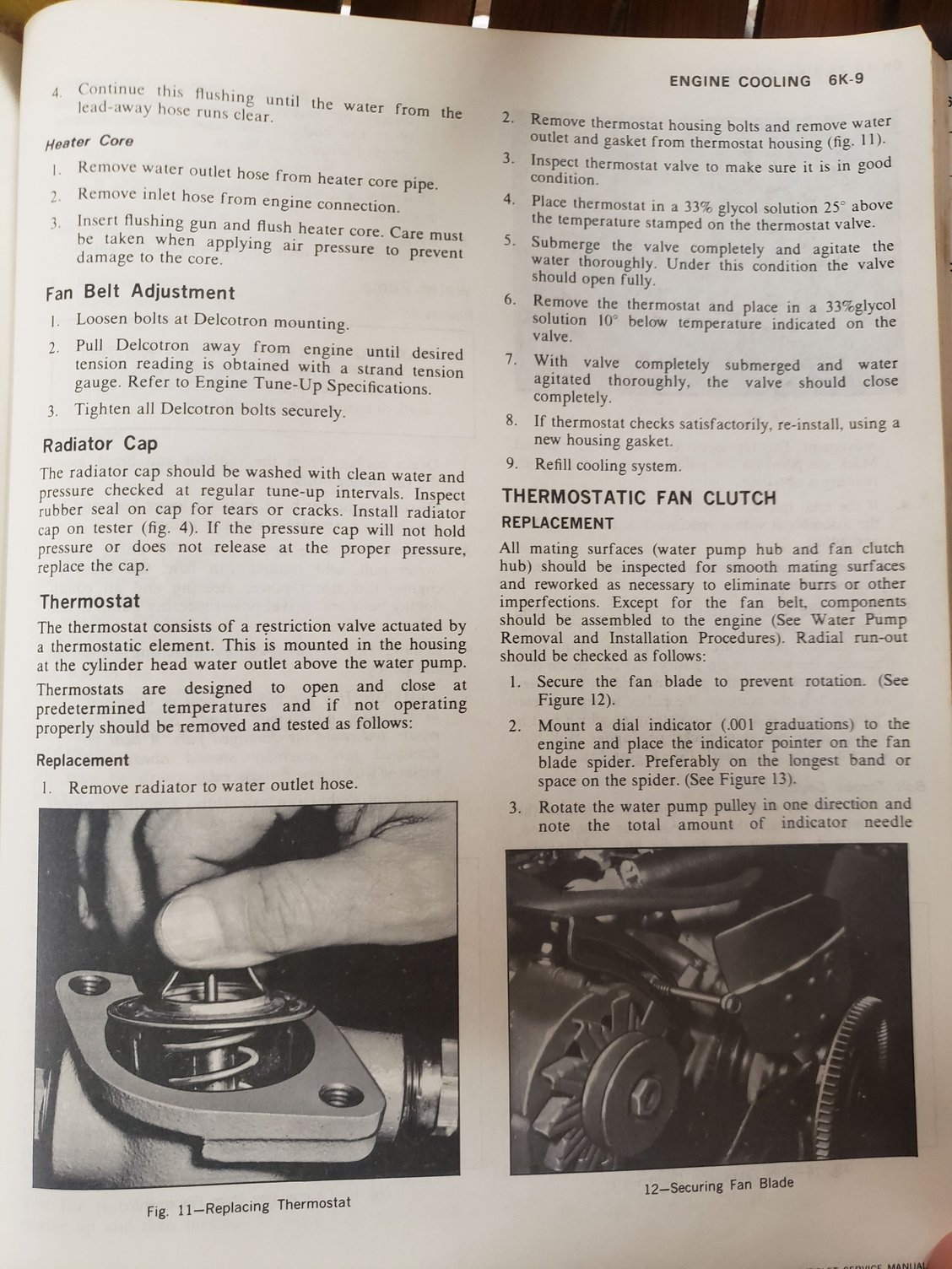

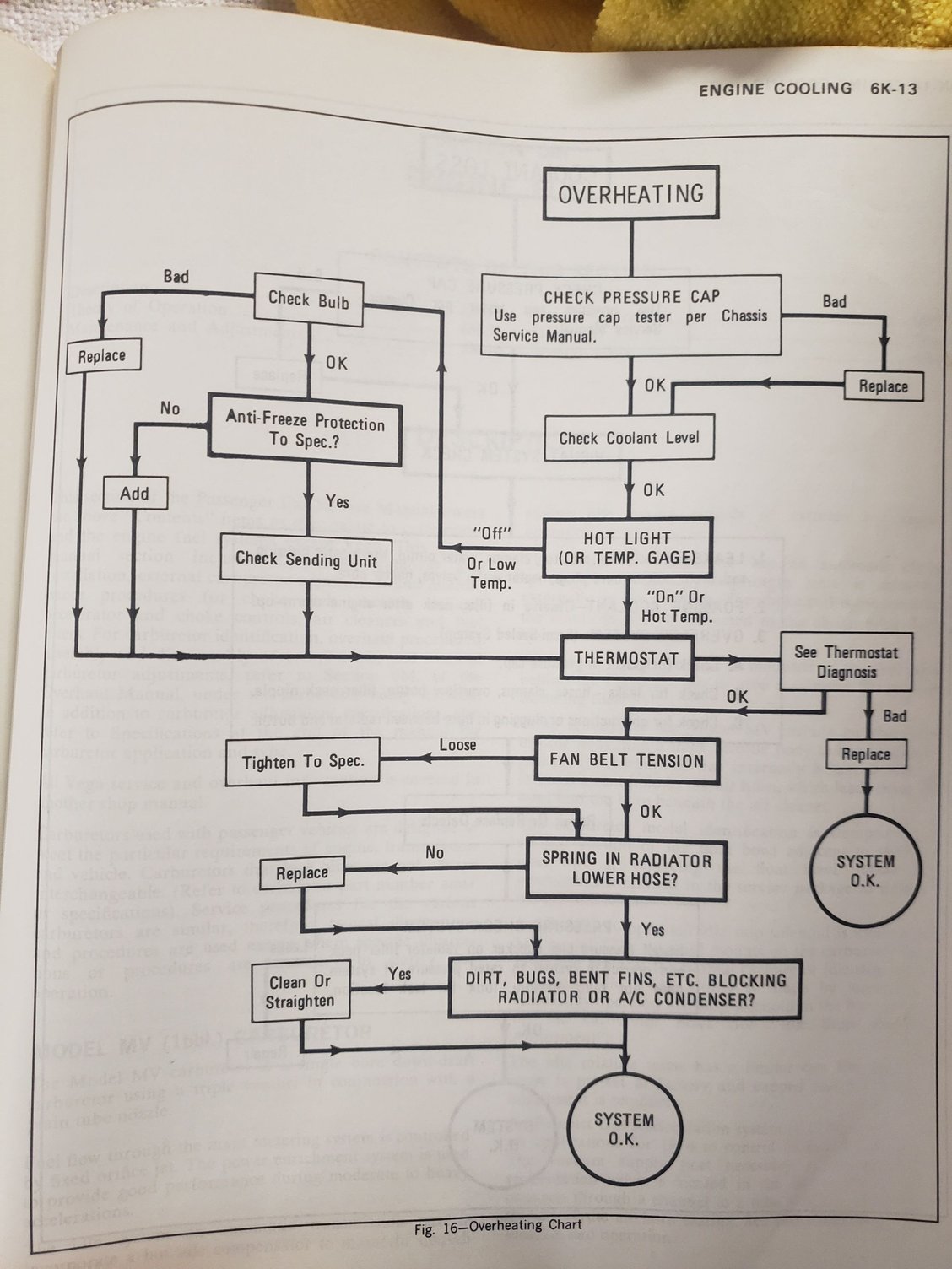

The following pics are straight from the 1974 FSM. You guys will see that the ts does more than speed up engine warm up and set minimum temperature or in other words, normal operating temperature. Also note the test method for the ts trouble shooting. It shows that the ts should begin to open at 10* less than its rating and be fully opened by 25* above its rating. So a 180* ts does not open at 180* when engine load increases nor shut at 180* when the engine load is reduced. The ts is a valve that modulates between fully open and fully closed over a temperature range of up to 35* which is dependent on the rad capacity and efficiency to cool the coolant. Hence, it controls the amount of coolant entering the block from the rad to maintain 180*. So a nice big aluminium rad which gives capacity and efficiency will keep the engine at the ts rating of say 180* under most conditions and HP levels for street use. The engine temp should not rise the full 25* above the ts rating. If it does, then the cooling system as now at the mercy of the ambient air temperature and will eventually over heat.
The fan really is only a means to substitute the air flow volume one would expect to have at say speeds above 30 mph where the fan would not be necessary to cool the coolant in the rad. So whether its electric or mechanical, as long as it can draw the same volume of air through the rad as it would at 30 mph, then there shouldn't be any overheating issues in stop and go traffic.
A flow chart for overheating diagnostics is also included.
Btw, even though this is out of a book from almost 50 years ago, the physics haven't changed i.e. its still current.
I'm really positively surprised by the 73, you open the hood and everything is right there, and you can understand what everything does if you apply yourself (although I still have a lot of applying to do...).
Compared to my modern daily driver which is a complete mystery (it's a hybrid and if something breaks, you can basically throw it away).
Also thanks a lot for the pages, very helpful! I just ordered the 73 version of the that manual, but it'll be at least a month before it arrives, so this should help me get started sooner.
If I want to check the lower hose spring, there's no way to do that without draining the cooling system, right? There's the physics that haven't changed for 50 years again :-)
You can simply squeeze the lower hose when the engine is cool. If the spring is present, and intact, you will feel it, and it will prevent the hose from collapsing. If the spring is missing, it will feel squishy like the uppper hose.
