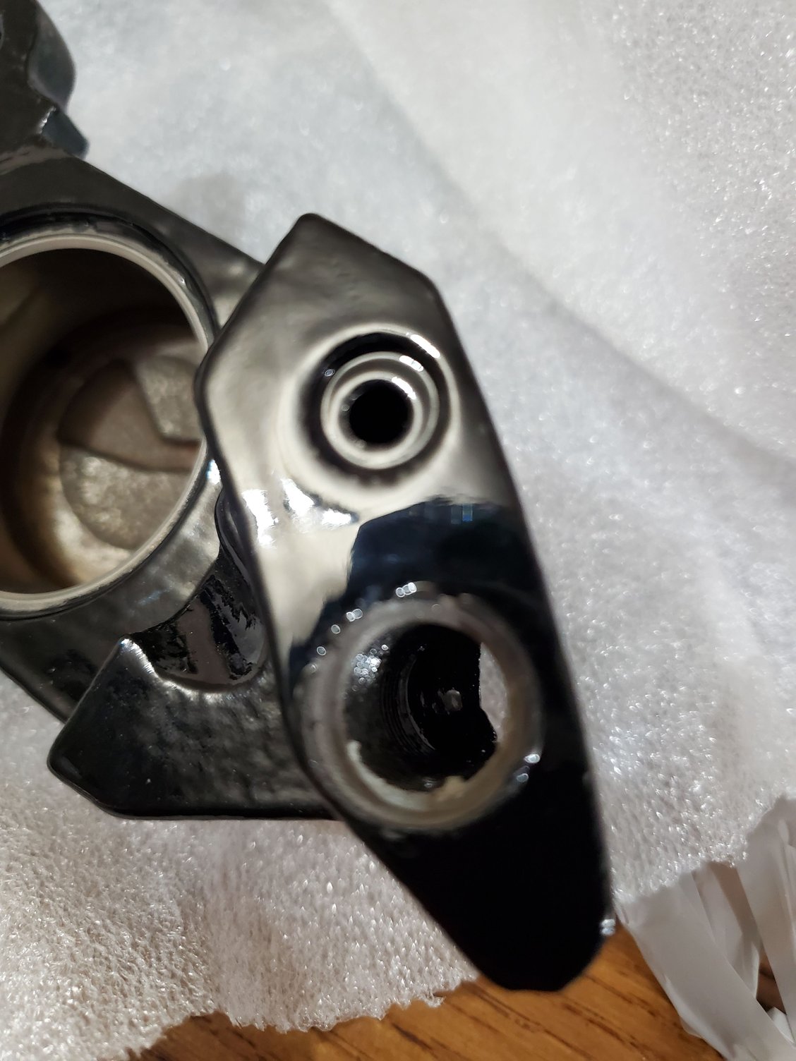

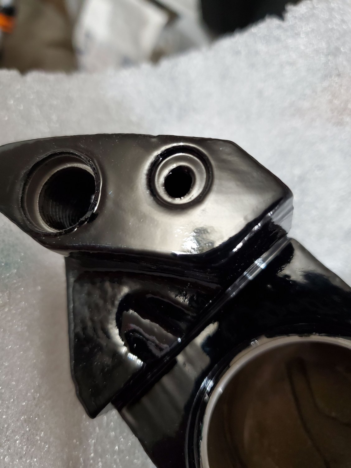

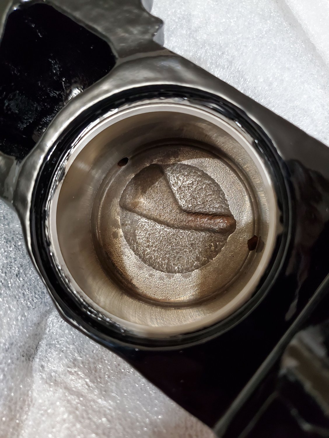

Hi all,
Just got my calipers back from the powder coater. They did them glossy black and they look nice. I purchased rebuild kits and am getting ready to put together. There is a little paint "over-spray" in some areas, I'm not sure if I should be concerned? See pictures below. Some is near the piston bores... There is nothing inside the bore at all, but look at the over spray. Thru also painted the round holes where the little o-ring goes... Do I need to try and get any of this paint off?

I think the mating surfaces between the two halves should be clean.

Absolutely, The powder coaters really should have masked off the mating surfaces and the O-ring seal mount. looks like lots of fun getting it off. Powder coat is NOT paint.

The presence of the coating material on these surfaces is problematic for a variety of reasons.
First, glycol brake fluid will eat paint. This will contaminate your system.
Second, assuming you opt for silicone fluid and avoid the aforementioned issue, the design is such that when the bolts holding the caliper halves together are torqued, the clamping force is applied uniformly across the mating surfaces while providing for a specific amount of deformation of the o-ring. If the coating was uniformly applied across the whole of the contact surfaces this would not not necessarily be a concern. However, it is unlikely that the coating is indeed uniform. This could result in excessive deformation of the o-ring, leading to leaks. Worst case would be the piston bores would not be on the same plane as the mating surfaces would not be parallel.
Regarding the coating on the seal lands (the tops of the bores), the presence of the material will not allow the seals to seat properly, allowing dust and moisture to get behind the seal and contaminate the bore, the piston and the piston seal. Also, the amount of material may prevent the seals from being installed at all.
Best to remove all the coating from those surfaces.

I can't imagine that the painted area where the O-ring fits would be a problem, unless the O-ring just won't fit well with the additional paint. That is not a 'working' joint; it just stays there and seals off brake fluid from leaking out. If the powder coat used is not attacked by brake fluid, leave it alone.
If you have powder coat in threaded holes in the part, you should 'chase' those threads with a thread tap to clear out the paint. Otherwise, you will have difficulty getting the bolts inserted..AND if you can install them, they could loosen with any wear/fretting of the bolt threads against the paint (instead of the mating threads).

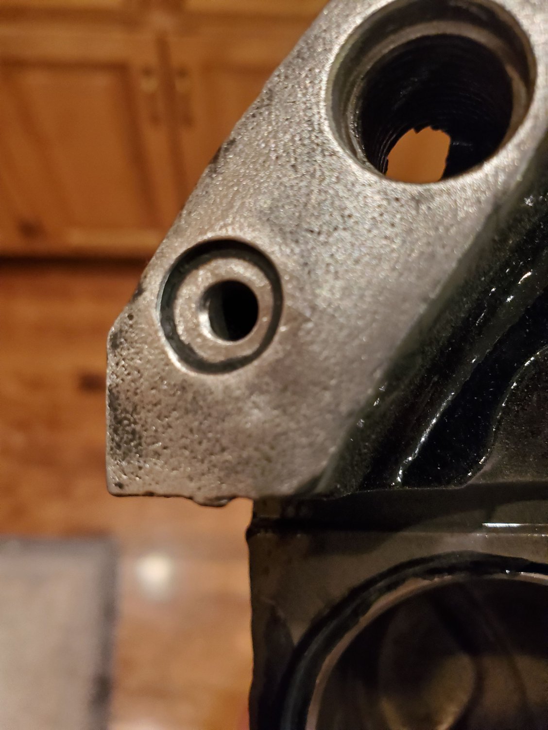

OK. I spent a little time with the dremel. First a little steel brush, then a brass brush. The brass one is cone shaped so it kinda fits in the o-ring hole nicely. What do you think of this?
Side I didn't do...
Side I did do...
Does this look good enough?

Looks good to me.

Yes, that's the goal. It was never a machined, mating surface so what you have there should be good to go.

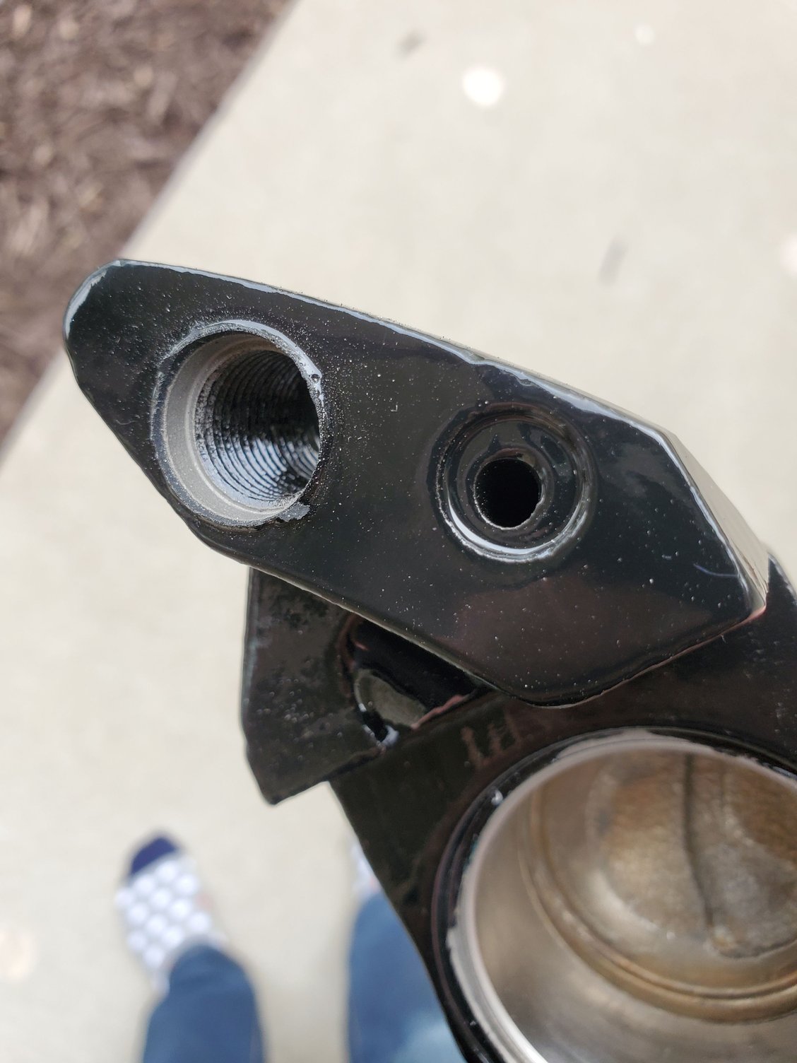

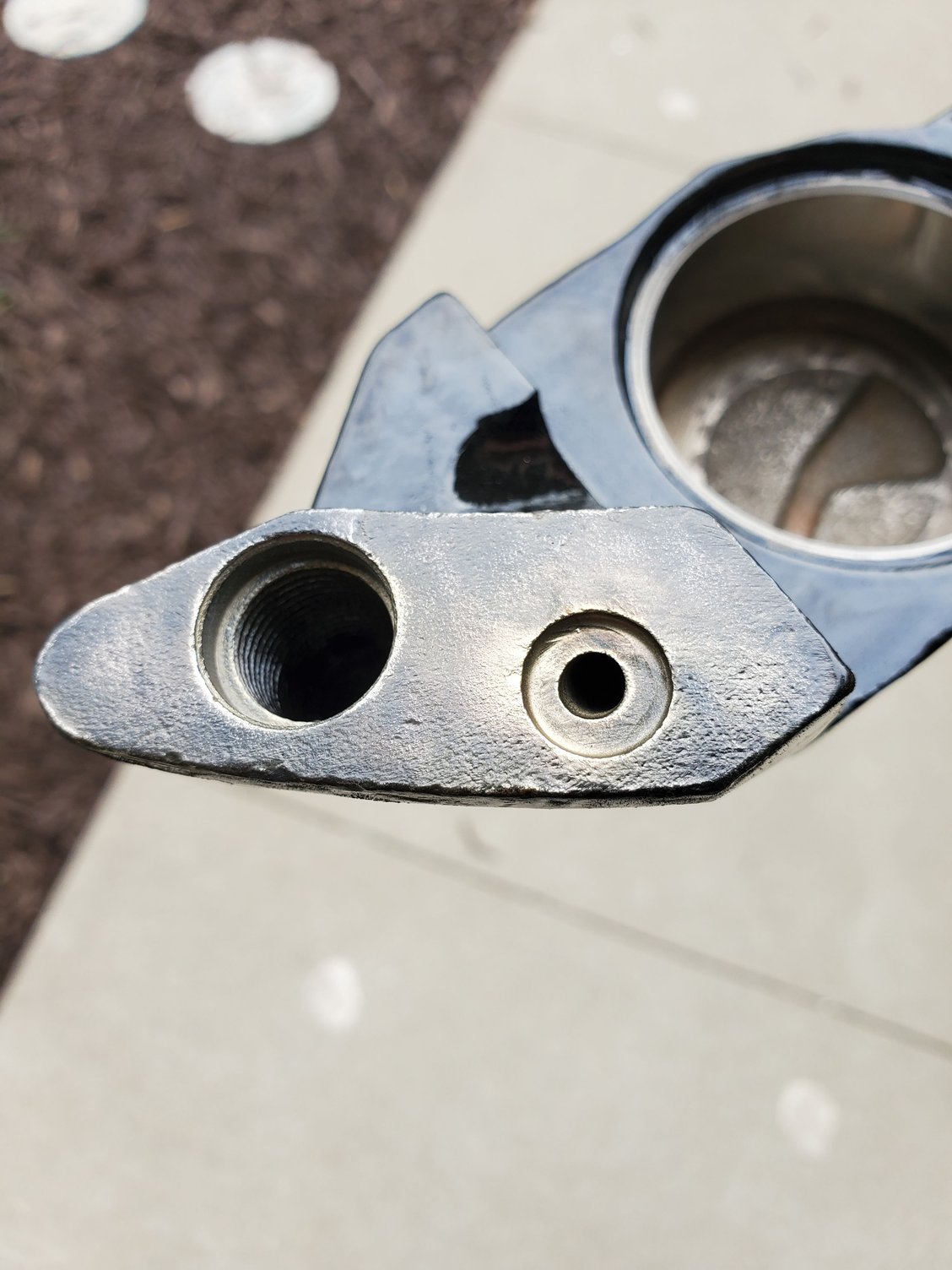

The dremel is working at taking the paint off the large flat surfaces. However, I'm having a little trouble getting it out of the o-ring hole. Here are pictures of 2 of them. Do you think I need to keep working on it, or is this good enough? If I need to get more out, any suggestions on how to do it?

the O-ring has a round cross section. it won't touch way in the corners anyway.
