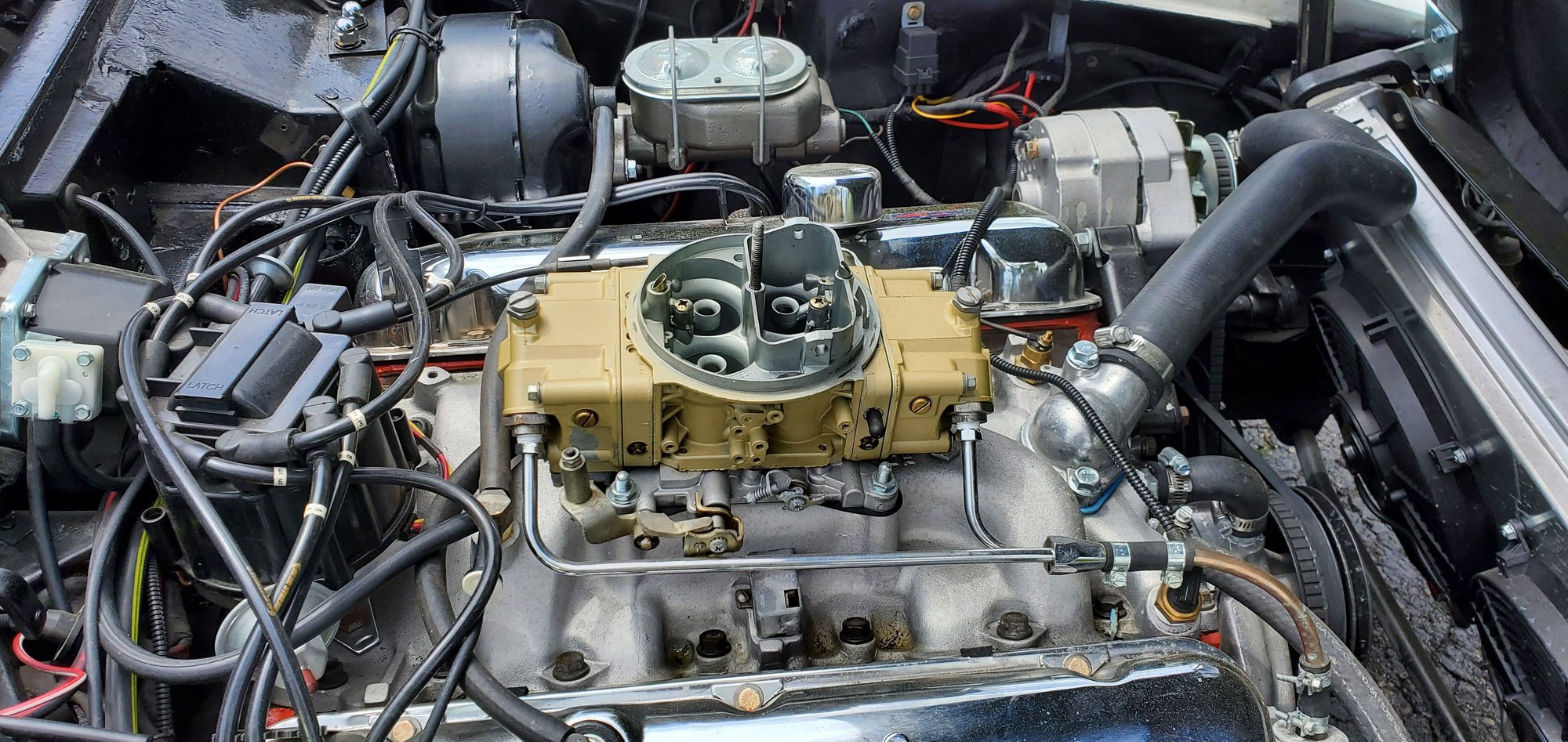

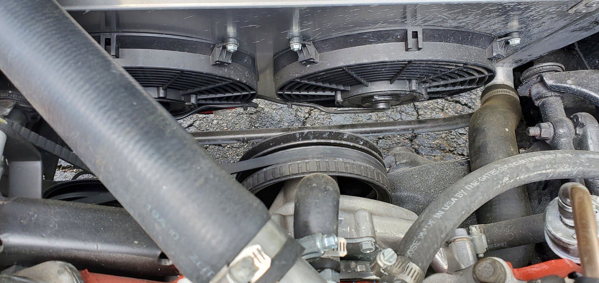

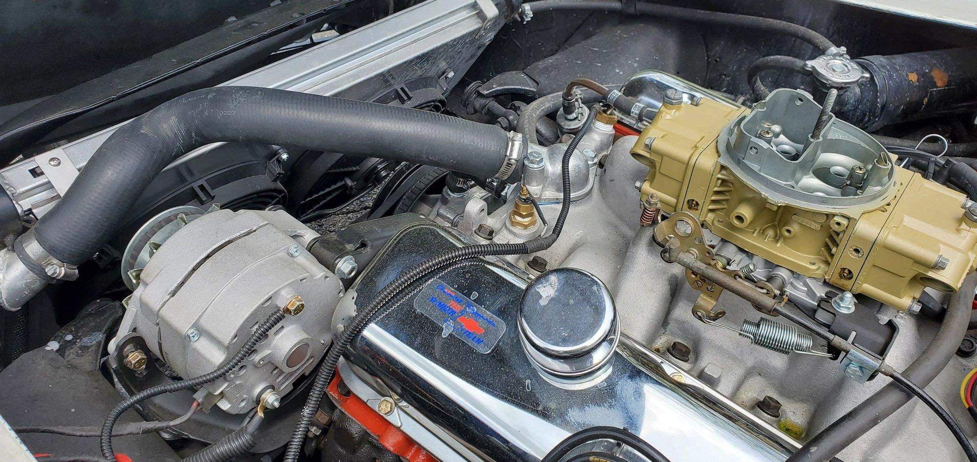

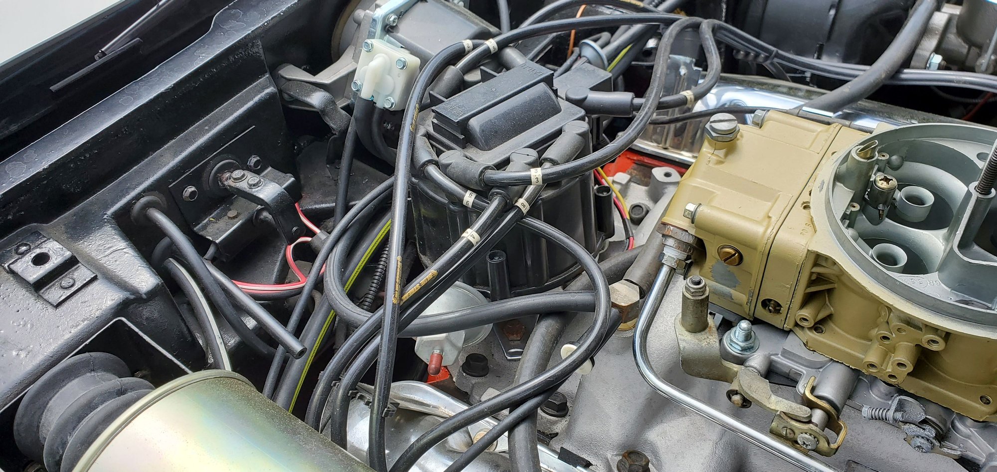

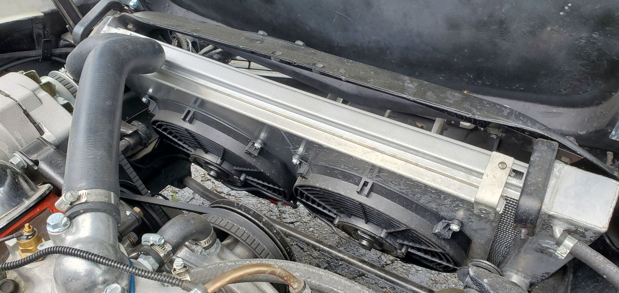

To Cooling system questions
Old May 9, 2021 | 02:16 PM
zblackz06's Avatar
zblackz06
Joined: May 2016
Posts: 492
Likes: 35
From: Norwalk, Ct
Old May 9, 2021 | 02:18 PM
zblackz06's Avatar
zblackz06
Joined: May 2016
Posts: 492
Likes: 35
From: Norwalk, Ct
Old May 9, 2021 | 04:40 PM
7T1vette's Avatar
7T1vette
Posts: 37,637
Likes: 3,116
From: Crossville TN
Your main problems are: You should have a 180*F thermostat in the intake manifold; there is nothing connected to the vacuum advance can on the distributor (this should be connected to MANIFOLD vacuum...not ported or timed vacuum); the high-flow pump is just generating more heat by trying to force more fluid than necessary thru the [higher capacity] aluminum radiator; the electric fan switch should be set to around 190*F {after you install a 180*F stat in the engine}.
You also want to verify that the lower air dam is installed under the nose. It forces airflow up and thru the valence holes and into the radiator when driving.
