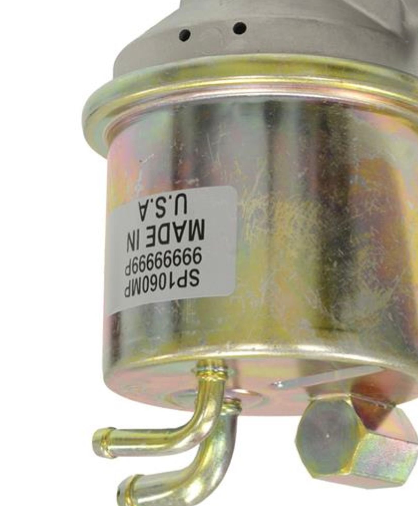

https://www.corvetteforum.com/forums...mp-79-l82.html
I was lucky as my pump bolt fit to hold rod, there is a hole to hold the pushrod to change pump..also put at tdc when you start..
not for sure if yours is the same but it SHOULD have a shorter bolt in that hole...but caution not long enough to hit pump rod..
also fyi do not buy a carter pump...mine ticked..and replacement at first is great (same pump) but i think i hear it coming back, not for sure yet..
forever i looked..corvette central tells me picture accurate..i just ordered..
https://www.corvettecentral.com/c3-6...d%26q%3d353155
