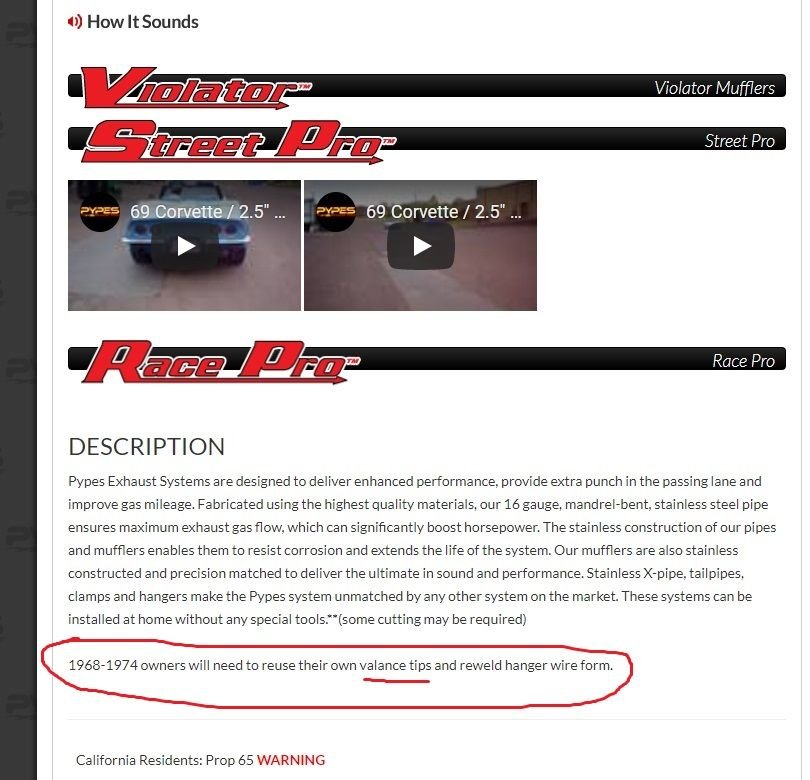

Well there's something to try before you change it. I've herd exhaust exiting under the body drones and make sure to get the tip past but honestly don't have a ton of exp with it. I don't think either my C3 or C4 drone, did the one exhaust and redid the muffler/tip on the other myself. I'll post the vids for an example of my tip placement.
First tho do you have any tip at all?. I see on their website it says your to reuse the stock one for your 69, also their vids are kinda loud so idk if a tip will solve it but you could try some cheaper pipe n extend them first to test it out if you have no tips.

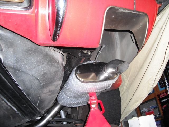

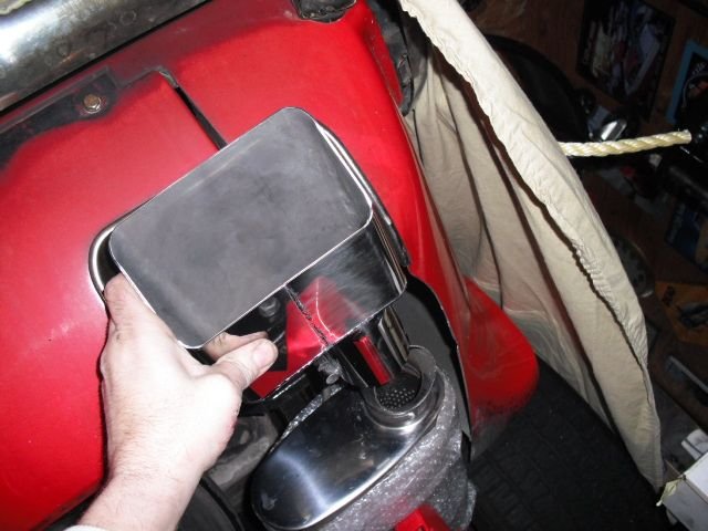

I installed the Magnaflow 2-1/2” with x-pipe system on my 73.
I did modify the mufflers to exit out the back using 2-1/2” Gibson tips because the system had turn down tips. Everyone says they sound great and I don’t have any drone.
Of course, everything on my car is modified.
If you do stay with the stock system you can put in an H-pipe fairly easy.
