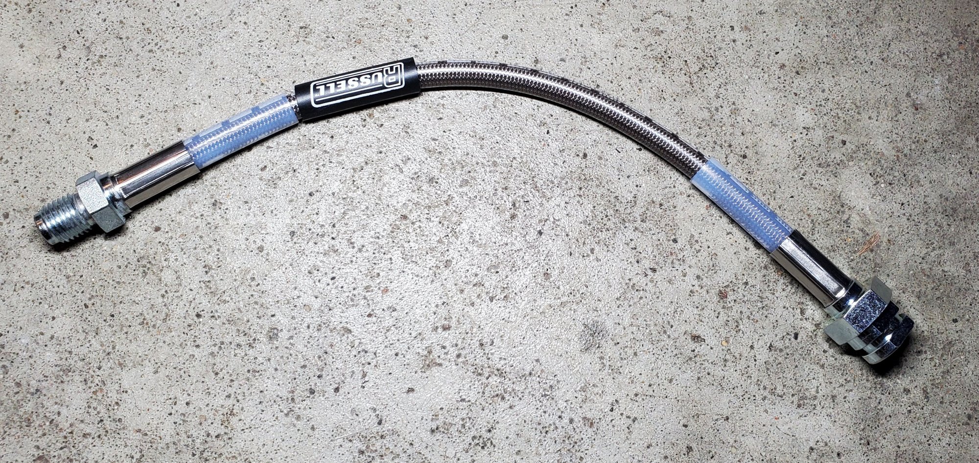

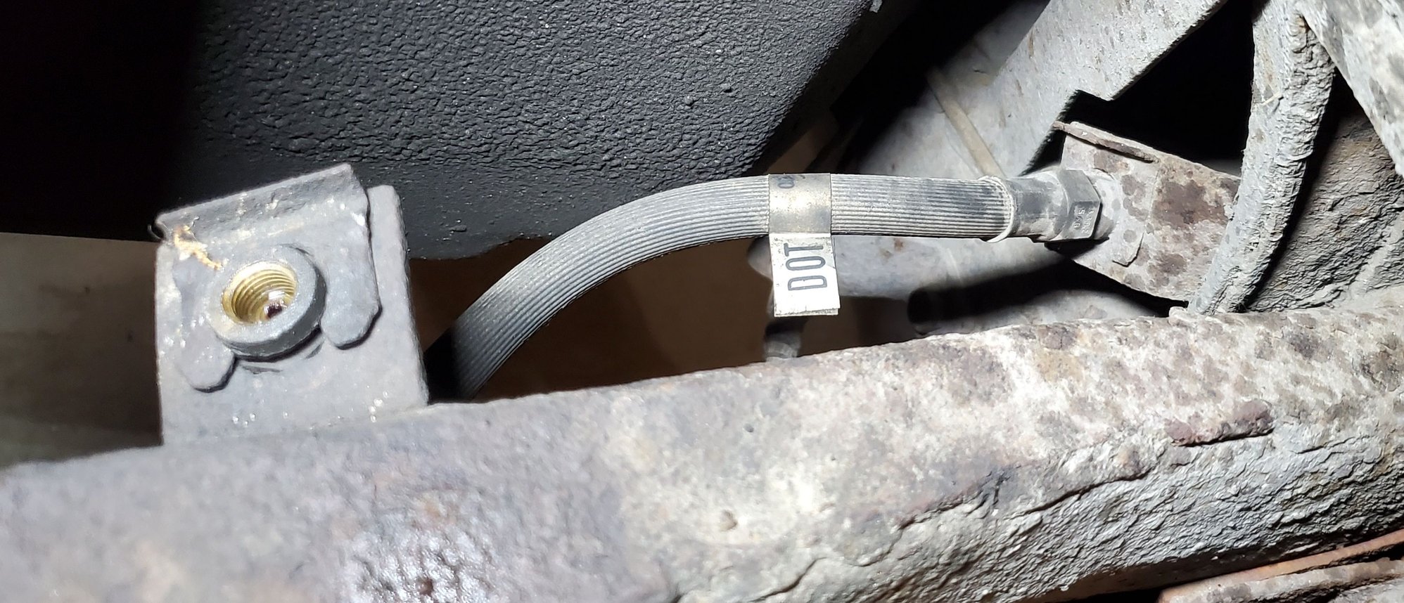

I purchased a set of stainless brake hoses and was going to replace front and rear. I believe I got them from Summit, they are Russell's brand. I'm looking at the hose on my car and it looks like it has two female ends... But my new hose has one female and one male end? Is my new hose wrong, or am I missing something?
Here is the old hose still installed on my car.
Here is the new stainless hose I wanted to put on.

Wrong hose, methinks... It might be 'correct' for a different model year. Your AIM should show you what you need.

Nevermind...I think I figured it out and it's correct. If I knew how to delete a thread, I would delete this.

I haven't done it yet... And I don't think I need to remove the clip? I think the clip is holding the fitting from the other side which is female thread... So the male thread end of my hose will go there. I also looked it up in my aim and it seems to show that as well. If I think of it, I'll snap a picture this weekend when I do the work to illustrate.

Yep. As I recall that clip in the right side of your picture holds the brass block to the bracket. The block has a female thread.

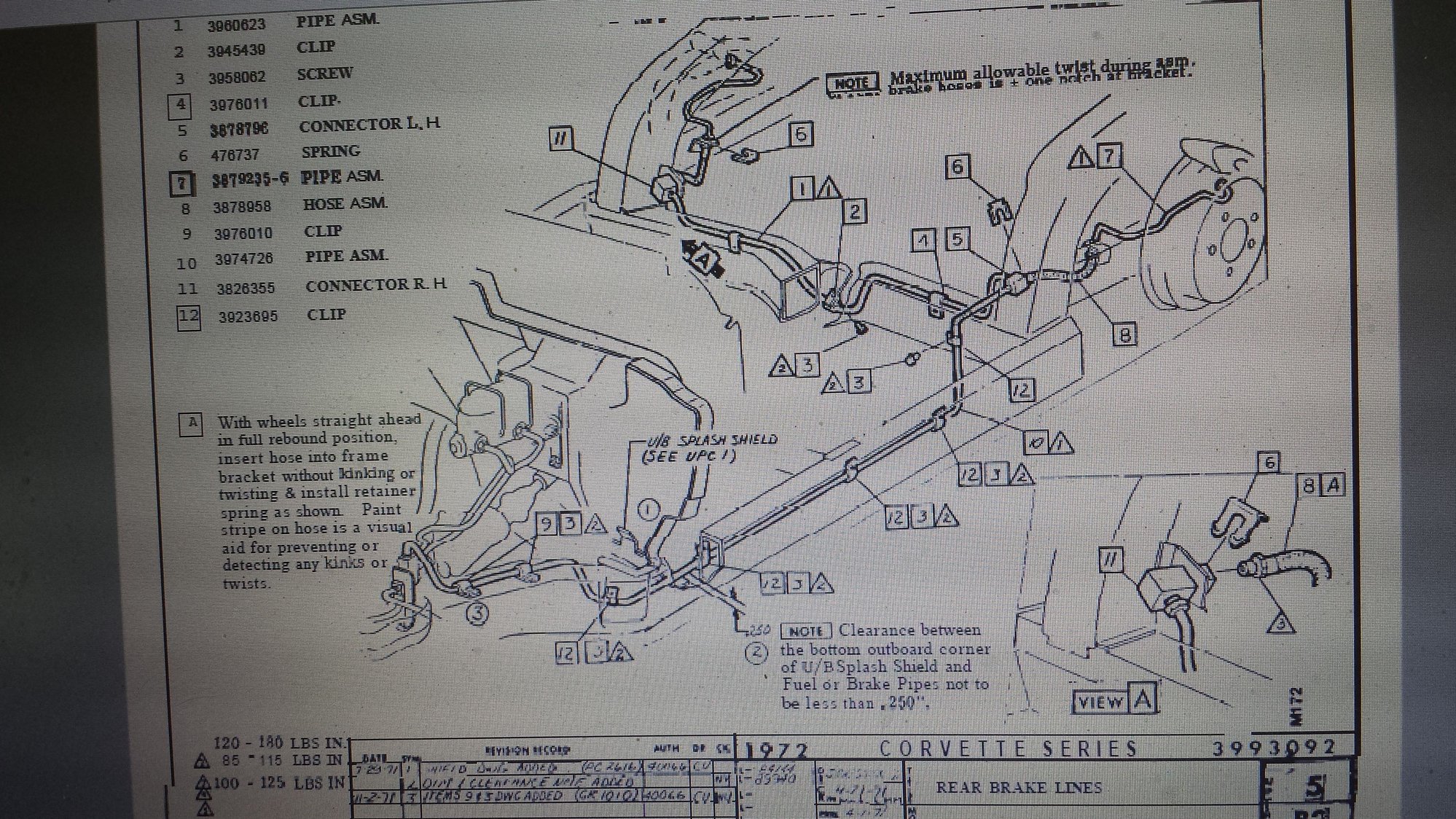

Old May 22, 2021 | 01:10 PM
sunflower 1972's Avatar
sunflower 1972
Joined: Sep 2016
Posts: 2,230
Likes: 984
From: Wauconda IL

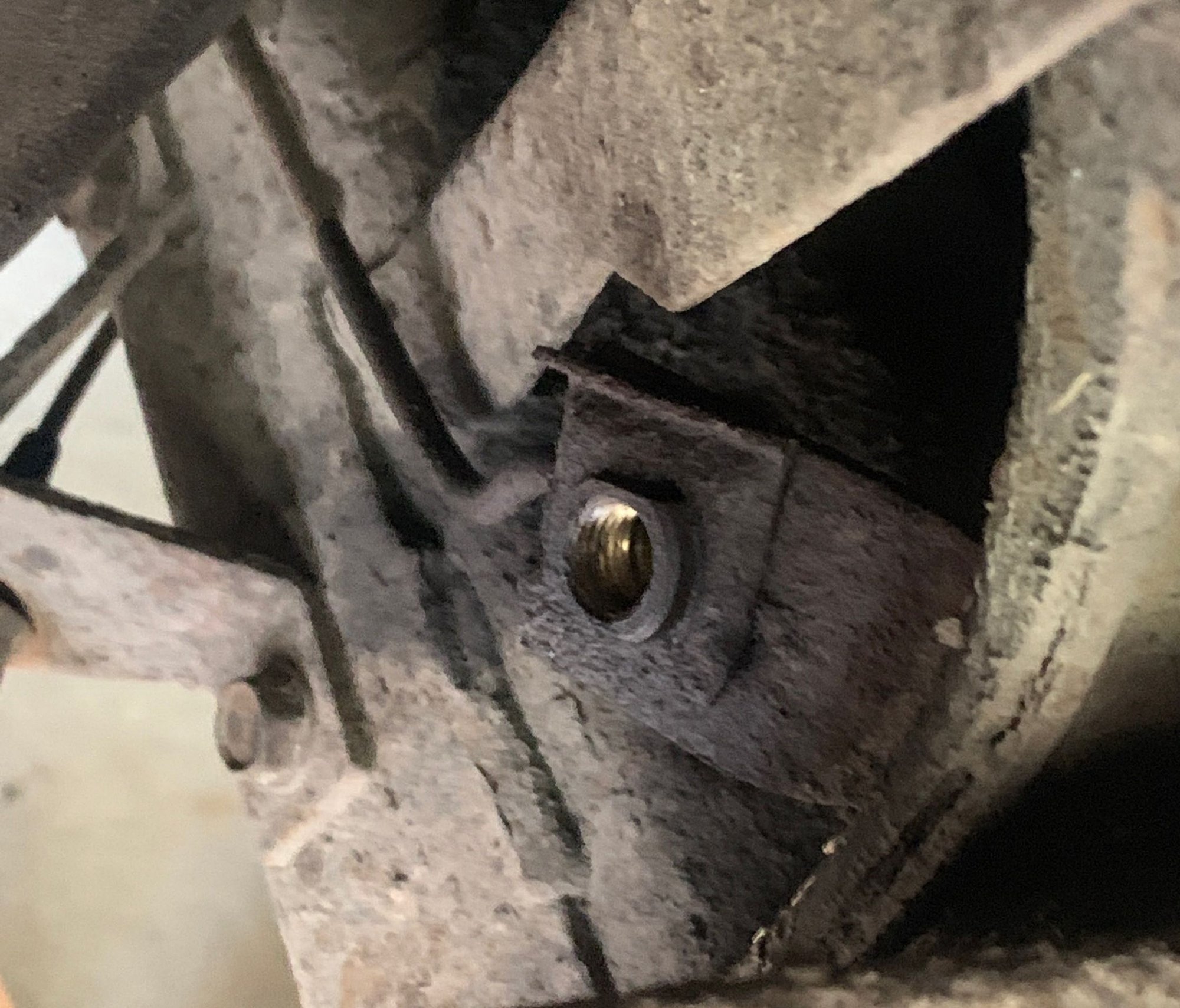

Got the hose out... Yup, the brass block is female
