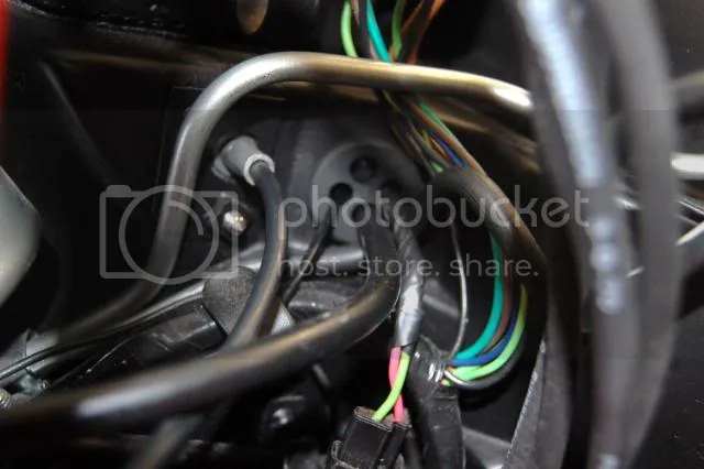

This picture is one provided in a previous thread years ago by user "Alan 71". I know I should be looking for the light green/pink plug in this photo, but I can't find it.

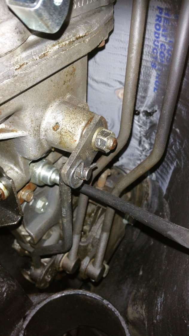

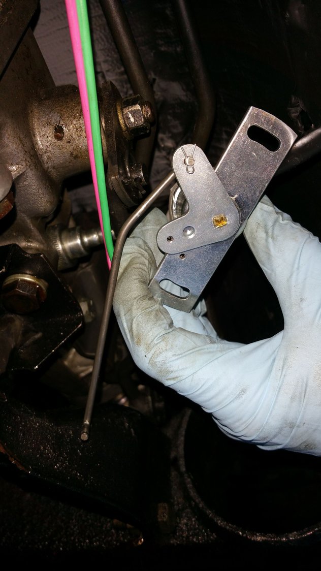

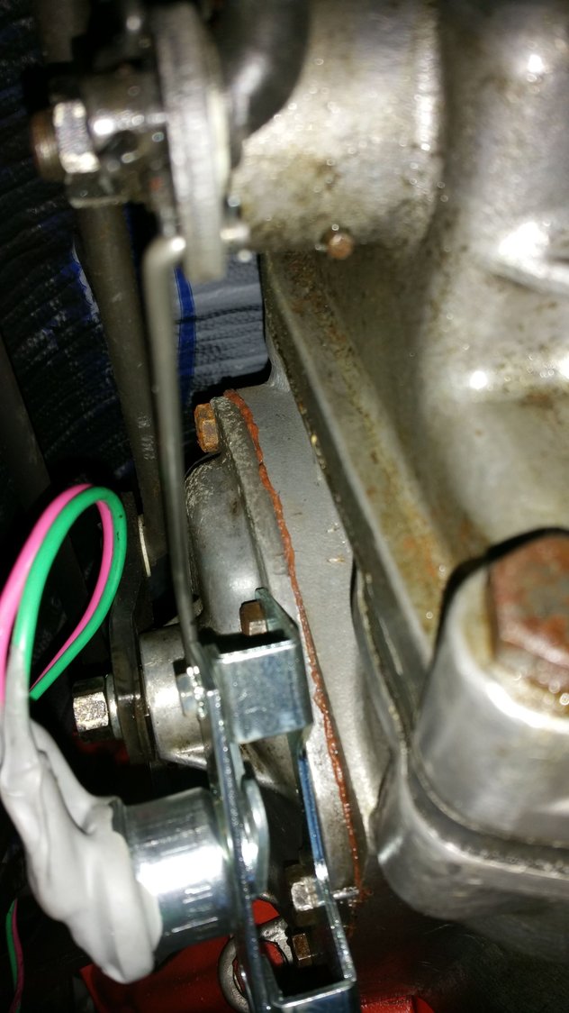

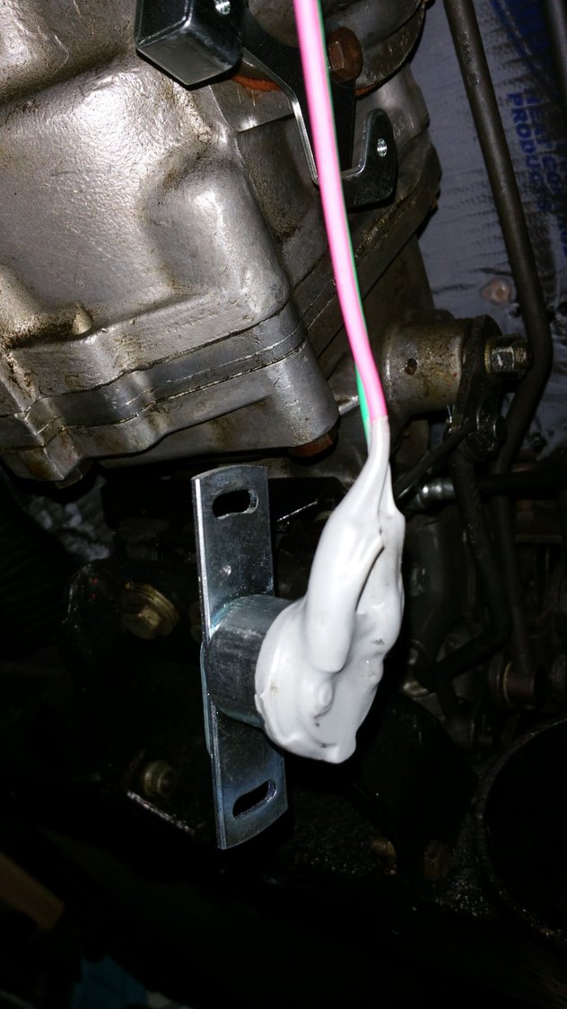

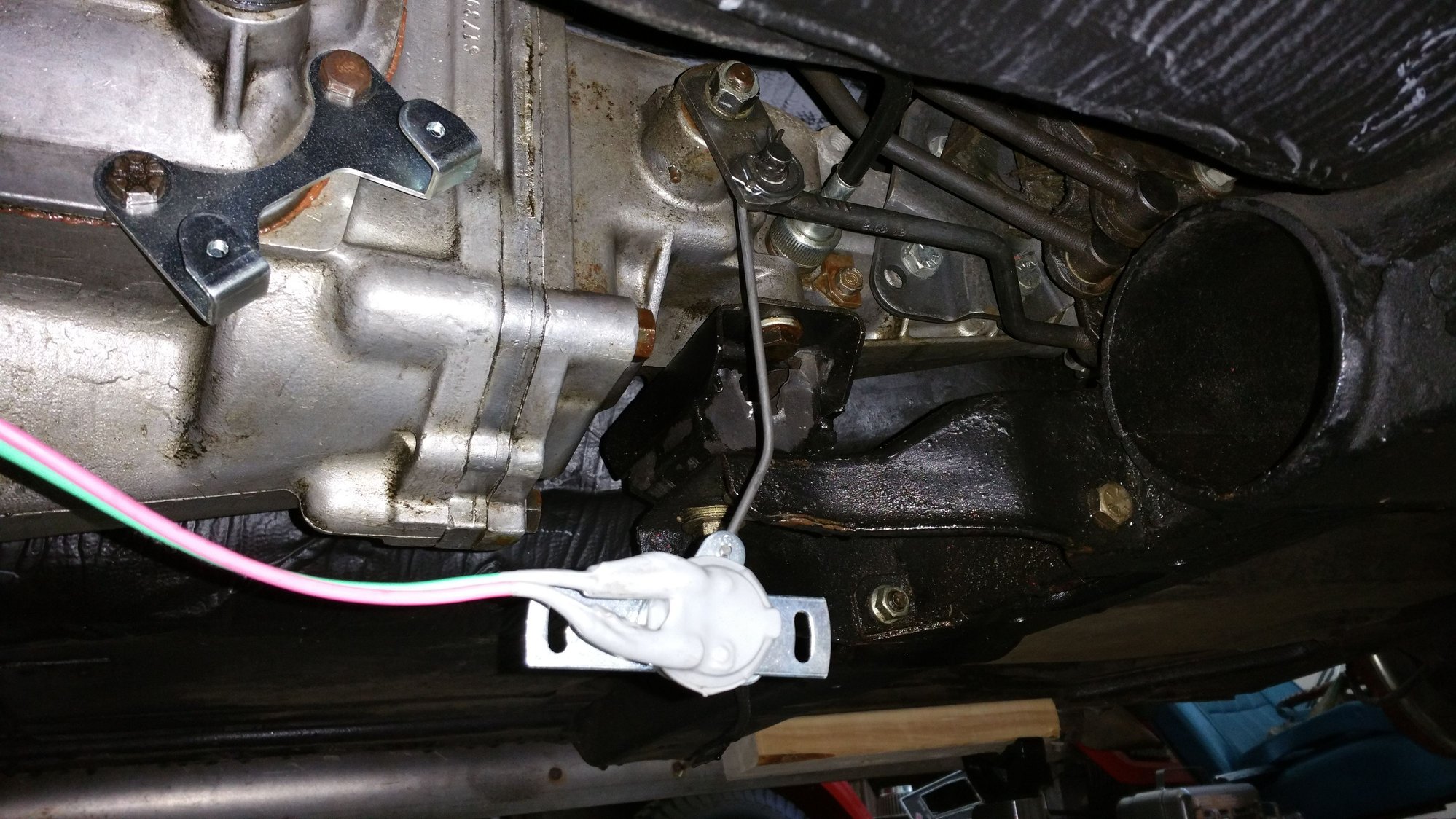

My wiring and plug was under the center console on my 68. THe previous owner never ran it through the fire wall. You may have to take the side panels off to look under there or lift up on the metal part of the center console to look under there.

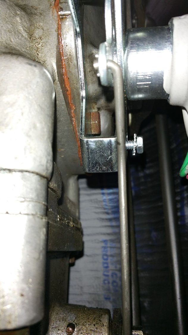

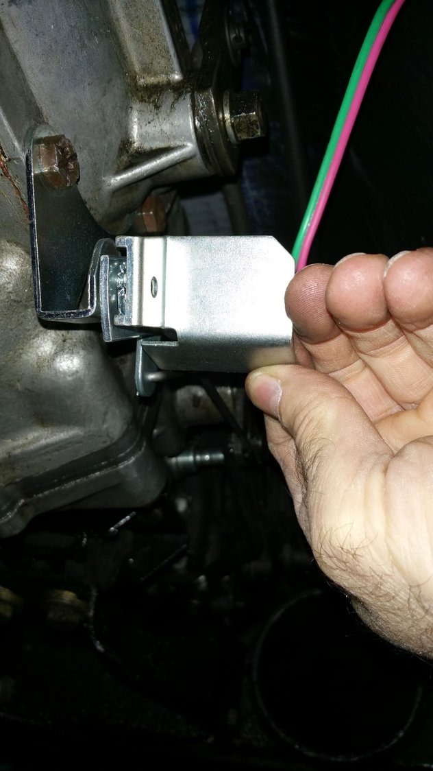

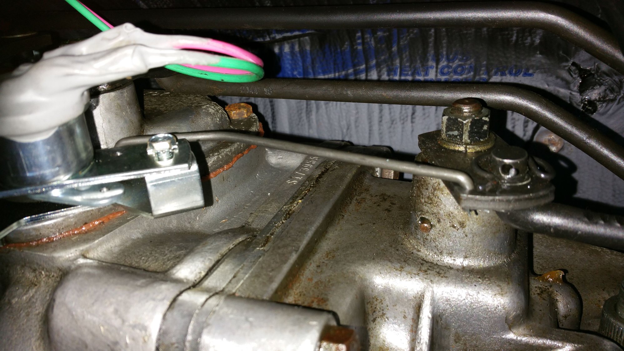

If yours is a manual, The switch on the tranny s bolted to the outside of the tranny just in front of the reverse arm and is connected to it with a short linkage..the wiring should be permanently mounted to the switch with a really long pigtail. my pics may show the switch in backwards...I dont remember when I took them but I know there was a lot of experimentation to get it hooked up correctly
notice the small linkage arm its easy to get it backwards. I had to keep flippping the arm and the switch around to get it to operate correctly
the shield it there to keep rocks and dirt off the switch
I think this was tthe final and correct way that I had it mounted

Looks like this:
look around the drivers side bell housing. The wiring harness side is short so the switch wires run up to it. I'll snap a picture of there it is on my '71 when I get a chance unless someone beats me to it.

Take a Jumper on the Plug on your Pic and Ign on to test it (wircolour is the same.)

Some of you guys might have missed some of what I said. That picture was not mine. In my post I said that mine was nowhere to be found.
