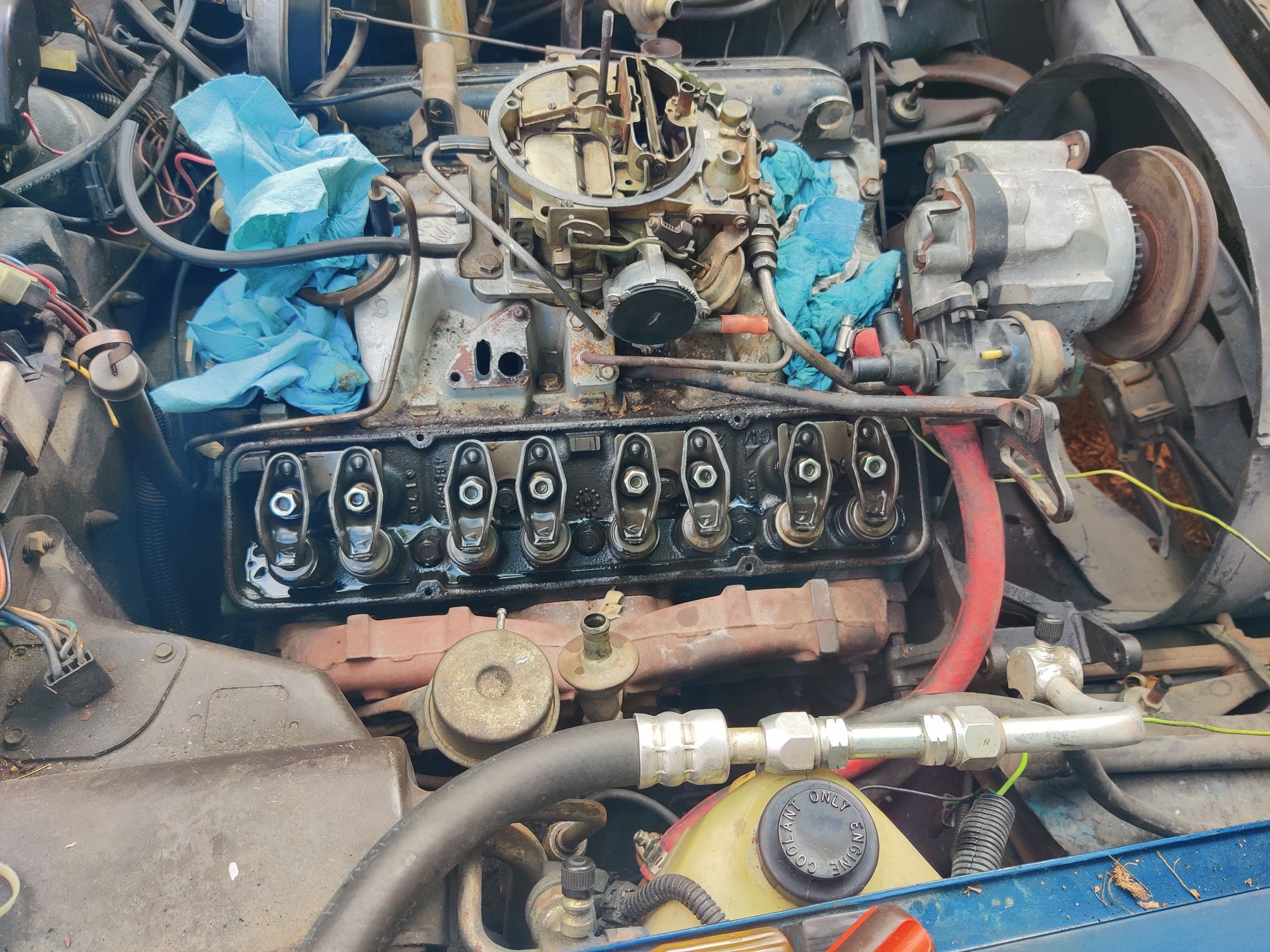

Recently my engine seized up so I'll be pulling the engine I have removed the hood and will be starting the process of removing the radiator tomorrow was wondering if I could get some advice from engine pulling vets

rad usually doesn't need to come out. remove fan, shroud, alternator, water pump, power steering, AC compressor. do not unhook lines on AC or power steering. exhaust. the exhaust bolt heads burn a little smaller. use a 6-point 14mm socket. plenty of PB or WD40. engine hoist in from the side, not over the nose. that will keep you busy for a day or so. go get a bunch of tupperware-ish containers. zip lock bags. white tape and a good pen for labeling bags of bolts.

Derek nailed it. I just pulled the engine out of my 81 last weekend after throwing a rod. My biggest issue was getting to the bell housing bolts. I ended up removing the transmission crossmember and lowering it down a bit so I could get a long extension onto the bolts.

Those top 2 bellhousing bolts are a B!tch. take lots of pics on your phone so you can reference where that long stud went and how brackets are mounted BEFORE you remove various parts. You can get it out with the exhaust manifolds still on, but if you can get them off, a bit more room when you lift. if your engine has factory lift lugs. great. if not make some up and bolt to intake manifold bolts. opposite corners. get a floor jack underneath trans or bell housing to hold it up.

flex socket for bellhousing bolt on extension
you may need remove radiator to get shroud out LOL!
FYI - never pulled an engine out of C3 just tranny/ clutch and radiator..

does this motor turn at all? if not, removing the torque converter from the starter wheel could be problematic. first trip under, remove the starter and the dust cover. then use a jack handle or really big screwdriver as a pry bar to try to move the engine a tooth or two at a time. unbolt any converter bolts you see first. i think only 3 converter bolts. exhaust pipes to manifold are easier to remove before you unbolt manifolds from the engine. those 3 on each side are bolts that like to break.

I bought a 1-ton hoist will that be enough for both the engine and tranny? The engine hoist also comes on the 10th so I'll make sure to update when I get it in. @derekderek I was unable to get it to turn over even after pulling the spark plugs, disconnecting the alt, compressor, power steering, and disconnecting the distributor. It's extremely tight I'm unable to even get it to budge.

pull the starter and use a jack handle on starter teeth. you may get it to move far enough to get all the torque converter bolts. if not, the engine has to come forward a good 6 inches to get torque conv out of trans. and then it will dump trans fluid as the engine rocks while pulling it out. so best bet may well be remove engine and trans together. driveshaft. you have to unbolt the straps-caps on front end of shaft to release u-joint from the slip yoke. then you REALLY want the yoke to stay in the trans to not dump mass quantities of trans fluid all over the place. so a bit of coat hanger wire work is called for. take cable off and leave speedo drive gear in trans for the same reason.

I have spent today flushing the radiator because It looks like it needs removed for me to remove the shroud. I got most of the top half pulled apart and organized into labeled bags. I've also taken before pictures of how it goes back together. I think Ill be replacing a lot of the rubber tubes as they are extremely dried out and a lot of them cracked just from me gently pulling them off. There was also a calcium build-up or something in the therm housing. Ive got the carb pulled off as well and I think If the engine is fine Ill replace it with a holley

I did pull the rad and the rad support and then I was shocked to find how much room I had that way.
But yours may have an ac condensor up there so...
My rad had to come out first for me to be able to get the fan shroud out..
I used a 2 ton hoist with the arm all the way out, which knocked it back to 1 ton IIRC.
I needed the long arm to get over the wide fender from the side.
Also pulled a wheel off and lowered the car as far as I could and still get the left leg under it.
The nose is just too long to do it from the front.
Use an engine leveler and it is easier to tilt it to where you want it.
Pulled my BB with no trans.
If you can not rotate the engine to get the trans off, it does come out as a unit.
But you will need more tilt, boom height and room to swing it all forward.
I almost ran out of ceiling room in my 9'3" home garage.
Not sure I could have done the engine/trans combo in that garage..
PS: Keep the Q-jet. They are better than a Holley for a street car. Send it to an expert like Lars if it needs attention..

@leigh1322 I'm just wondering if it or the fuel pump isn't working right because after it seized I pulled the plugs and about half were showing lean and the other half of the plugs were either fuel fouled or oil fouled. That and I want to track the car so I'm looking to get the most power I can from it even if I suffer on mpg

looks like your AIR system is complete. save those parts. Holley. if you decide to go that route, do not get a Q-jet only intake.
