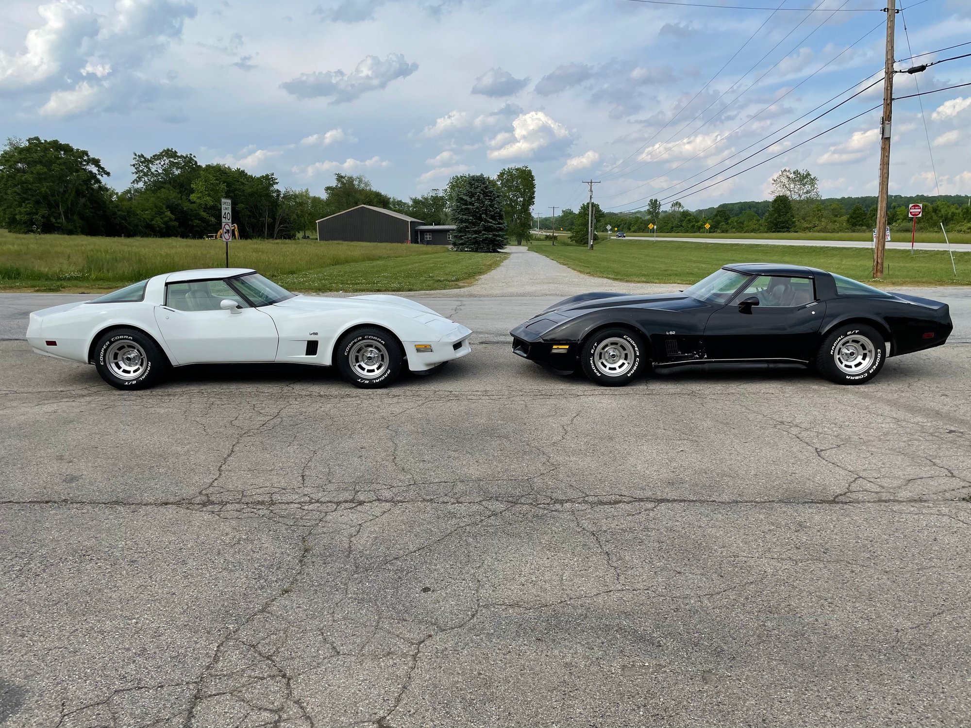

On my white 1980 L82 I just removed the Catalytic Converter and installed a “test” pipe ( straight pipe ) in its place along with a distributor curve kit , seems to make a noticeable improvement but I haven’t ran it at the track yet so no data other than the butt-o-meter but this will be my base line when I do run
On my black 1980 L82 I installed some 64cc chamber Promaxx 183 aluminum cylinder heads, Comp roller tip rocker , Edelbrock Performer, Comp XE262 cam slightly less duration than stock but a touch more lift along with side mount Hedman headers going to 2.5 inch side pipe with one not tight 90 degree bend going through 2.5 inch Cherry Bomb glass packs , with a 700R4 transmission it ran a 13.64 at 102.87 Kilkare a month ago
I just received some Hedman headers from Jegs today for rear exhaust to replace the side exit headers / side pipes do to noise , I’ll be converting to 68-74 dual exhaust but can’t imagine it being anymore powerful than the side exit
if you look close at my black L82 you can see the side pipes
