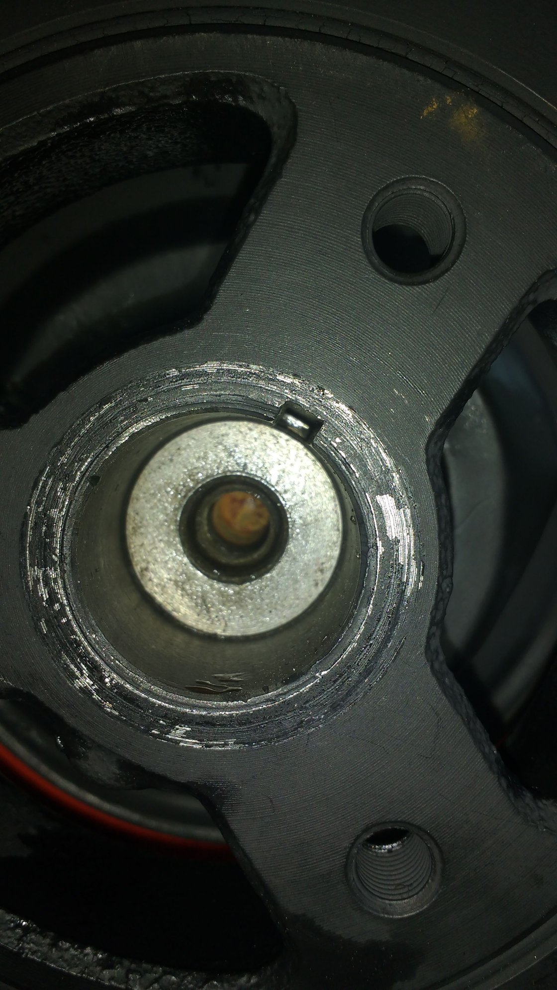

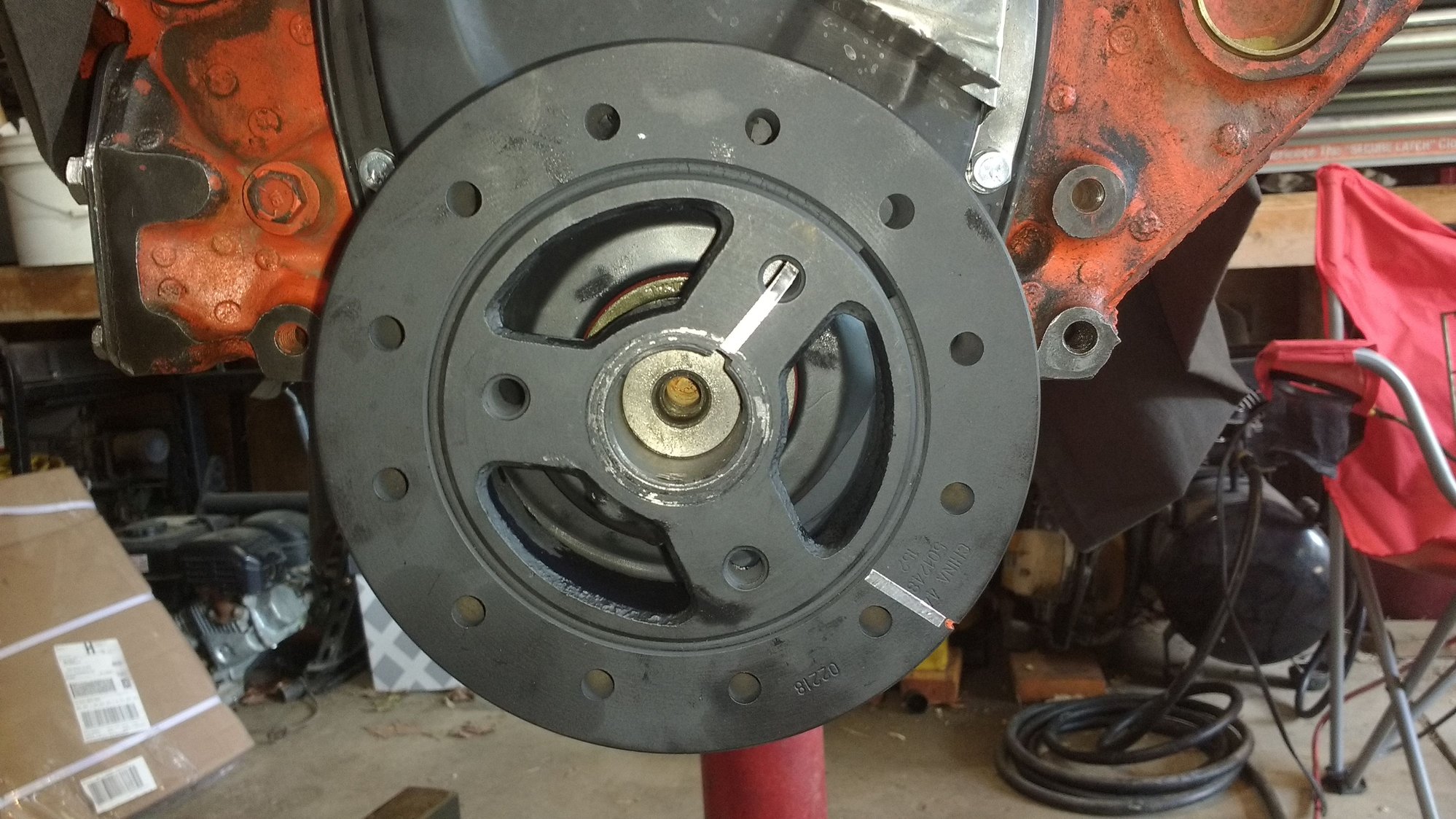

I went to set the prelash on my rockers today and things were not feeling right. I had my timing wheel set up on my balancer to the mark on it. I finally turned the engine over while looking in the #1 spark plug hole and it looks like my balancer mark is way off. It's not 180 off, it's more than 90 off. I pulled the balancer bolt off and it is on the keyway as it should be. What is going on here? Did the outside of the balancer shift? Maybe could someone check the position of the keyway to the timing Mark on their balancer.

Here's a better photo with the keyway in relation to the timing mark

The outer shell of the balancer has slipped. The keyway is in the correct position for TDC.
You will need a new balancer.

The balancer rubber isolator is dry rotted cracked and has a one inch chunk missing from it.
Your piston is in the right spot now though.......you could mark the balancer TDC now and do 90 degree marks which would allow you to do the firing order TDC method that I prefer while you are waiting for your new balancer.
Do yourself a favor and buy a new balancer with 0-60 timing marks on it......much easier to set timing.....and you can use a cheap strobe light to do it. Single mark balancer like stock requires a dial back light to set timing the preferred way to 36 degrees total.

It's not the original balancer as it is marked Made in China, but I don't know how old it is - it was on the car when I bought it over 10 years ago. The tab is aftermarket, but that's the only spot it can go on the timing cover so I doubt that's an issue. I'll still check it visually while I'm setting stuff up. From what I have read, the timing mark should be about 15 degrees counter clockwise of the keyway so mine is obviously way off. I'm going to pick up a new balancer from the parts store today and mark it every 90 degrees before I put it on. I do have a dialback timing light so that is not a big deal - thanks everyone for your input.
