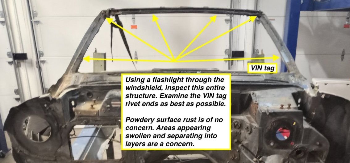

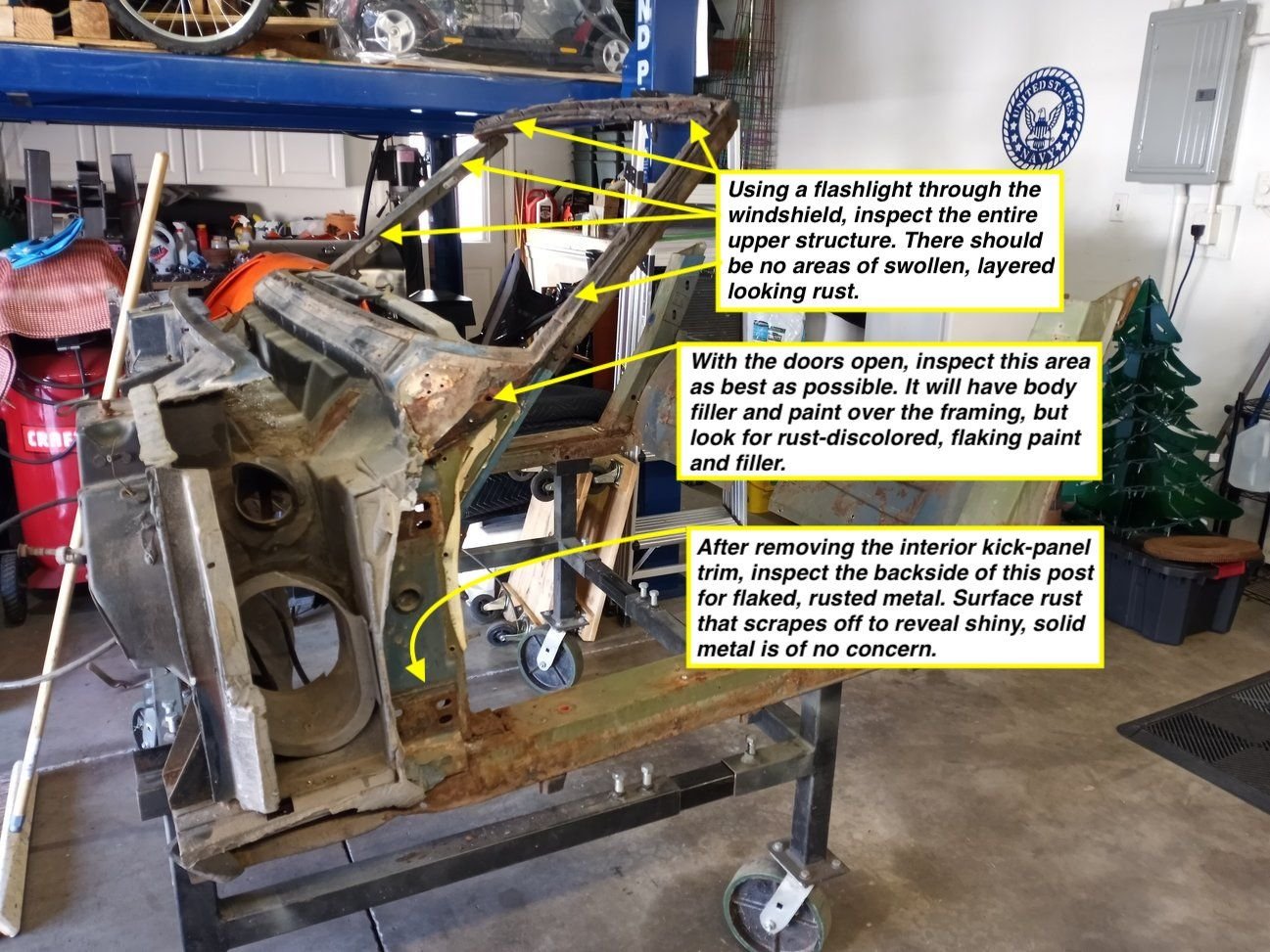

Back to the discussion at hand, David Howard just posted some great pictures, that I "stole", to illustrate the areas to examine and what they look like under the glass and trim.
https://www.corvetteforum.com/forums...storation.html
I added the text boxes and arrows to his pics:
