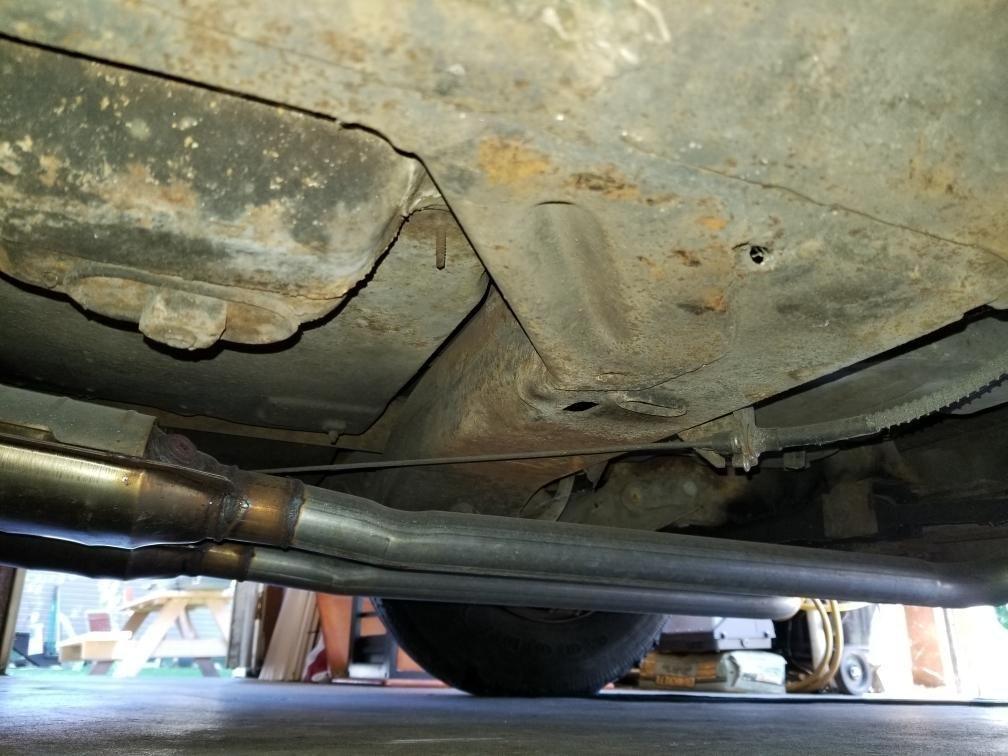

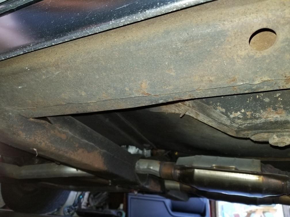

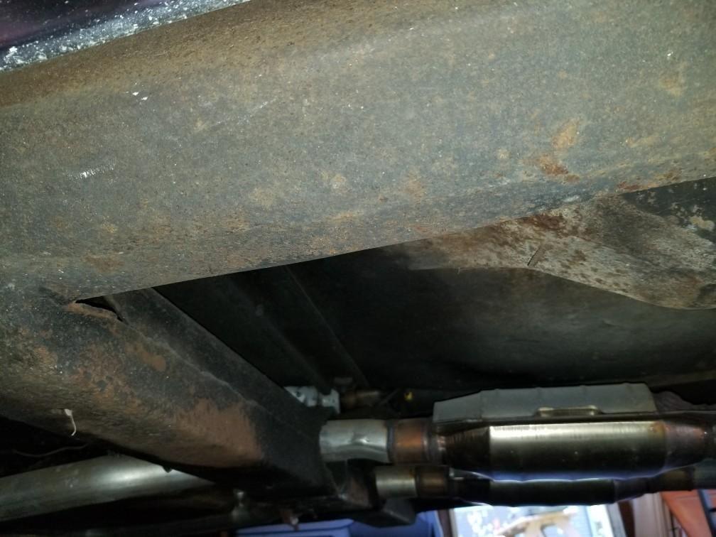

In the process of buying a 76 as my first and got these pictures of the frame. Still waiting on pictures of the birdcage from under the kick panels.

What I see in those pictures is nothing to be concerned about.

That is not rust to worry about.....believe me, it can be much worse. If that was blasted, it would look like new.

Looks better than mine, which I thought was pretty good when I bought it.

just a touch of surface rust nothing to be concerned of. the worst spot is usually inside behind the lower kick panels under the dash its the only area on my car thats kinda ugly.

Absolutely , wait for extra pics , those pics so far are not of the "normal rust areas " . While they look great , you can easily have rotted body mounts/windscreen surround in the bird cage as well on that car.

I see the same as others, very light surface rust. Look the birdcage over if you can. Then you'll have a complete picture.

That's just surface rust. Wait for the birdcage pictures to get a better understanding of condition.

Find the worst area of rusting on a frame member. Then grab a medium sized Philips screwdriver and stab it into that rusted area to see if it breaks thru the metal. If it doesn't, you don't have any serious rust problems underneath. Now, that is NOT to say that the windshield frame isn't in worse condition. But, not to worry....yet....
What I see in the photos does not appear much more than surface rust. After 40 years, I had more 'rust' than that....

True duals with cats! Someone has upgraded that car a bit.
Here's my 79 for comparison, with a similar frame and the same exhaust mod. I don't see anything to worry about.
Be sure to ask for photos inside the kickpanels, and a clear shot of the VIN tag (which can show rust around the window frame, plus you'll want to confirm the VIN).
