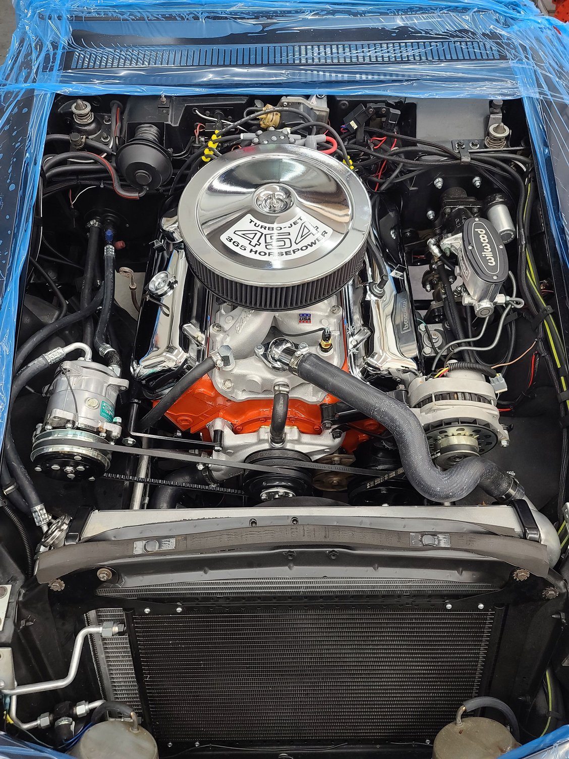

I just finished a 454 build for a member here. Will sent sent me his virgin LS5 short block as a starting point, I hot tanked it a magna fluxed it, checked out fine, did a full block prep, line honed it, bored it .060, TQ plate honed it, couldn't deck the block due to the numbers. I resized the rods and installed ARP bolts, small ends were checked for press. I installed my custom Race Tec pistons on the rods, after a pin fit. The crank was ground .010 .010 and to even out the stroke we ended up with a 3.990 stroke, not helpful when considering I couldn't cut the deck, which left me with 465 Cubic Inches. My custom hyd roller ground on a billet core was 580/600/228/238/111/106, Morel lifters were used, with a Rollmaster timing chain. 049 GM oval port heads were used with the usual work, Scorpion rocker arms with Smith Bros .083 wall moly pushrods, Comp cams guide plates along with AFR adjustable guide plates were used. A Performer RPM air gap with work and a AED 1000 carb with a 1 inch open spacer for induction. Factory Corvette oil pan with a windage tray, M77 oil pump with a heli arc oil pickup. Maxima 10-40 oil with a Wix 51061 filter, 91 octane gas.

Thanks Mark I can't wait to get it in the car.

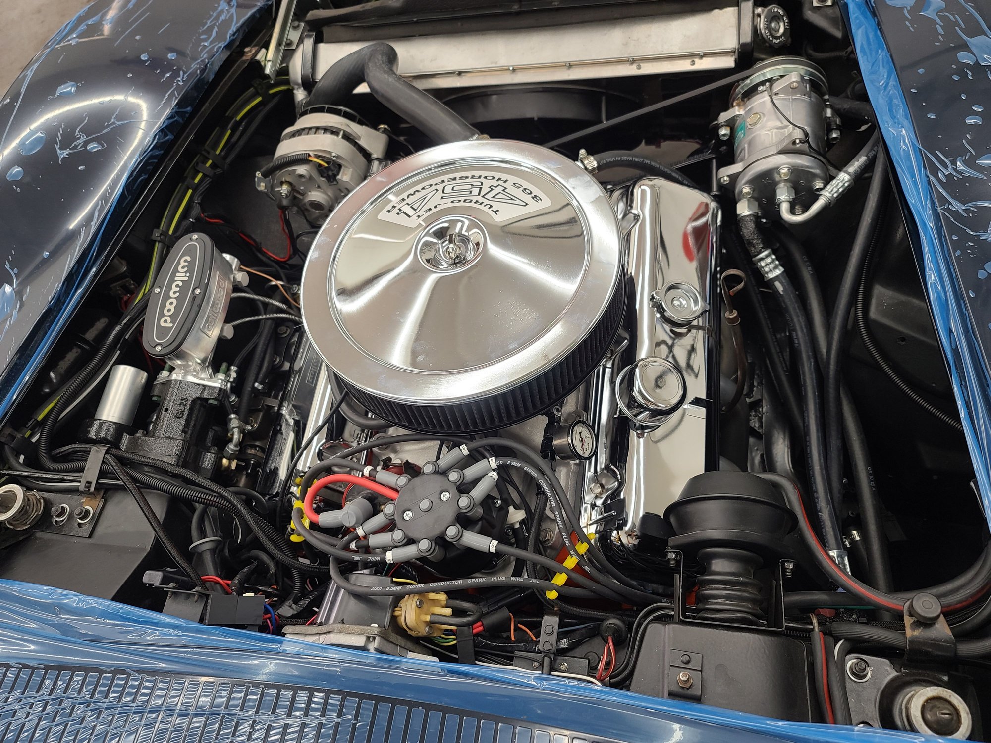

It in the car and started right up with no issues. I still have some tuning to do but all is good. Thanks Mark the engine looks great and will be right at home in its original engine bay.

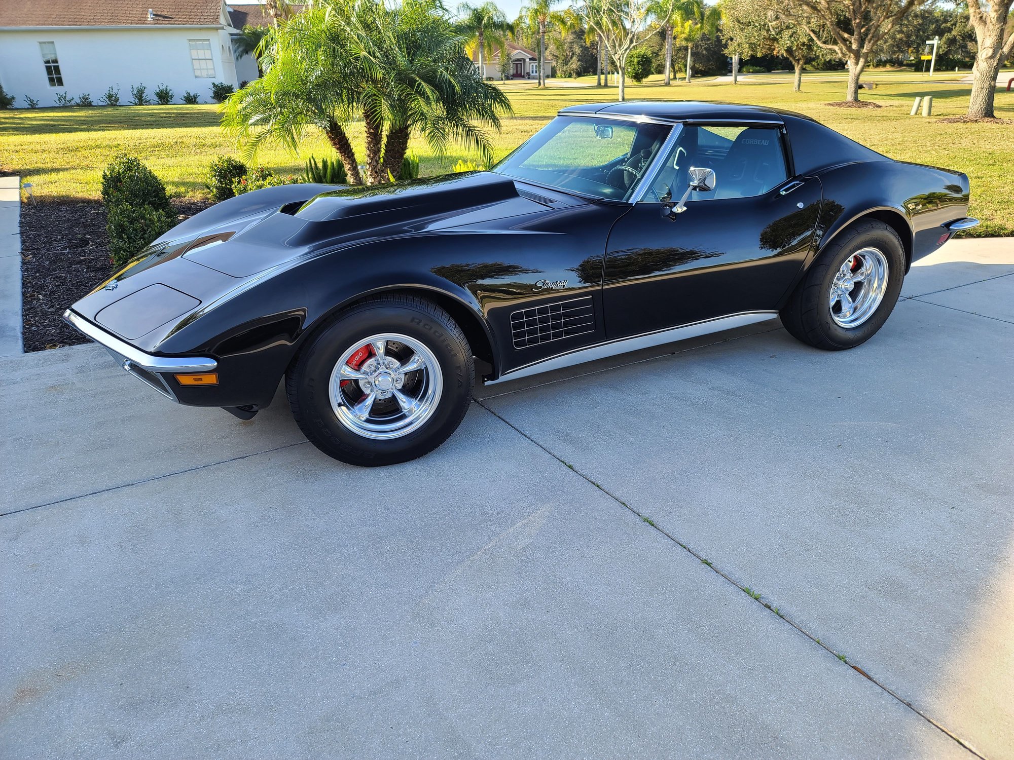

What hood are you running with that?
We need many videos too......!!!!!

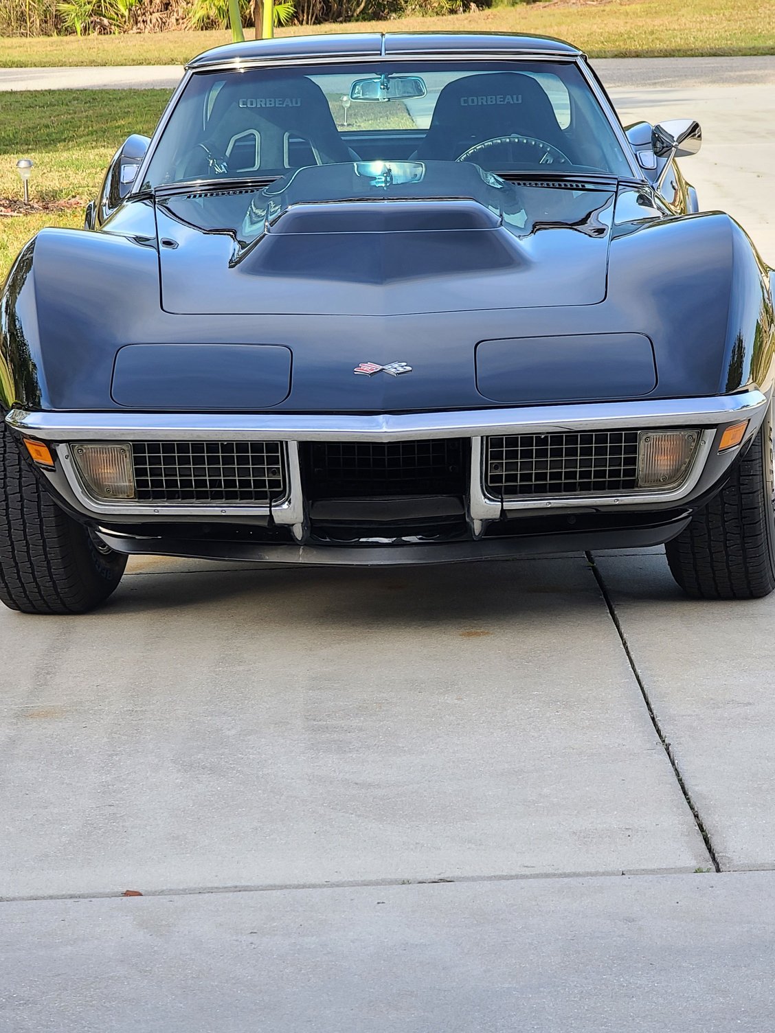

​​​​​​For this configuration I am running an aftermarket L88 hood. No clearance issues at all.

That looks like the tall L-88 hood from Elkers

Sweet engine! Please make a video of it running and driving.
