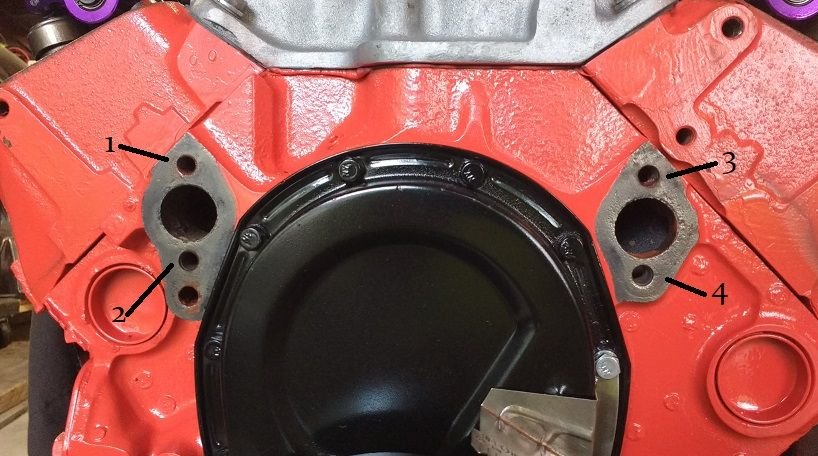

Would you do me a favor, just for my own education and enlightenment? - Take a look at post #6 in this thread:
https://www.corvetteforum.com/forums...ts-350-ci.html
...and when you're back with your car, would you let me know if you have the same 3 blind holes and the 1 that goes into the water jacket?

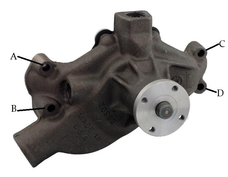

I was actually able to get back out there tonight and get some measurements
76 L48 block
Depths are as follows:
1 - 1 1/8"
2 - 1 1/8"
3 - 1"
4 - 1/2" of thread to water jacket / 1 1/2" to back of water jacket
Long style water pump
Thickness are as follows:
A - 1 1/8"
B - 2"
C - 7/8"
D - 1 1/8"
@Catfish4818 - Hole # 4 is the only one that enters the water jacket and is the only one that needs teflon tape / pipe dope / RTV

@bluthundr , thx for your confirmation on the water jacket hole; I appreciate it!
