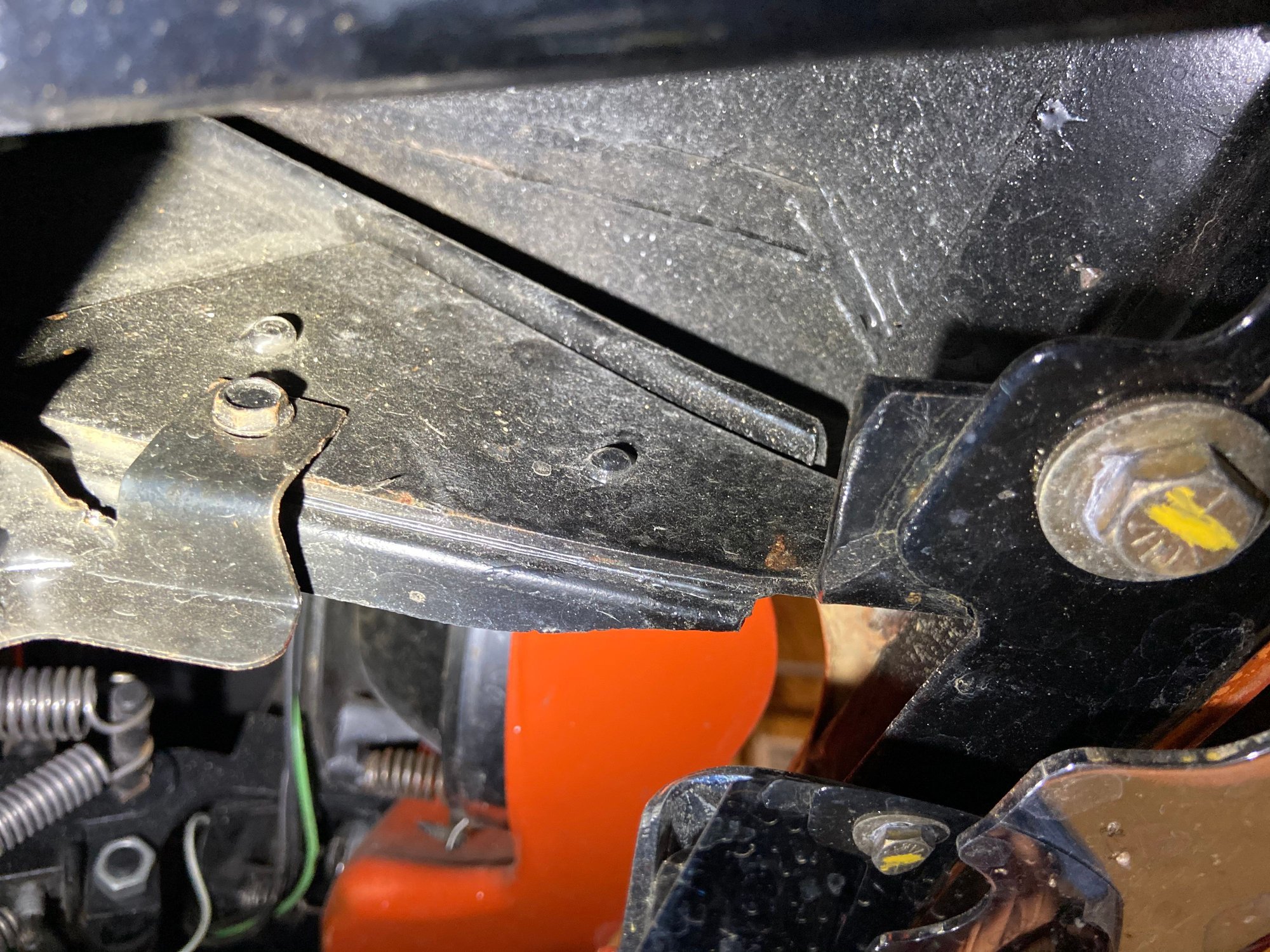

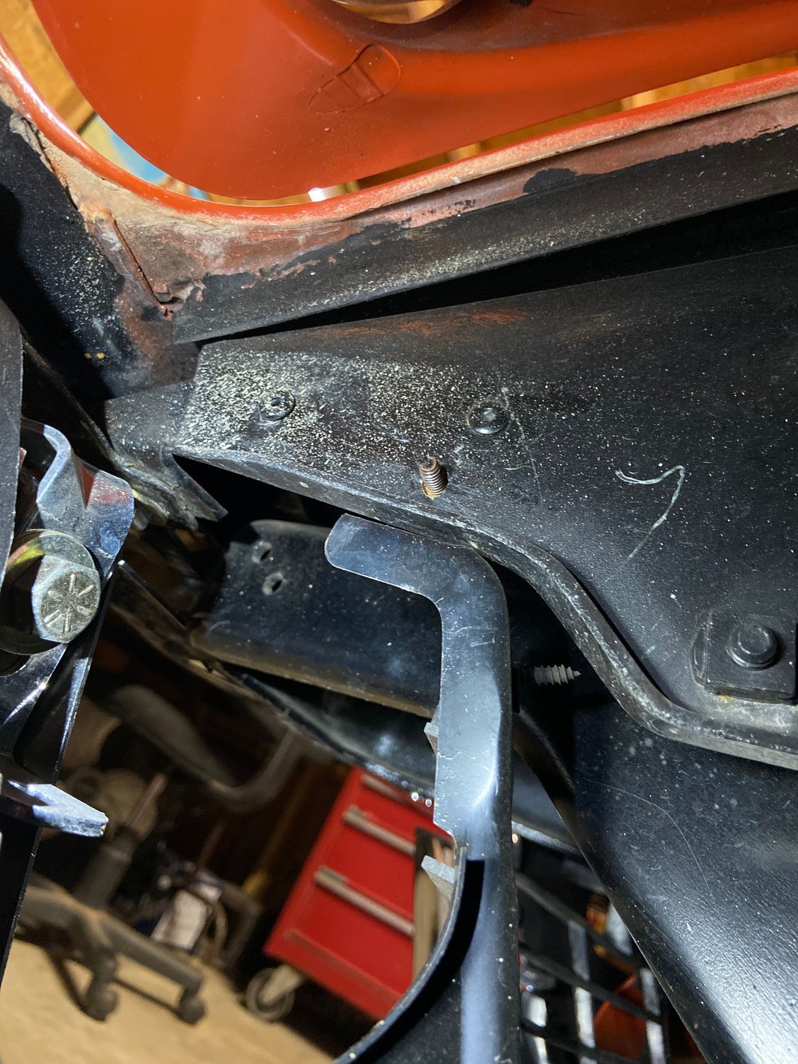

dont have a pic. but during my resto i had a similar missing piece. The units are quite expensive and i decided to fix it myself.
i used a piece of 3/16" (or 10 ga?) flat bar and cut it into a wedge shape to fit. i broke it around to accept the bolt , like to original. I was able top glue with epoxy and rivet the piece directly into place on the headlight support.
worked like a charm and saved my (iirc) like 300 bucks..
