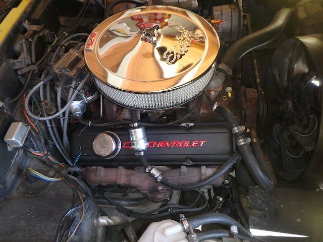

Originally Posted by hdeyong
FIX THAT FUEL LINE!!!! or MPG will be the lease of your concerns.
You want MPG, simple, TBI setup off of a 350 truck and a 700R-4.
There is a fair bit of clearance, but you're right, I'm fixing that right away.

not a fan of fuel line connections and filter hanging over the exhaust.
Filter closer to front of engine (vertical) and line away from exh is preferrable
As said a good tune, proper tire psi thats about as good as its going to get.
14-15 is awful good for a C3
