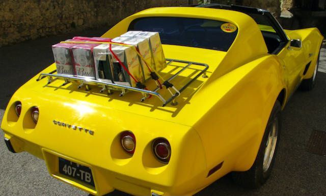

If you put the cases of beer behind the seat, you will pick up 0.5 mpg, in aerodynamics.
