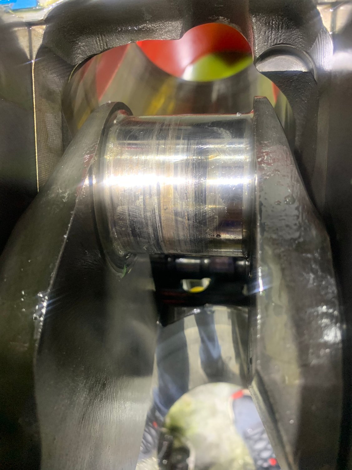

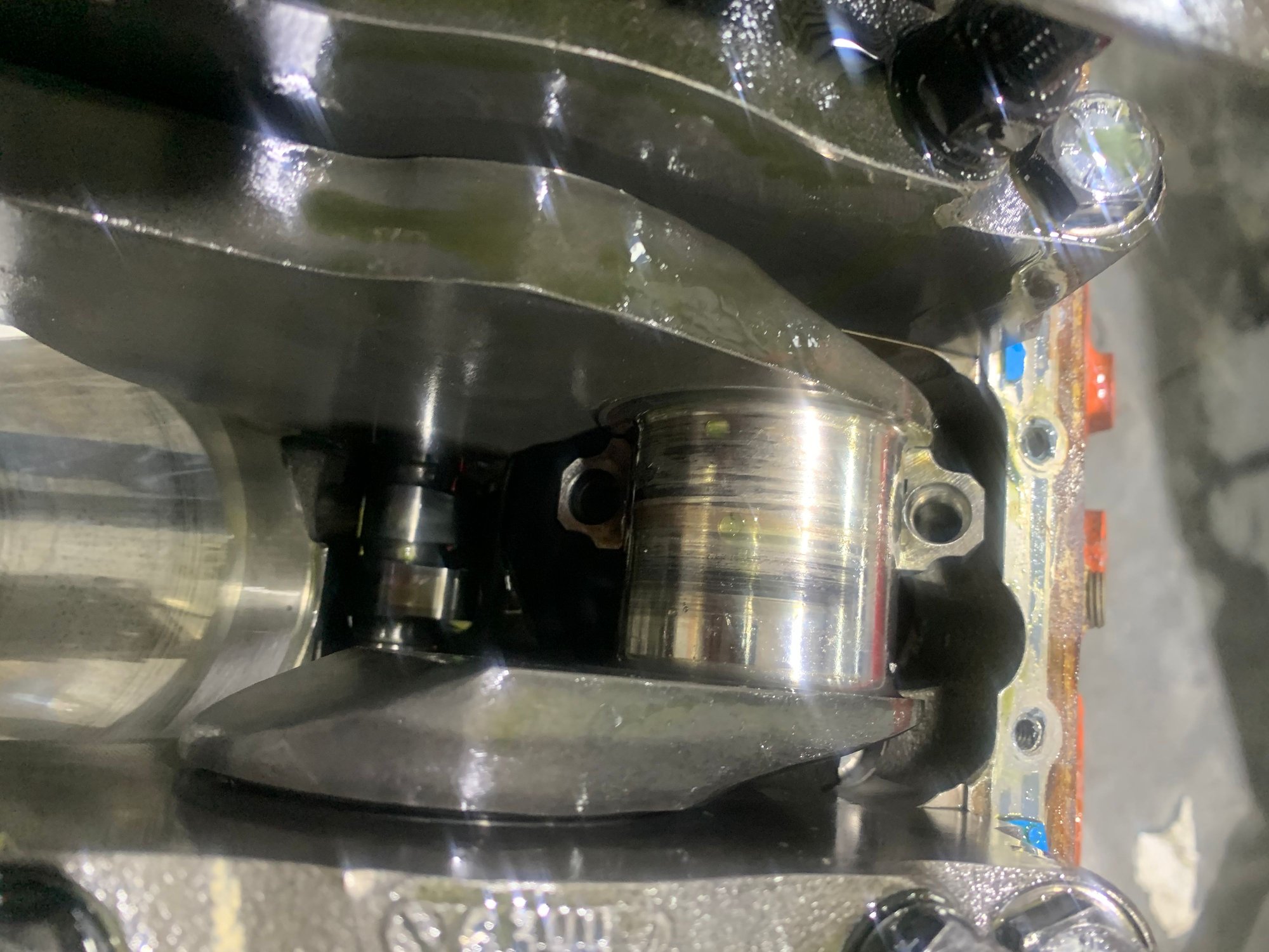

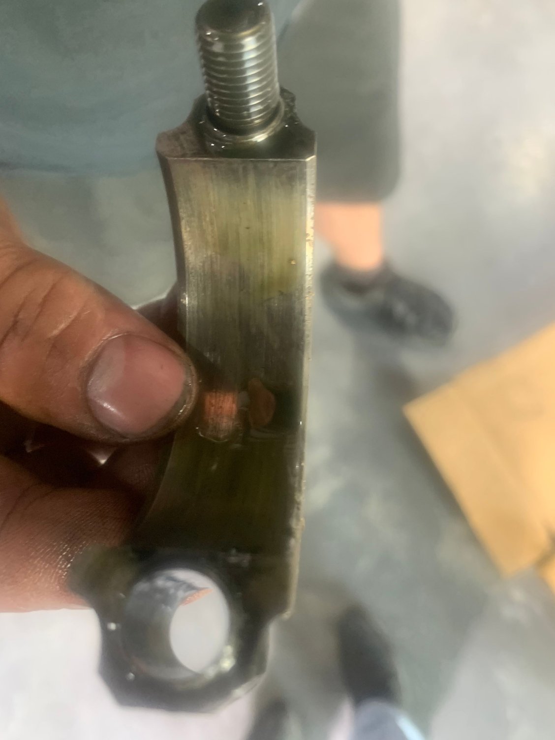

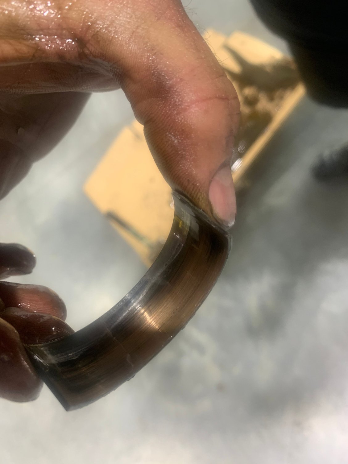

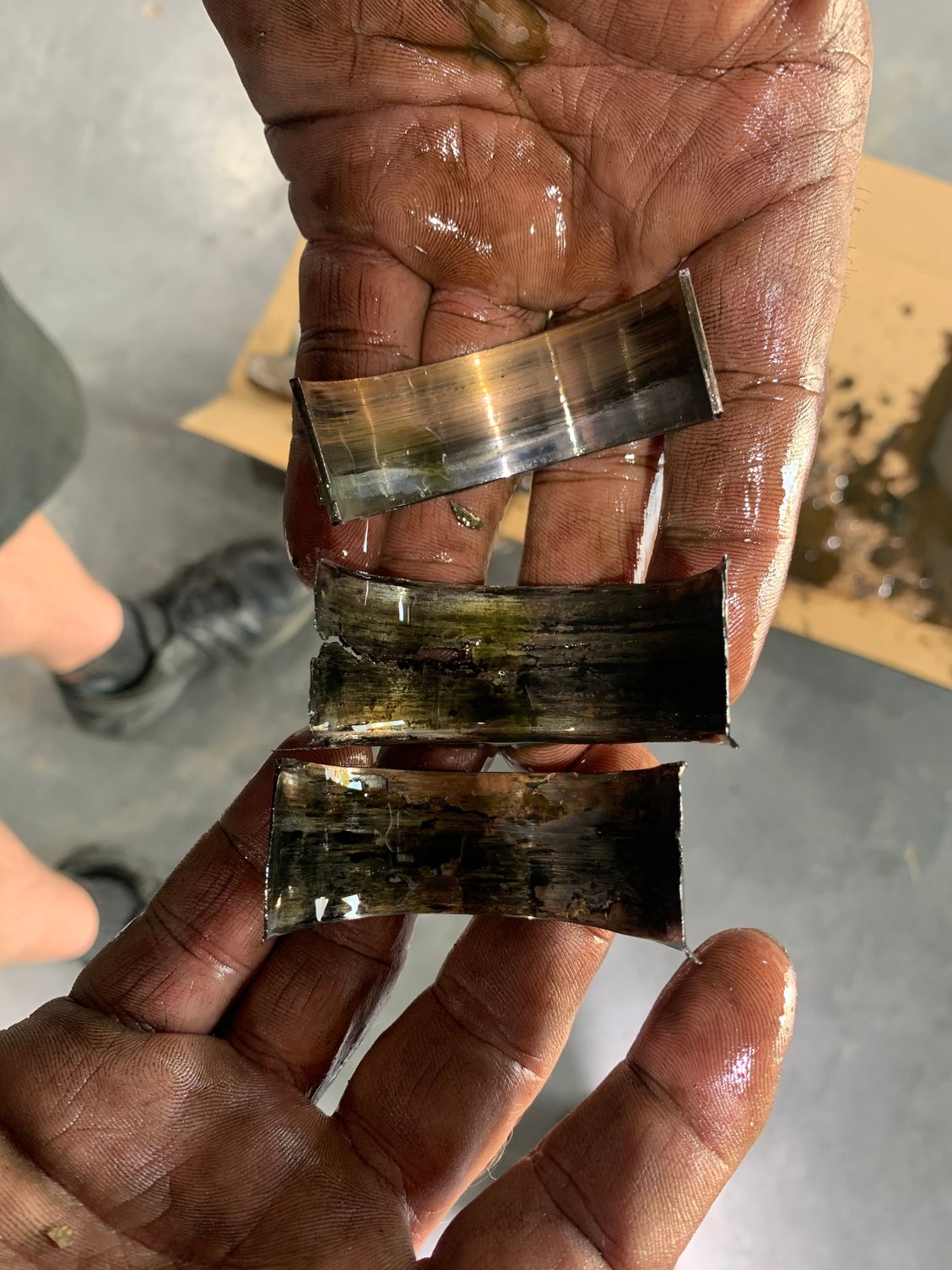

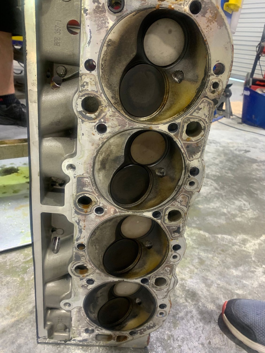

Here are some photos of the motor tear down. Rod bearings (#5 & 6) are in pretty bad shape. Damage to #6 rod cap and crankshaft. Cylinder heads showed no signs of damage.
Should have the motor back from the machine shop next week.
