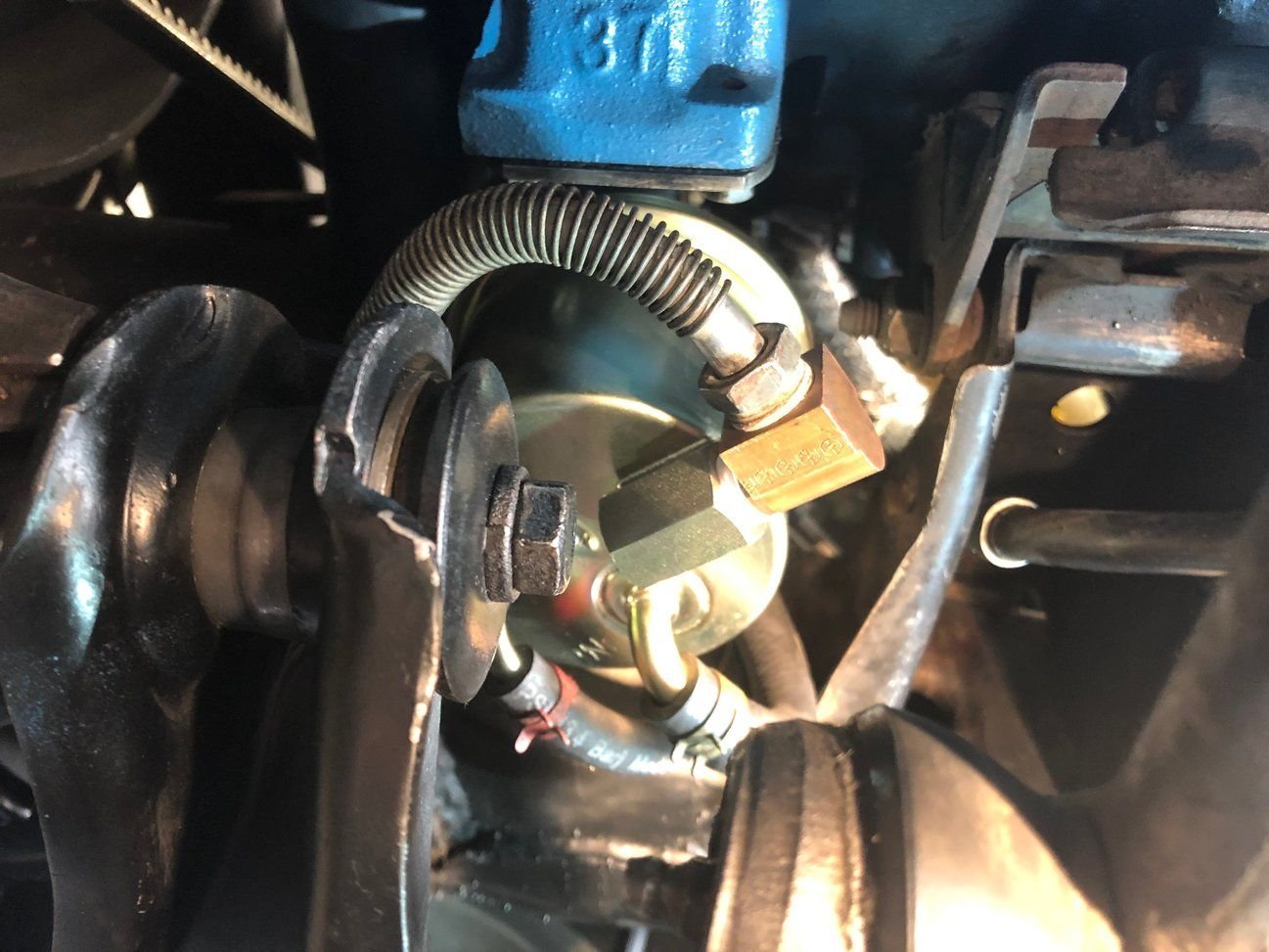

I started to play with look at the job today, just to see see what might be in the way. One thing that's OK, given being on the kwik-lift with the rear still on the floor but the front on the stands, it appears the to of the fuel in the tank is below the bottom of the pump which is 30" above the garage floor right now. So I shouldn't have to deal with fuel running out.
And then the first hitch, the armor on the S-line to the carb is so thick I can barely get a line wrench to clear it. And then when I do it barely seems to get on the fitting. Question one, is the fitting 5/8". That's the wrench I can get on it.
Second question, should I heat the fitting to break it free - just kidding, though it might be appropriate for the 4th .
Real second question, before I pull the tire to access things better will turning the steering right or left get the linkage out more out of the way so I have any more freedom to get a wrench up in there and turn it?

I used for the pump extensions and flex socket but memory thinks you can get on bolts..it is easier with wheel off and come from top and or outside..
the s hose question i do not understand..the s rubber hose is from line to pump.
if your talking metal line to carb..i dont remember difficulty and what flare wrench. You may need to bend to fit new pump as it likely will be shorter..maybe remove rubber first? Get ready for gas in lines..
should be clear shot? Leave 90 on the pump just take off steel line…swap 90 on new pump on bench, note location..when assembling start lines while pump loose so it threads easier…I don’t remember but may have removed from carb too..

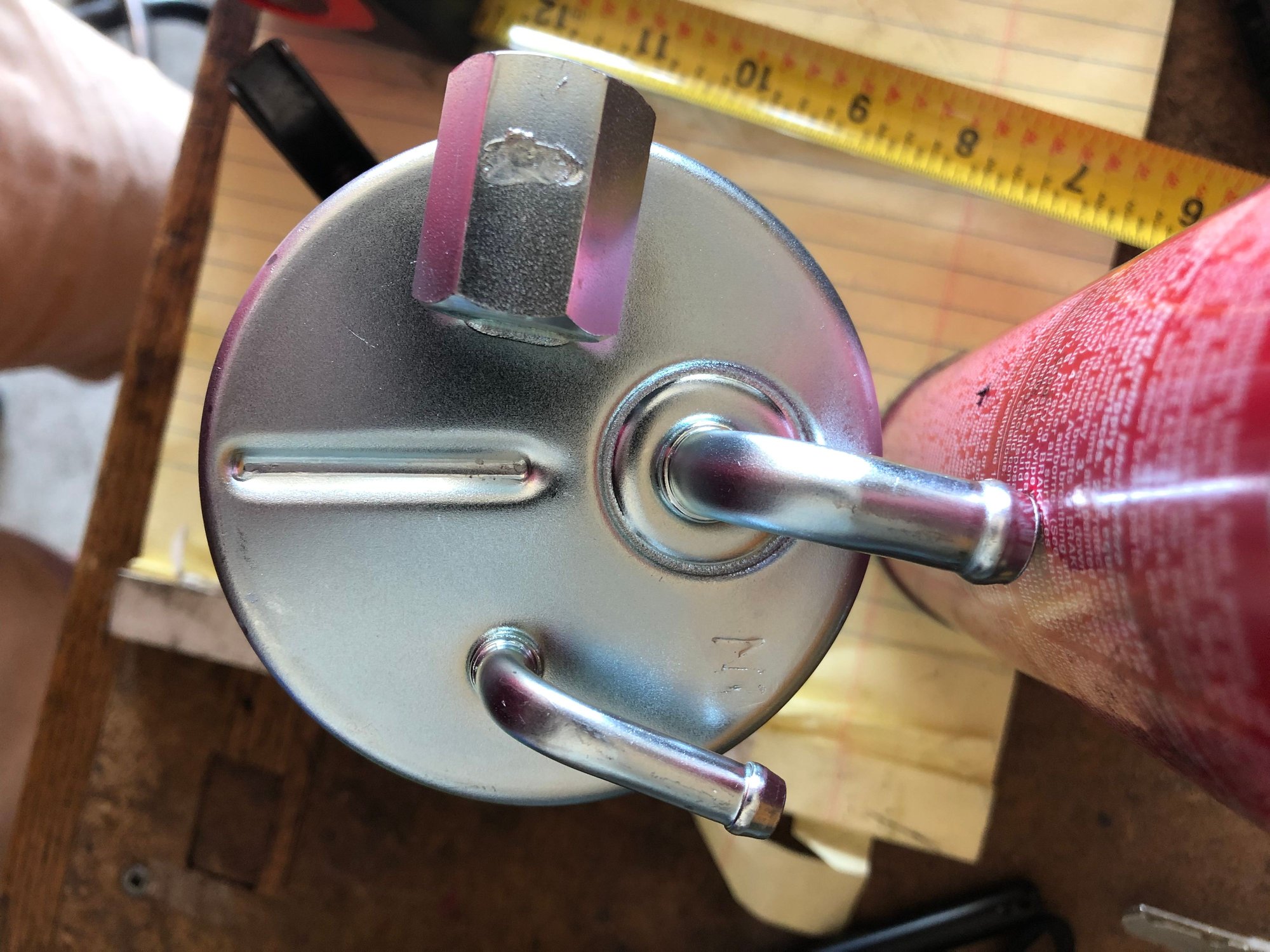

I am finding it impossible to get hold of the pushrod and lift it. It seems that the front is buried in the bottom corner of the backer plate. I cannot push it up toward the cam to get some distance between it and the backer plate so I can pull the front up.
I double checked the distributor position and it is pointing at the post for #1 cylinder. Am I missing something here?

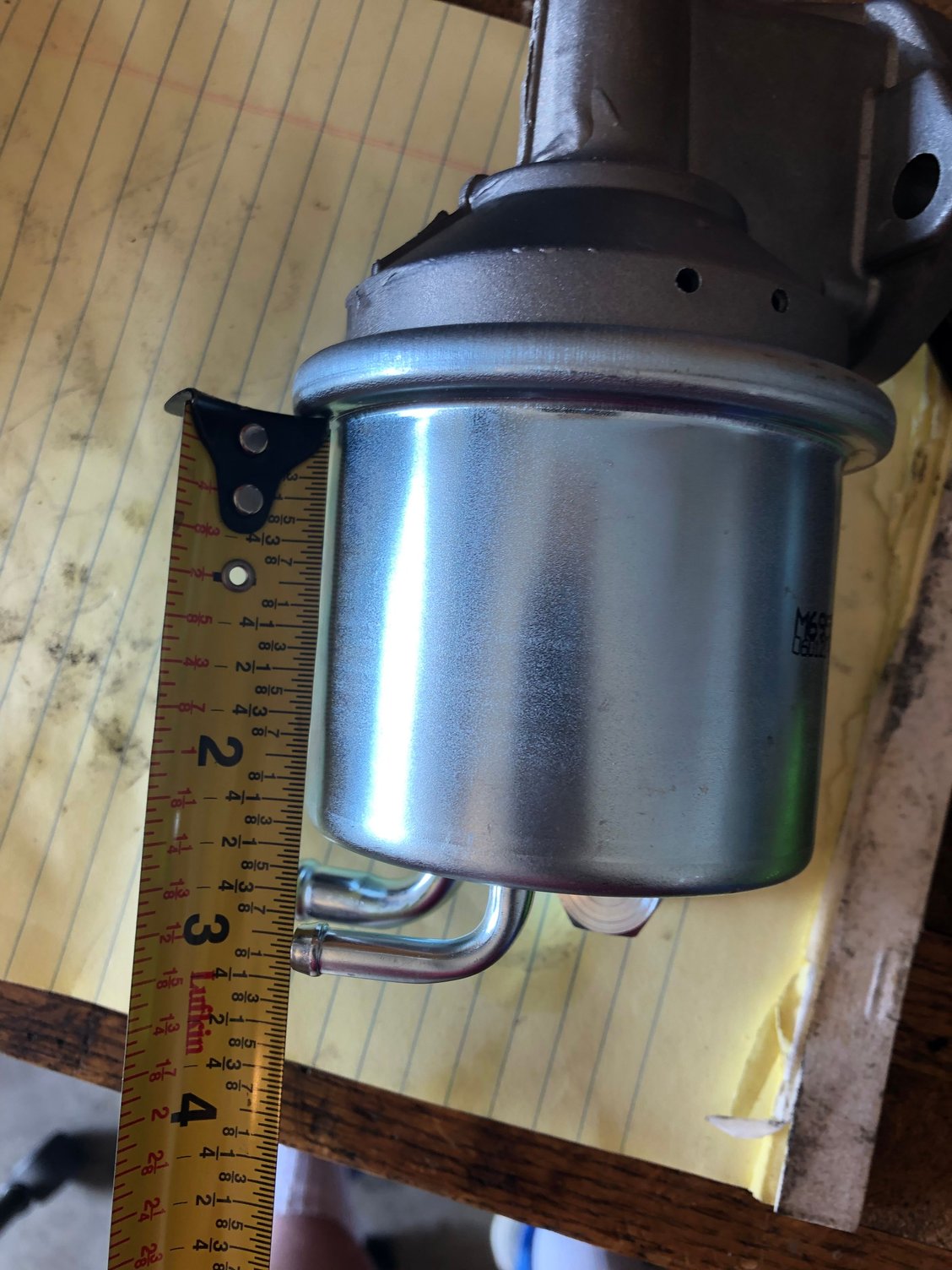

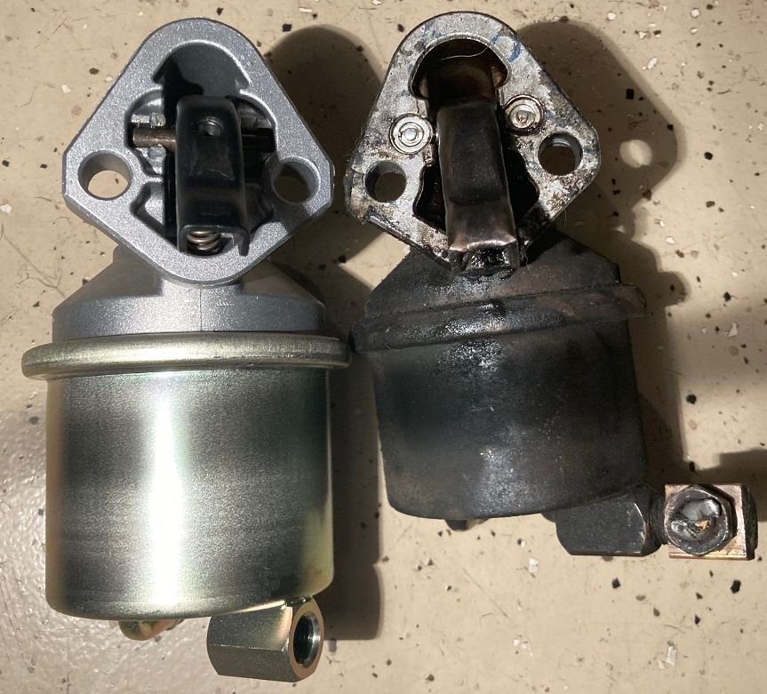

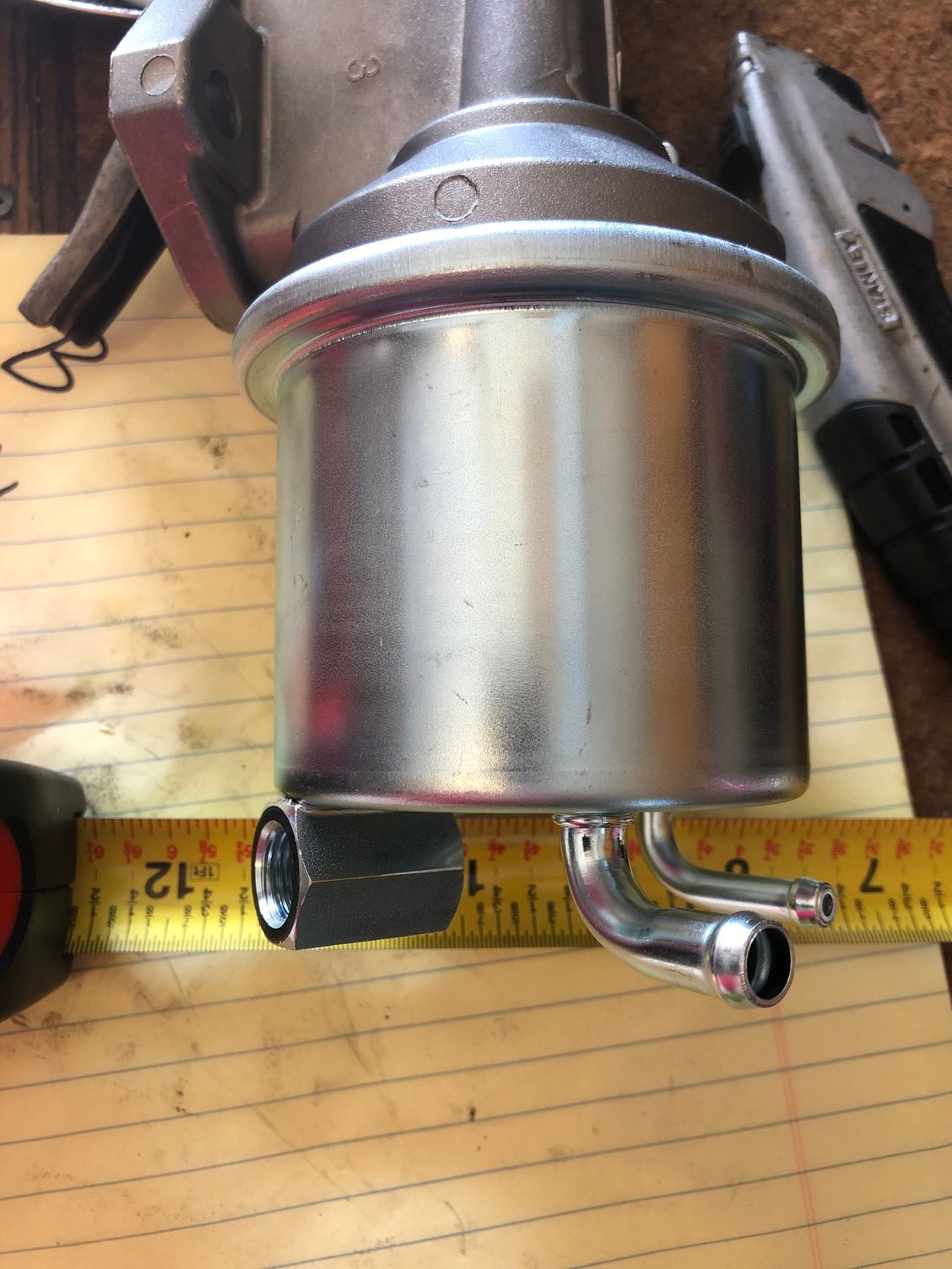

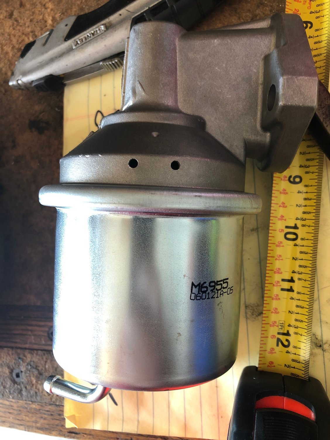

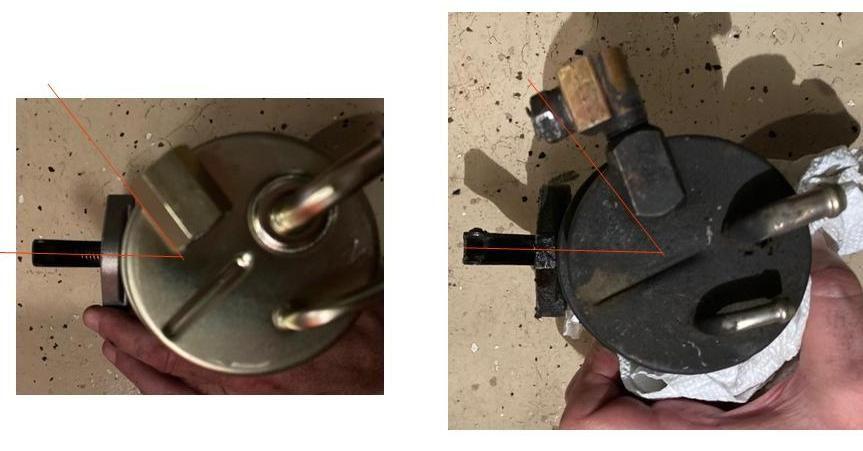

My other item is that now having the pump off I can see that the new one, an Airtex from Rock Auto, is about 1/2" longer than the old, i.e. the bottom extends lower on new than the old. Also, the clocking is a little different. I assume these issues will make it problematic to attache to a reproduction carb line. Any thoughts on one that might be closer to original?
clearly a different angle between the mount plate and line fitting.
As for any immediate sign of failure, nothing is obvious. I might try to sneak it into our CT X-ray for a look at it's innards.

Yeah, I figured that would be the quickest route, pull the plate, at least the quickest to deal with the rod. But as for getting the bolts back in with the pump in the way ...
Original note: "Anyway, on that Carter unit you have, could you measure the bottom from the crimp ring to the base to see if the height is closer to the original pump which is 1-15/16" from the bottom of the crimp ring to the bottom of the reservoir."
Now: I don't think you need you to check. I'm pretty sure that despite coming in an Airtex box, the part Rock Auto sent me is a Carter pump as it had the Carter p/n on the part. These guys don't even bother putting their names on them anymore.
So now I guess I start driving from parts store to parts store until I find one that matches. On the bright side, the fuel line from Inline looks exact.
you seen my threads trying to find one…even an alarm on ebay…same ole crap
