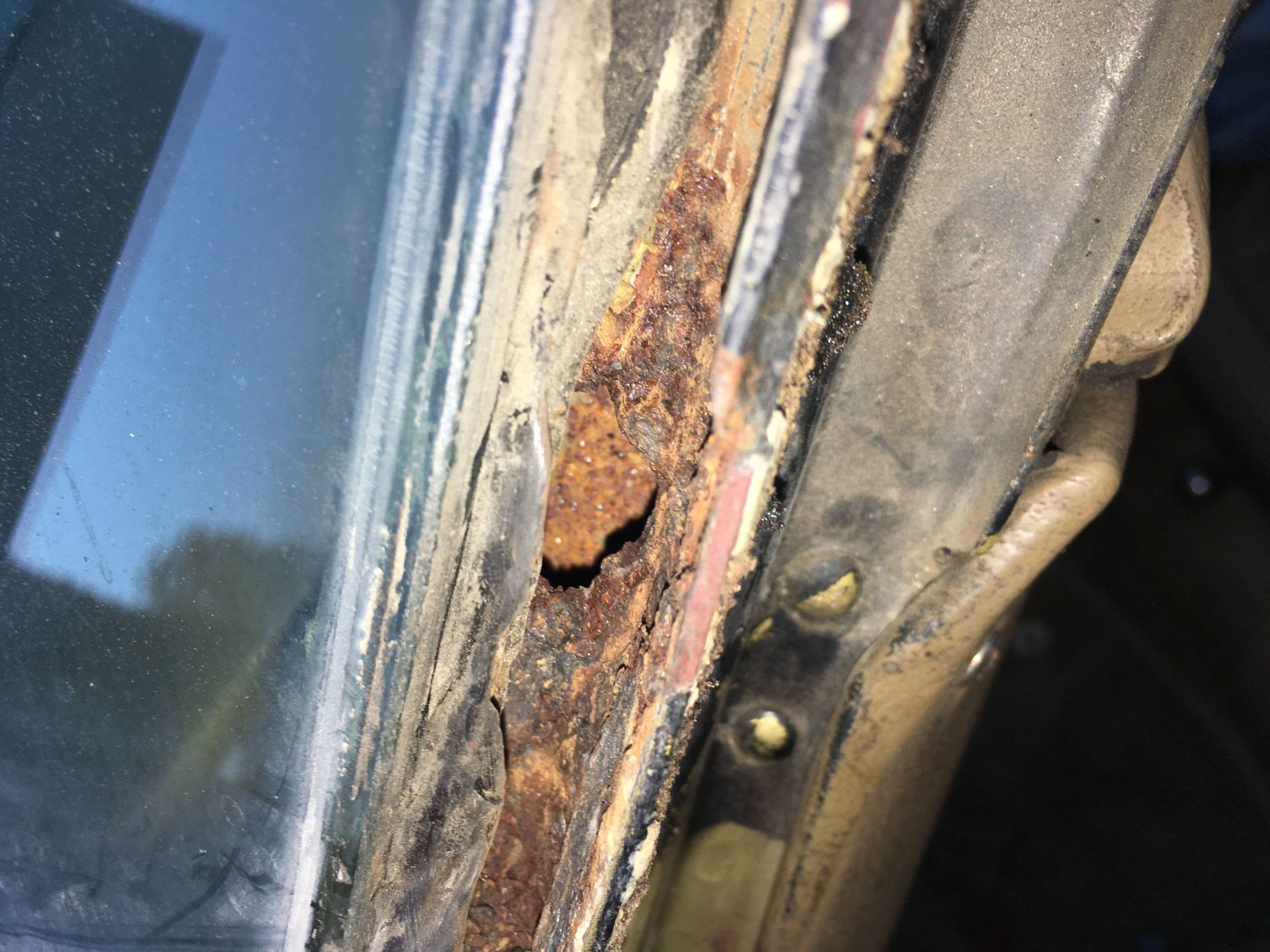

That remains to be seen
The big question is can the holes near the base of the A pillar be repaired?
Pics to come

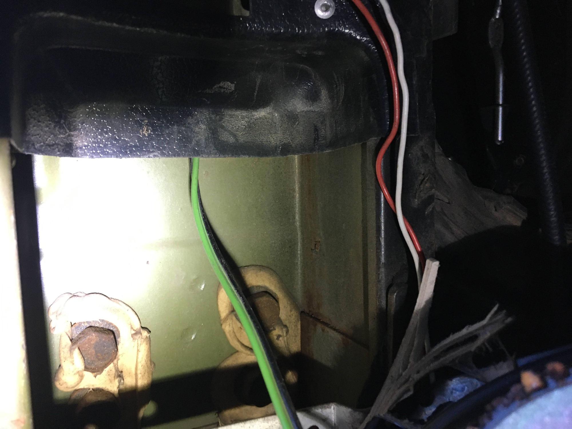

As mentioned above, tonight I kept looking at the windshield surround by the A pillar and below
This is the worst hole at the base

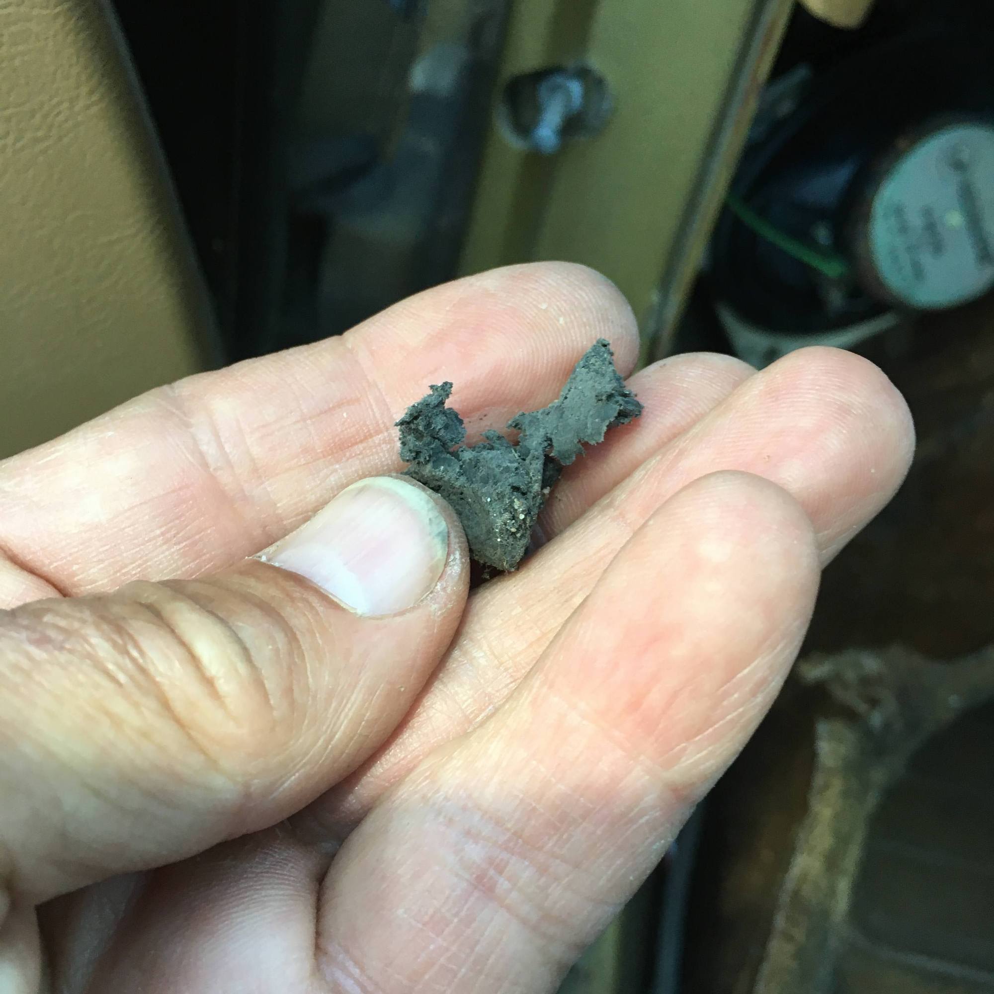

Below the windshield where the fiberglass fender ends there is a flap that can be seen through the door jamb
It was filled with what I call dum dum, kind of a sticky clay.
I dug some out to see what the metal underneath looked like
It looked pretty solid and you could still see some green
I couldn't do this on the other side because the flap was folded inward when they did the fender repairs
But speaking of green, I pulled the driver side kick panel to see the bottom of the birdcage
And I fired up the engine and tested the headlights
More fun tomorrow
