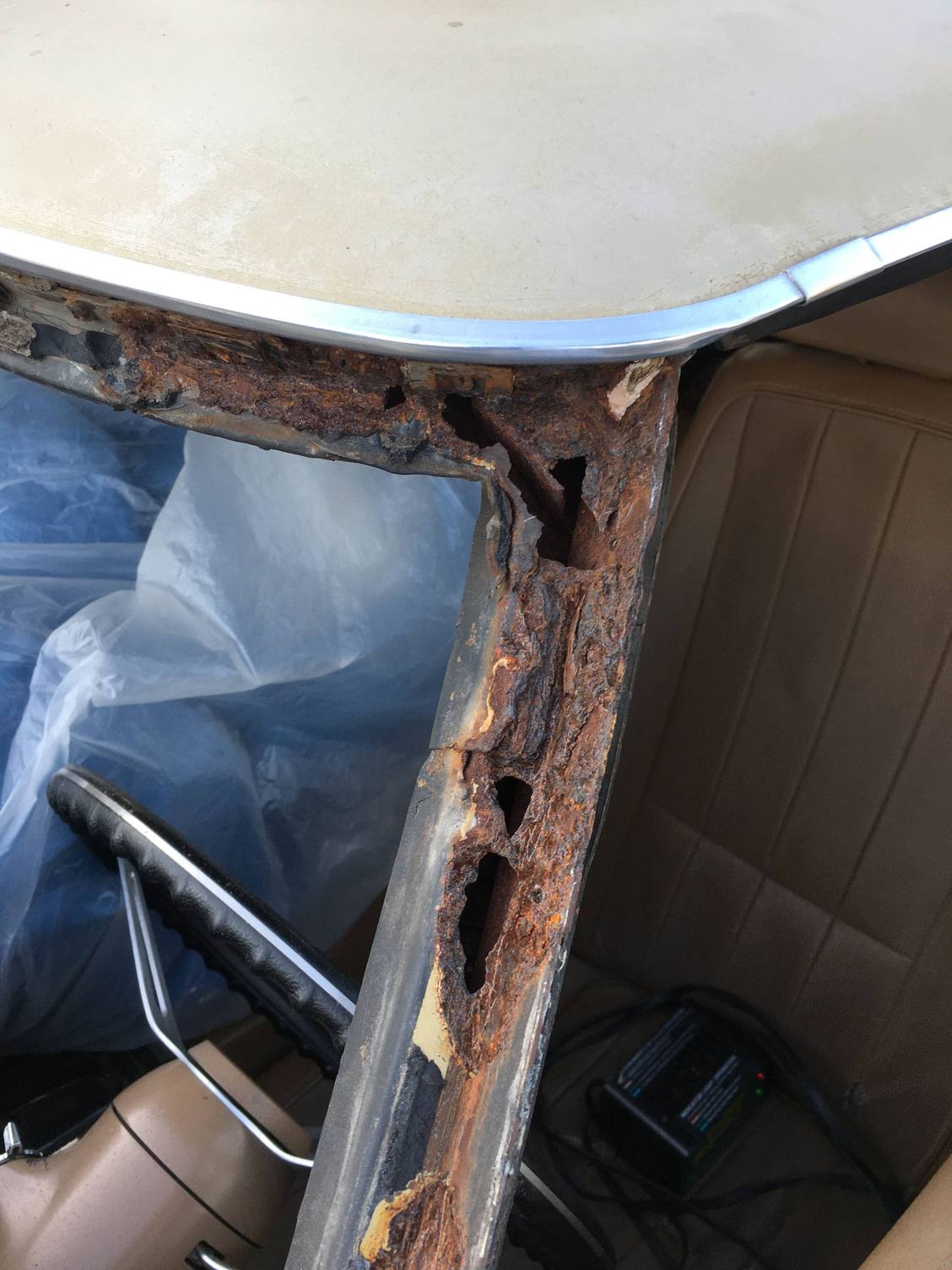

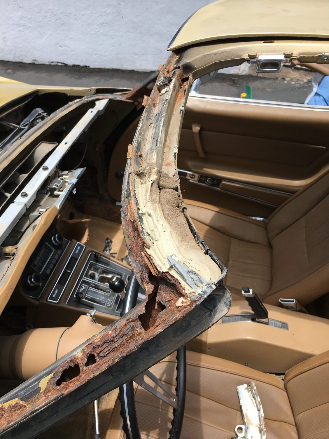

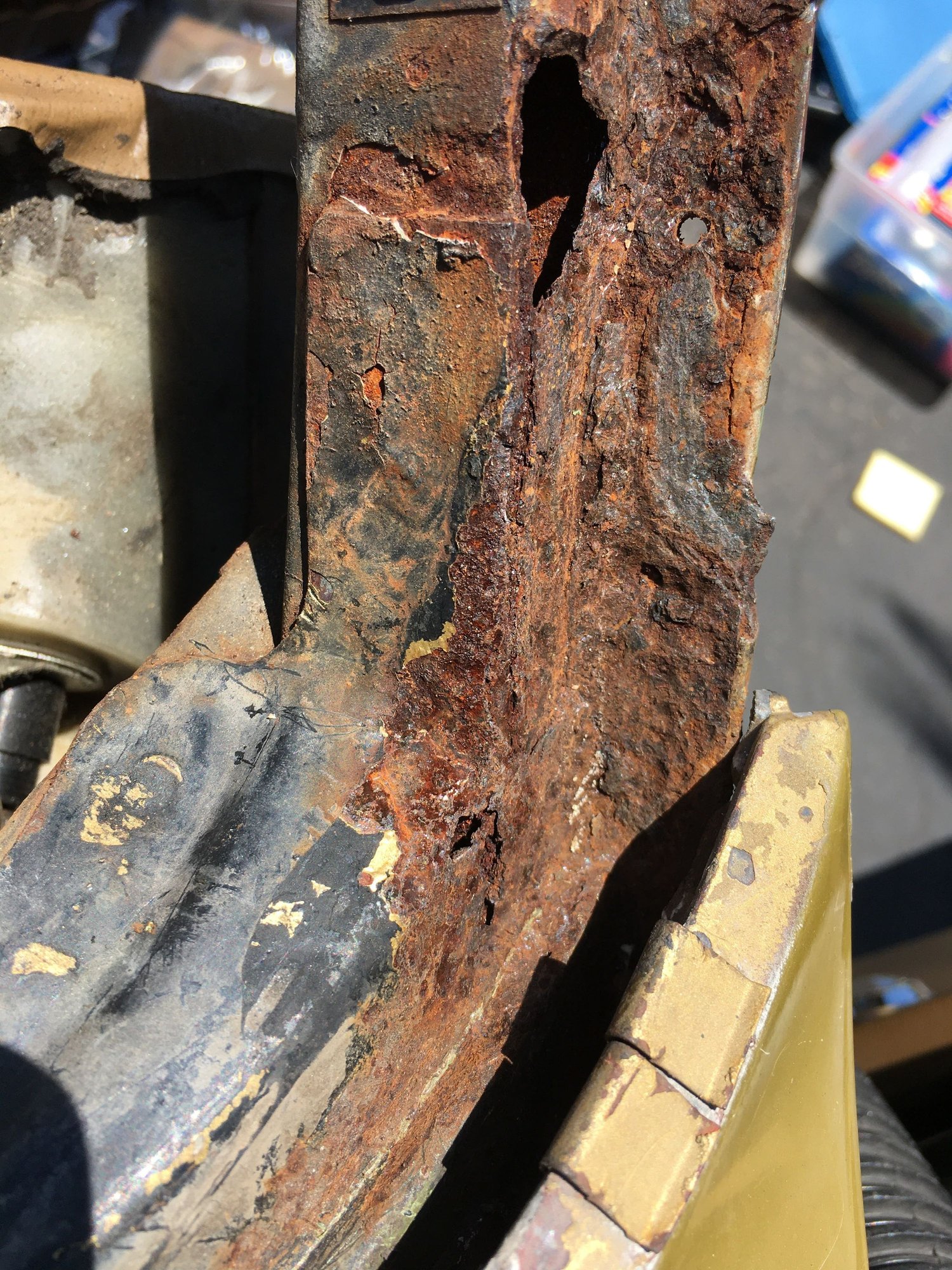

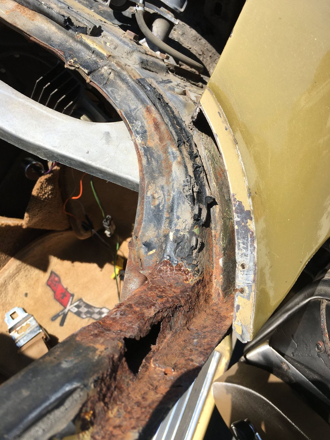

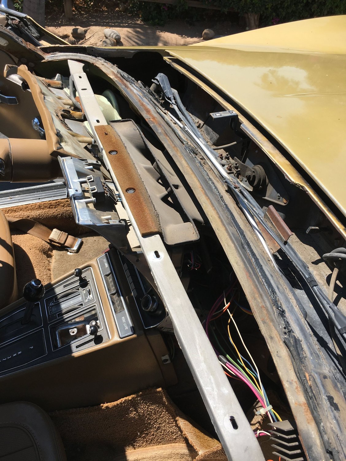

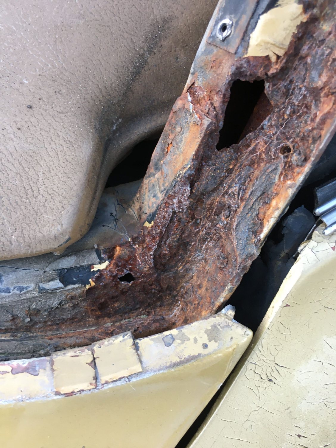

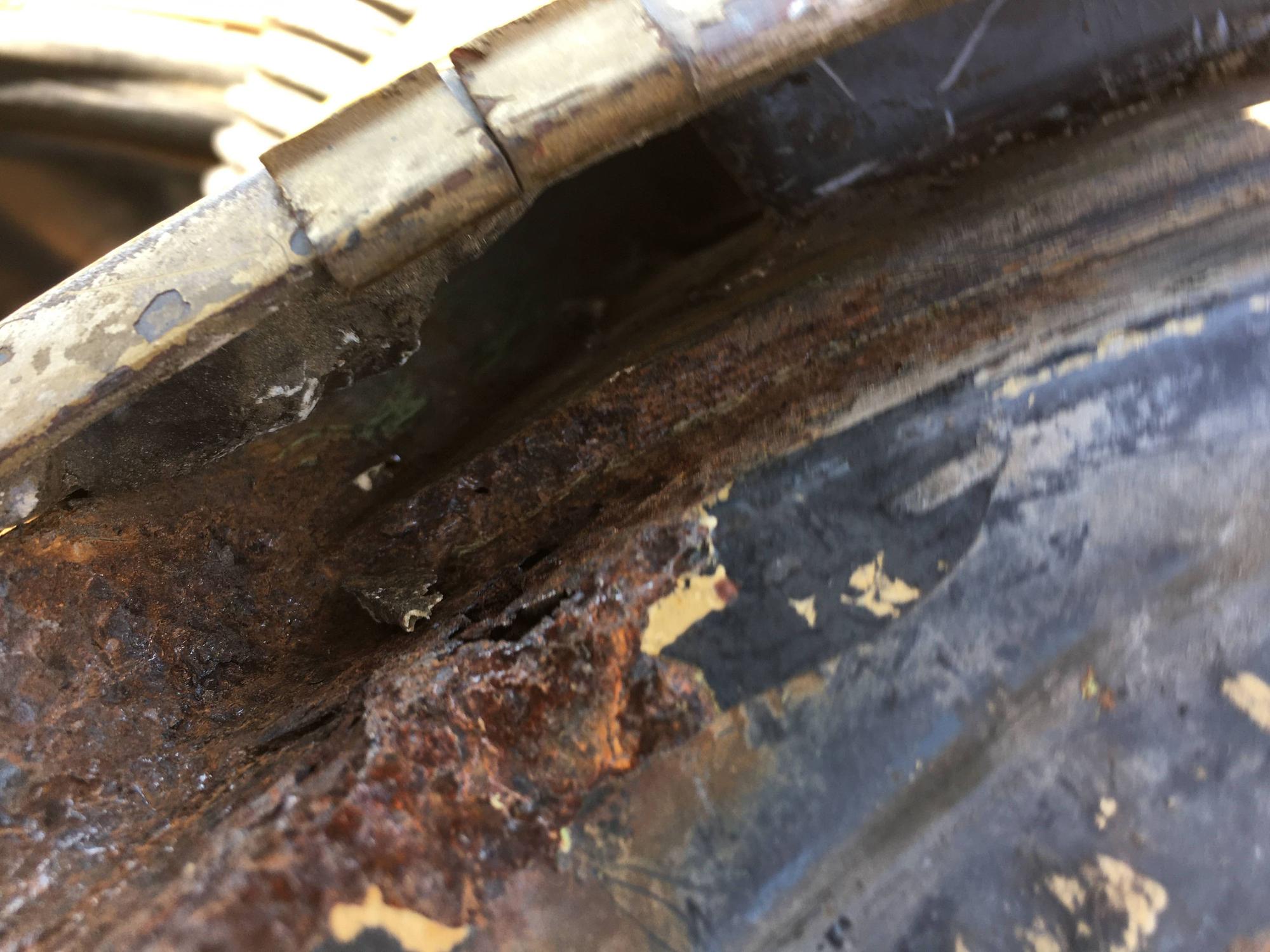

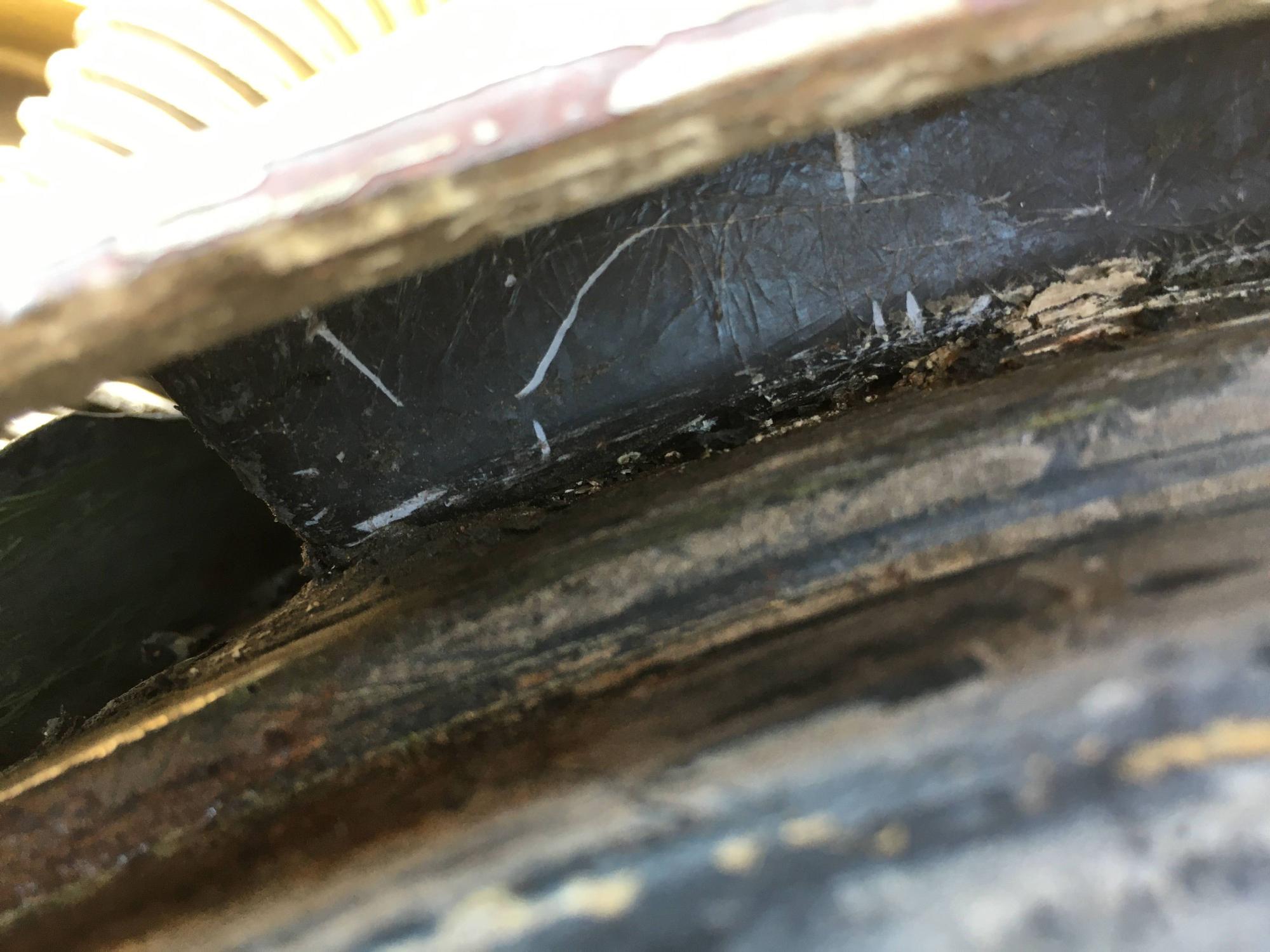

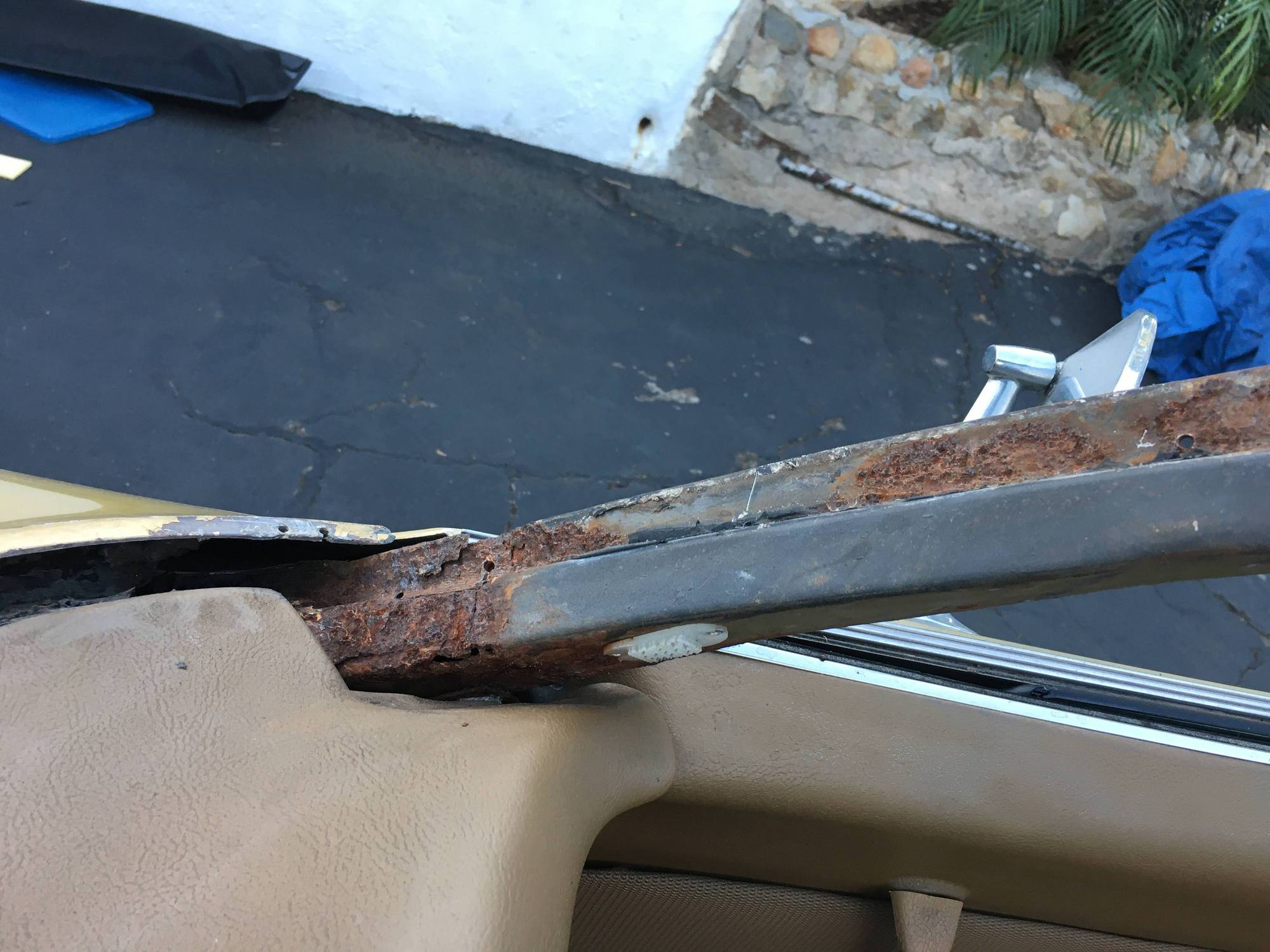

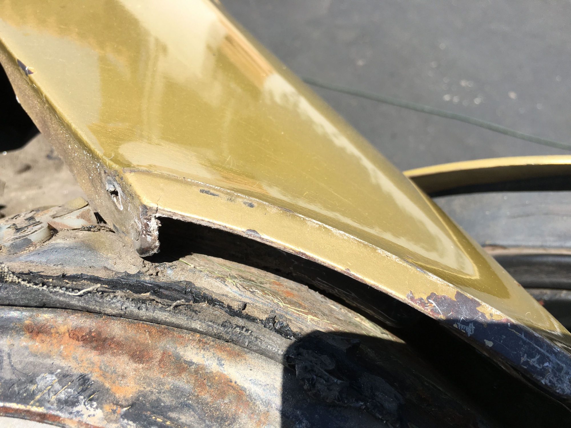

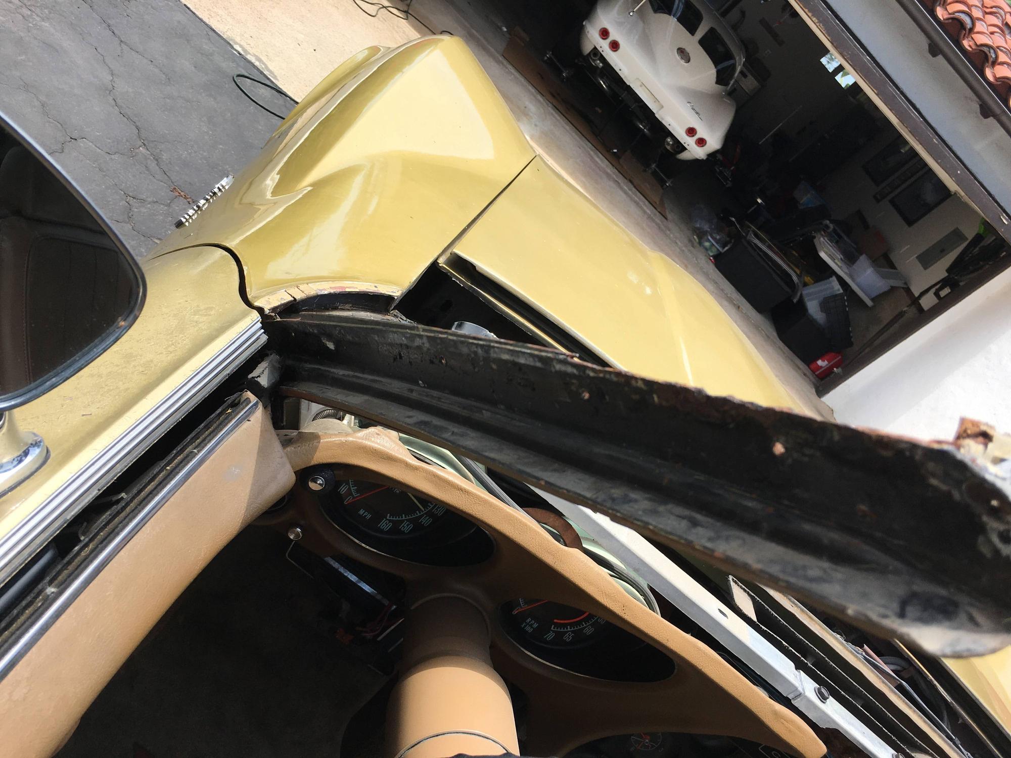

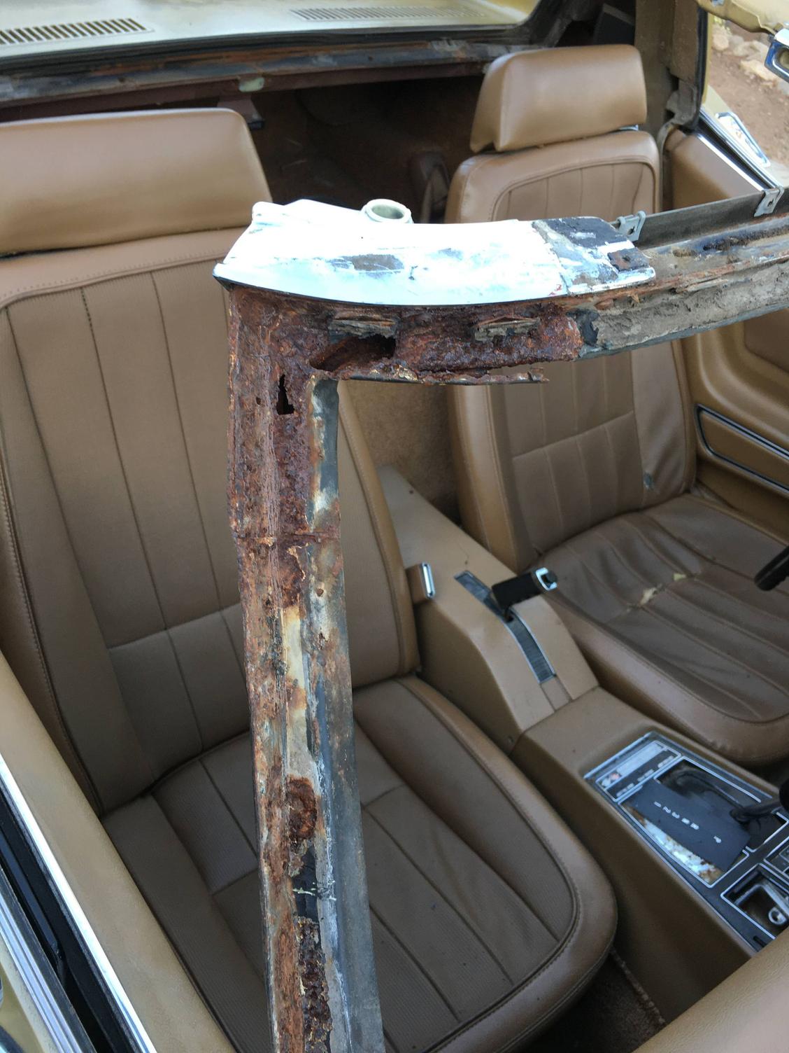

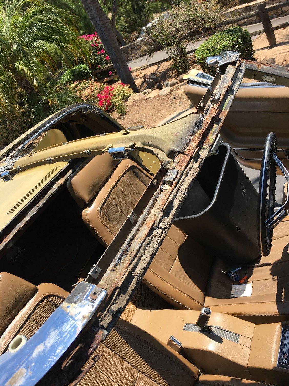

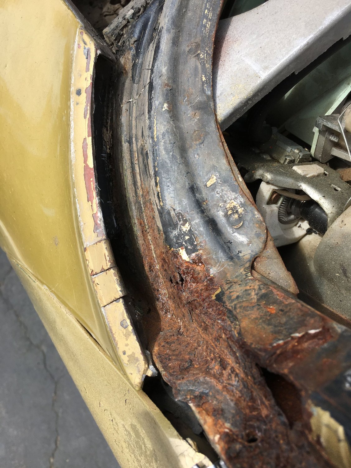

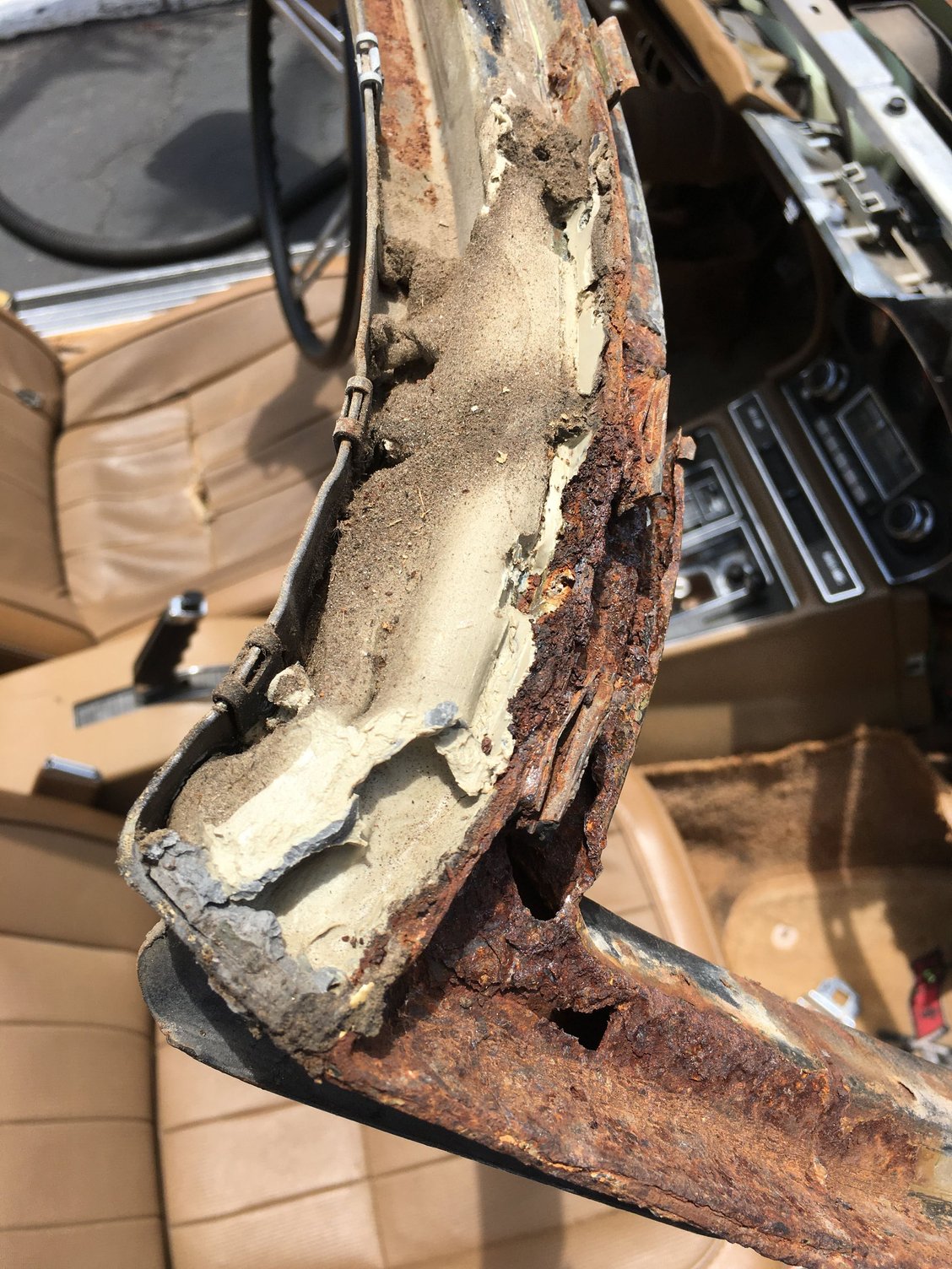

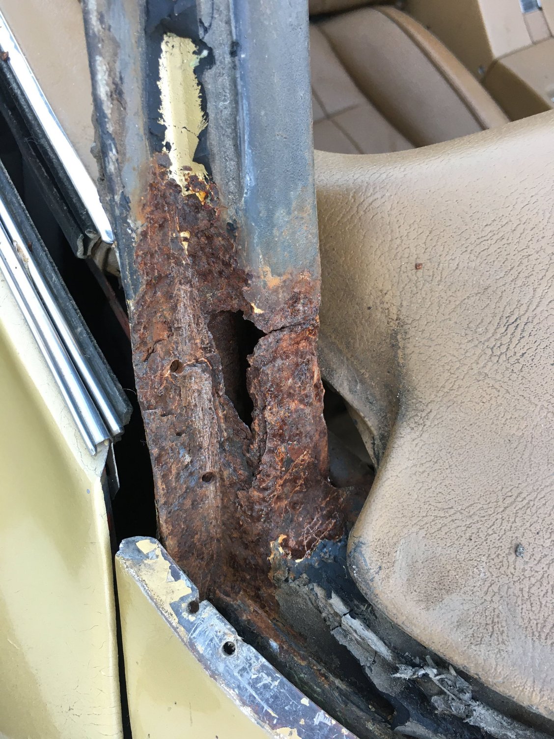

Well my friends, the discovery phase is pretty much done
As suggested above, I stripped everything away from the windshield surround part of the birdcage
The above the fender A pillars are nasty, the corners are nasty
The back of the T bar is solid
The lower birdcage under the fender down is solid
The huge question is, can that area at the fender be repaired without pulling the fender or front clip?
And for how much?
Here are the pics
Sorry they are not in the correct order buy you get feel

Is a little bit more rusty than my 69's windshield frame, but it's definitely worth fixing. The rust appears to be confined to the uprights and header area, so a new windshield frame should do the trick. I went ahead and had my windshield area fixed since I figured any other
69 except for the show cars would be in similar condition, or maybe much worse. A Corvette guy I know around here told me probably every C3 that saw any use will have windshield area cancer. I figured that it might as well be done and than you will know it is good and sturdy. Besides, the old windshield had some bad scratches and a 69 roadster was well worth keeping.

funny, my 75 vert is in worse shape all around, but my windshield frame is way better than that. maybe they figured out a few details to improve the longevity of the windshield frame in the early 70's.

Sorry to see all of that, over my personal limit for cut and fit patches, I think. And, if you took a dremel tool and cut back to good metal to patch, these holes are likely going to double and triple in size so it gets worse, me thinks.
FWIW, on my 68 I am working on I had an area at the base of the RH a pillar that my welder could not access. I elected to cut the upper RH fender piece out instead of removing the front clip. I have removed a front clip off a 69 and as you likely know it is a lot of work plus it is a challenge to remove a front clip without some fiberglass damage somewhere. I fiberglassed the cut out piece back on and VPA'd back to original profile and to me that was a lot better than the clip removal route. I suppose it depends on how much weld repair access you need as to whether you can get away with the cutout route.
All the best with whatever you decide. And as above, if you have a good title and the rest of the frame is good, I would still fix it, but maybe not the best money route forward for a base auto as Greg says.

I'm thinking REPO parts, POR-15 and JB Weld. Replace the worst of the worst with new metal, POR-15 everything and use JD Weld as a filler. Sand smooth and call it a fun daily driver.

No offence intended Glenn but I think those offers are pretty fair for the car being offered. That's about the max that I'd want to be in on this one, if not lower.
And by your own admission in post number 6 you said: "
Then this fell into my lap super cheap."
So if $10K is your hard line number to sell the car as your craigslist ad says now, I think the only way left to go is to do the repair.
I believe you're overthinking this one and talking yourself out of the battle before it's begun. All you seem to need is a kick in the *** to get you started. This is a simple labor job. Having been there before, here's what I would do again; Buy a decent used windshield frame. They're plentiful, affordable and readily available. The car needs complete paint anyway so section off both upper fender tips (only 6 or 8 inches) to access the lower area clearly just as 20merc said. Then grind/wire wheel all of it down to bare metal to find the true core strength. Section in (weld), piece by piece exactly and only the pieces needed. Fill rough spots with JB metal weld or similar. This will leave the best integrity of the original frame and once done, be as good as new. This is a little time consuming on the welding part but it's only labor, parts cost is very minimal. Glass the fender tips back on, ready for paint, Bingo!
You can have this job finished in one day and for a few hundred, not thousands of dollars.
