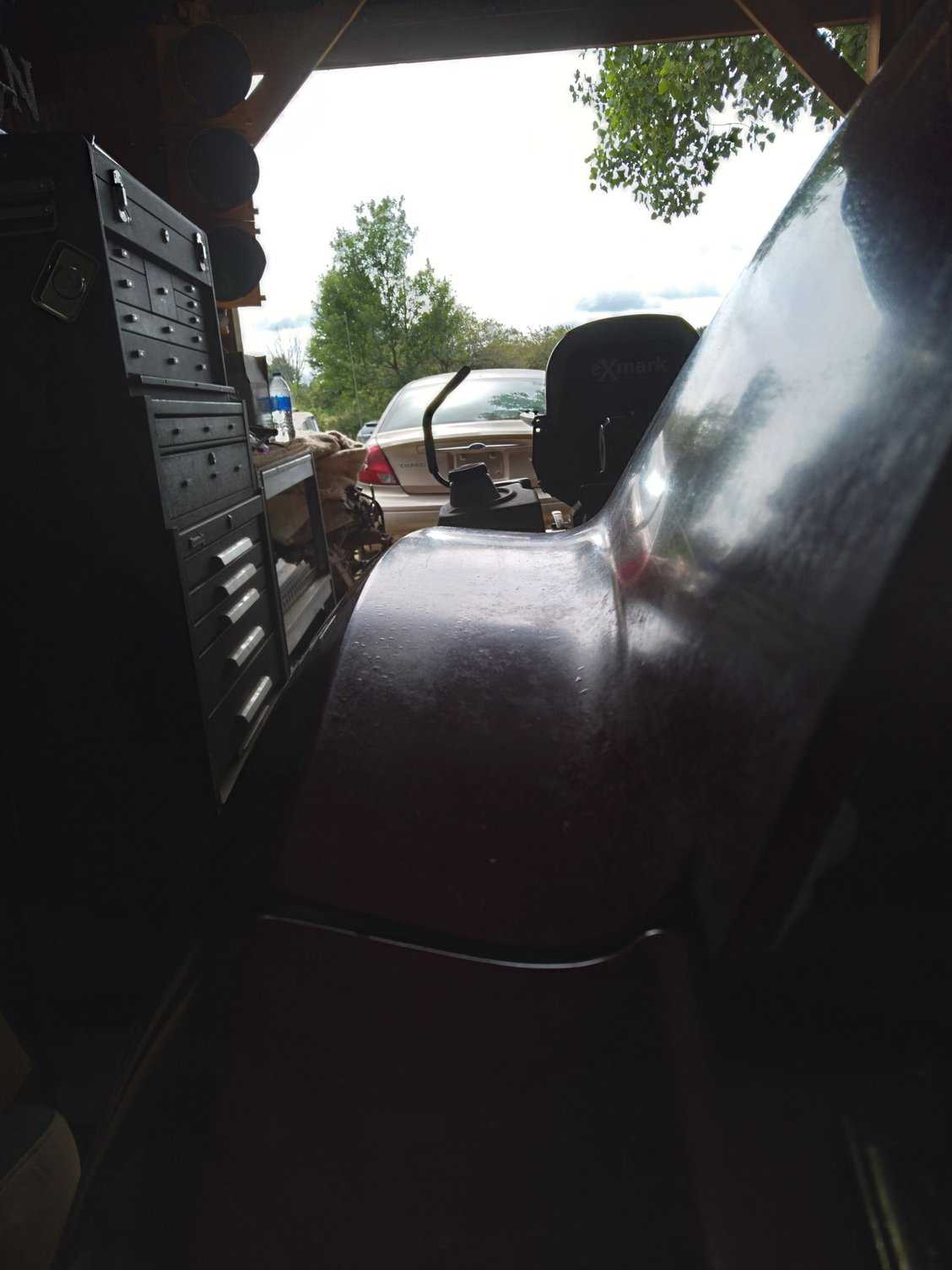

Anyone have a front clip?
Kidding, I have one, but...
The dark one (maroon) is a 76, the orange one is a ducktailed 73.
I am NOT doing the 76.
Has anyone grafted a ducktail onto a post 74?

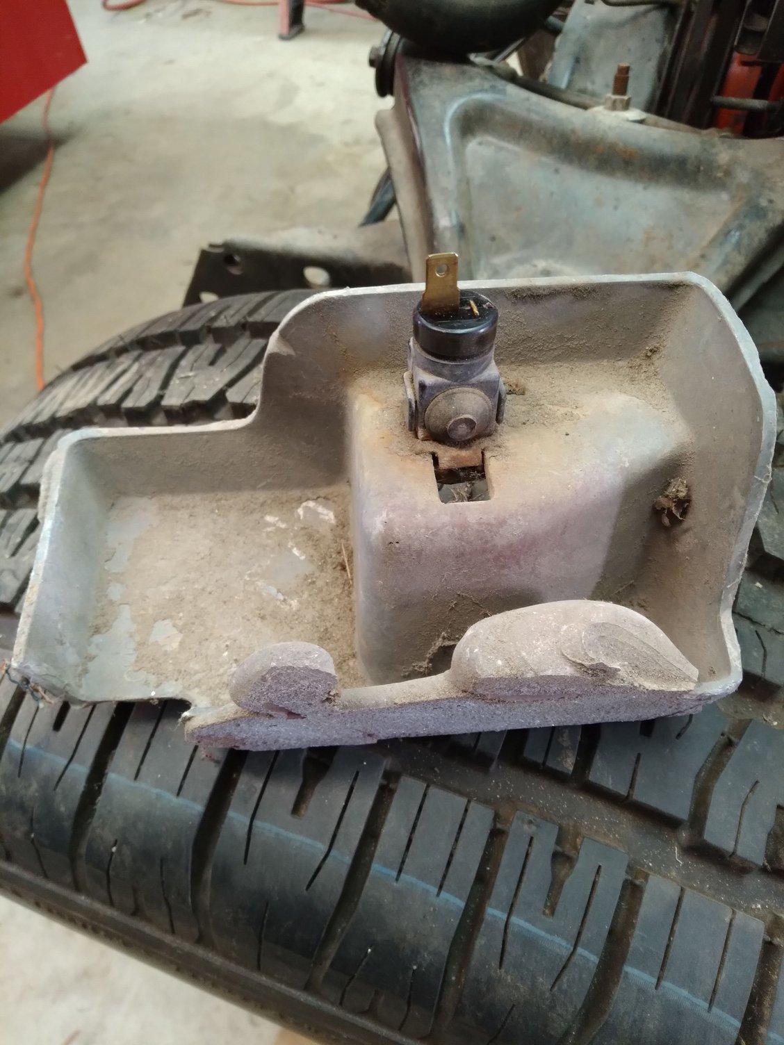

What is this thing?? Was laying on the ground after I got the clip off the 76, on the drivers side.

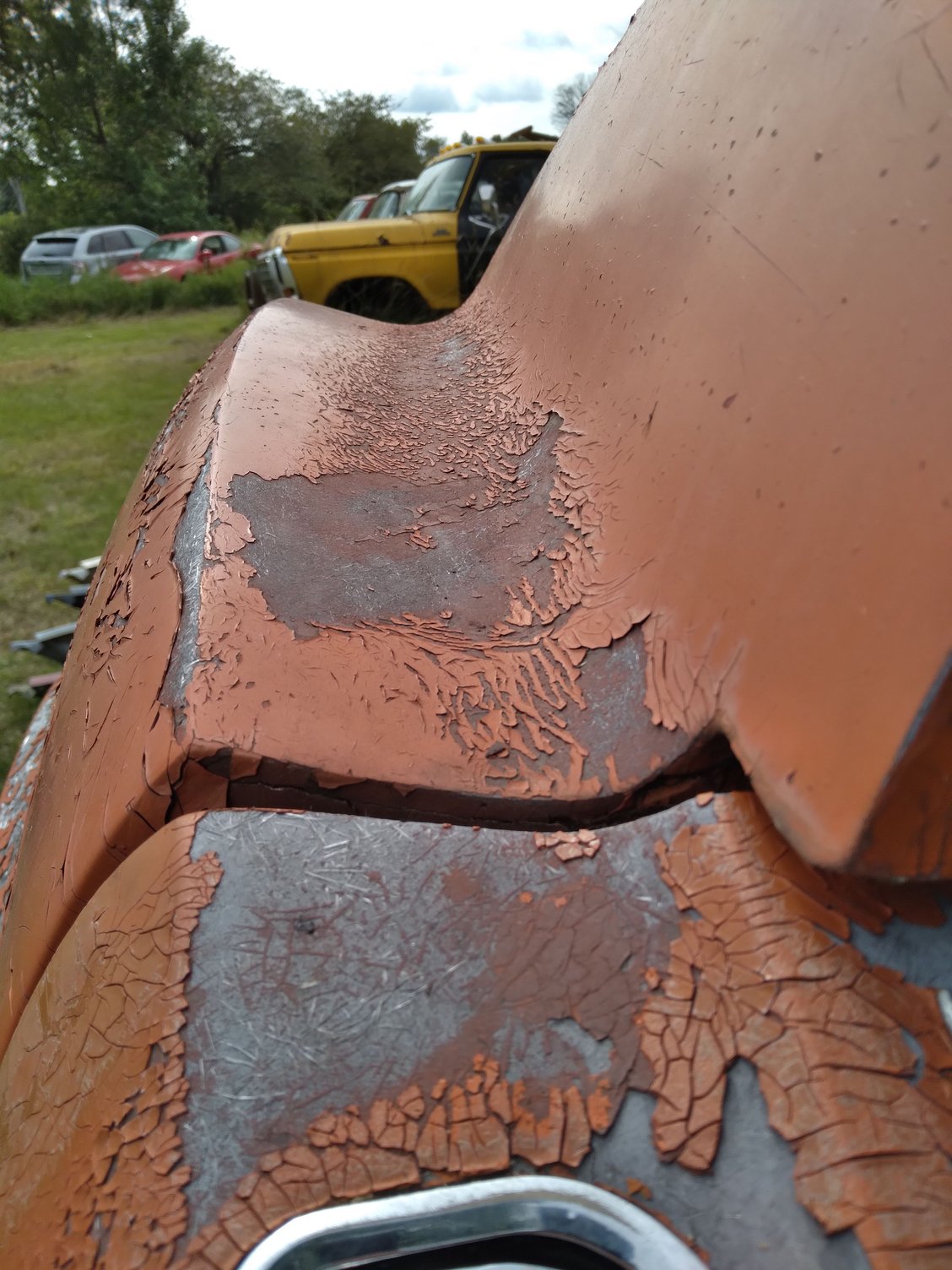

this is a ducktail on a post 74?
What happens with that contour i took the comparison picks of? Is the peak lower on the post 74 or is the valley lower on the ducktail coupes?
Click on the link below....it's a longgggggggggggggggggggggggggggggggggggg g story.
https://www.corvetteforum.com/forums...post1590630203

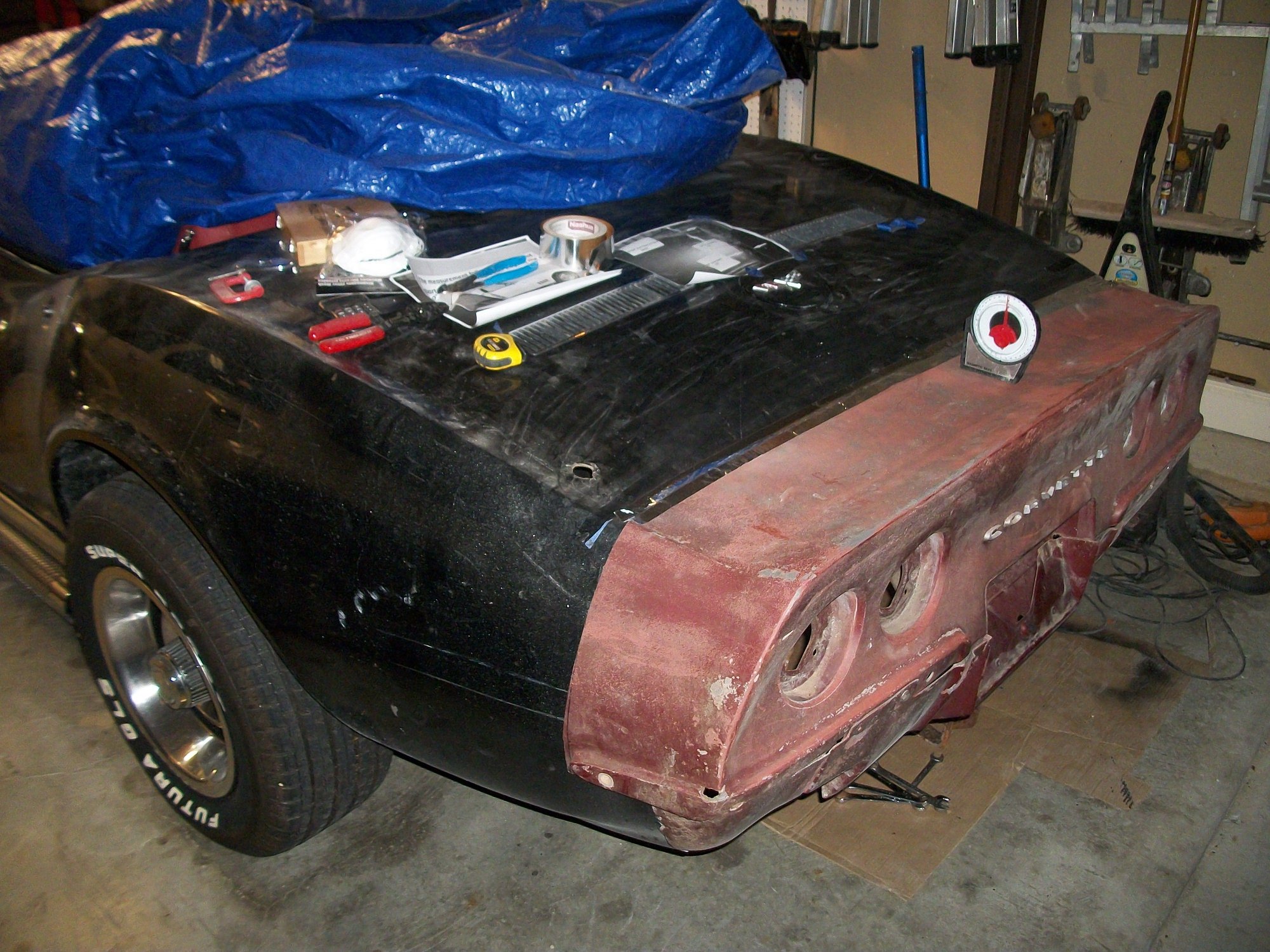

So that was a pe 74 that someone, FOR WHAT UNHOLY REASON I HAVE NO CLUE! put a post 74 rear on and then you pit a pre 74 rear clip on??

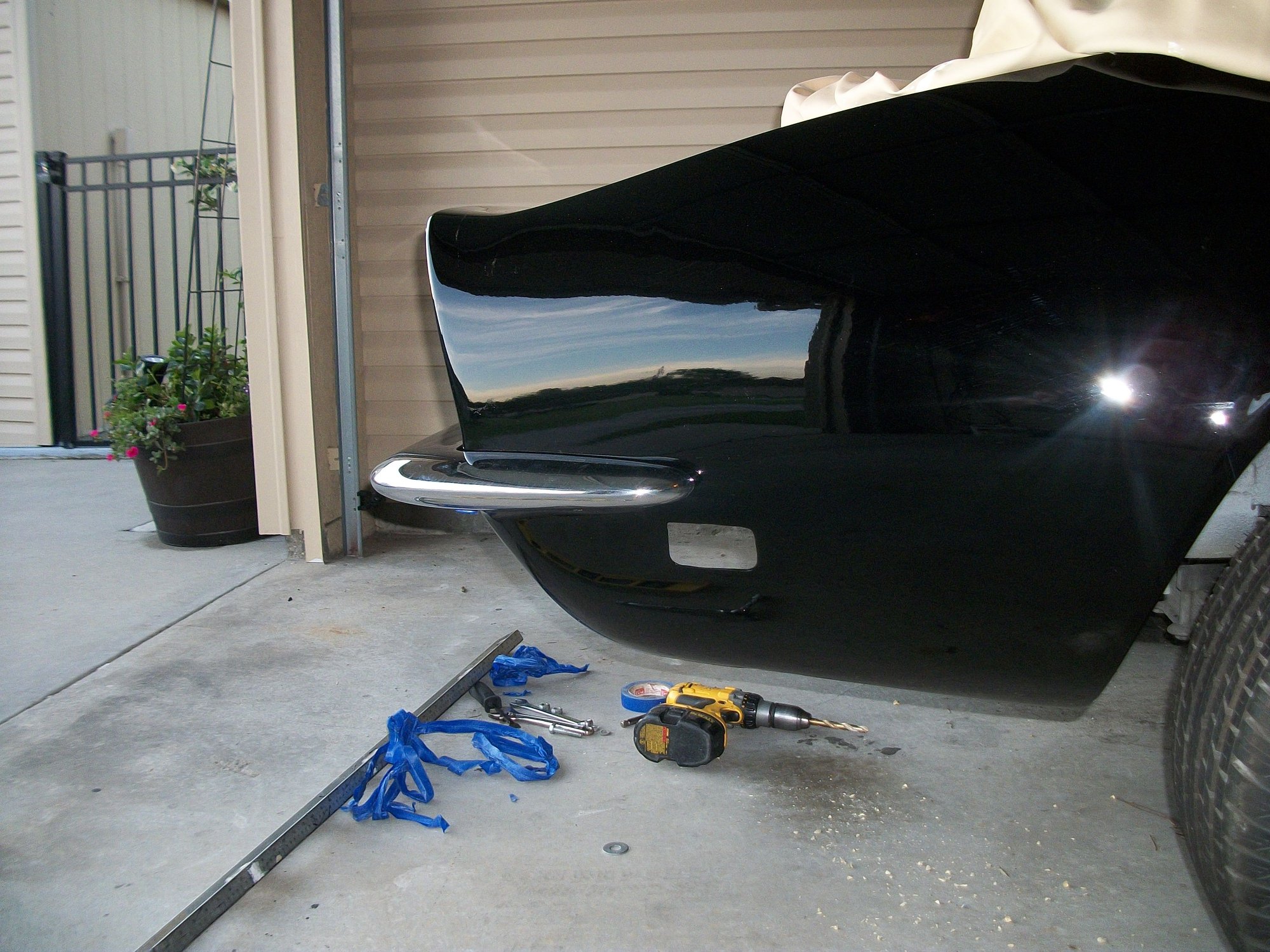

Here you go-
Priya's 79 chrome bumper conversion project
https://www.corvetteforum.com/forums...n-project.html

So that was a pre 74 that someone, FOR WHAT UNHOLY REASON I HAVE NO CLUE! put a post 74 rear on and then you put a pre 74 rear clip on??
You said it much better.

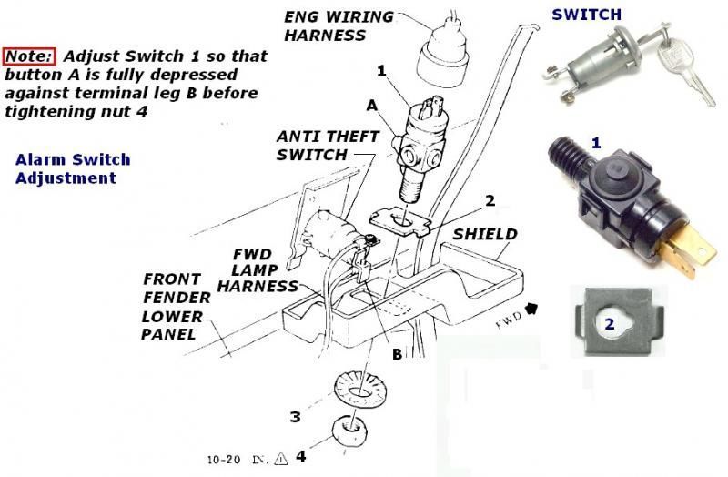

Default Does this help?
[/QUOTE]
So THAT'S what that key is for!
This one has had the fender replaced, no key or key hole.

Both of these bodies have their pluses and minuses condition wise, so I'm going with the 73 to avoid grafting because it looks like I have to go the rear edge of the doors on the graft to get all of the curves of the ducktail...and it also has a more or less intact front clip.
Lots of work ahead regardless.
