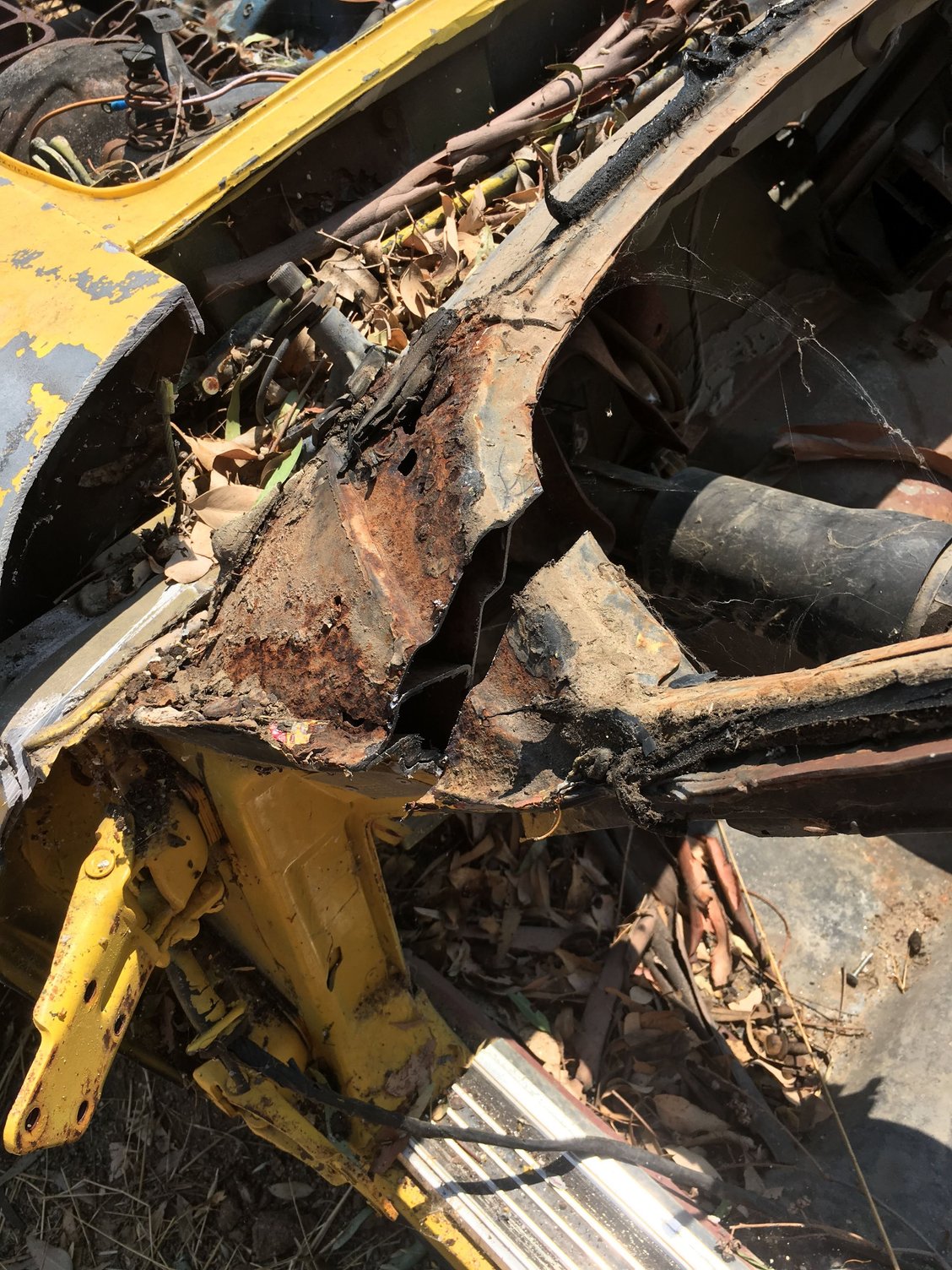

Well, my friends, after a few days delays the car is off for surgery
The surgeon said he will send me pics of the process so looking forward to posting them here

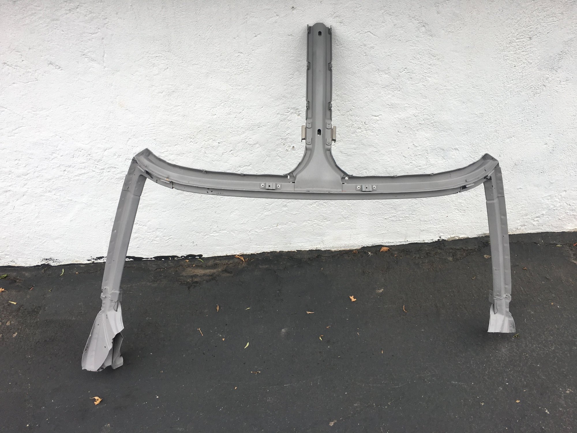

Harvesting a parts windshield frame
Now it is off to the sandblaster
Old Aug 23, 2021 | 12:11 AM
  #87
gleninsandiego's Avatar
gleninsandiego
Joined: Jun 2004
Posts: 4,023
Likes: 1,181
From: La Mesa CA

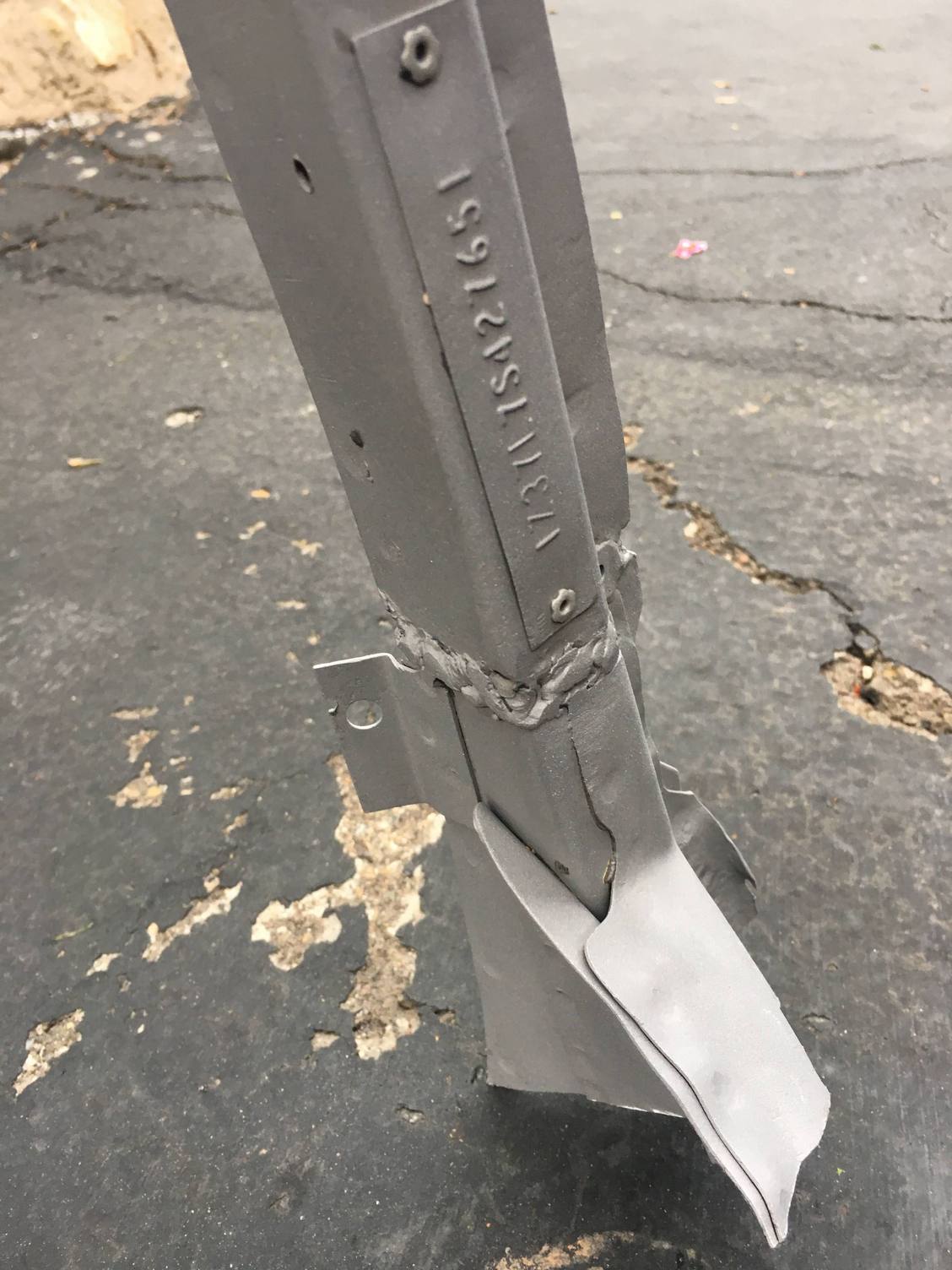

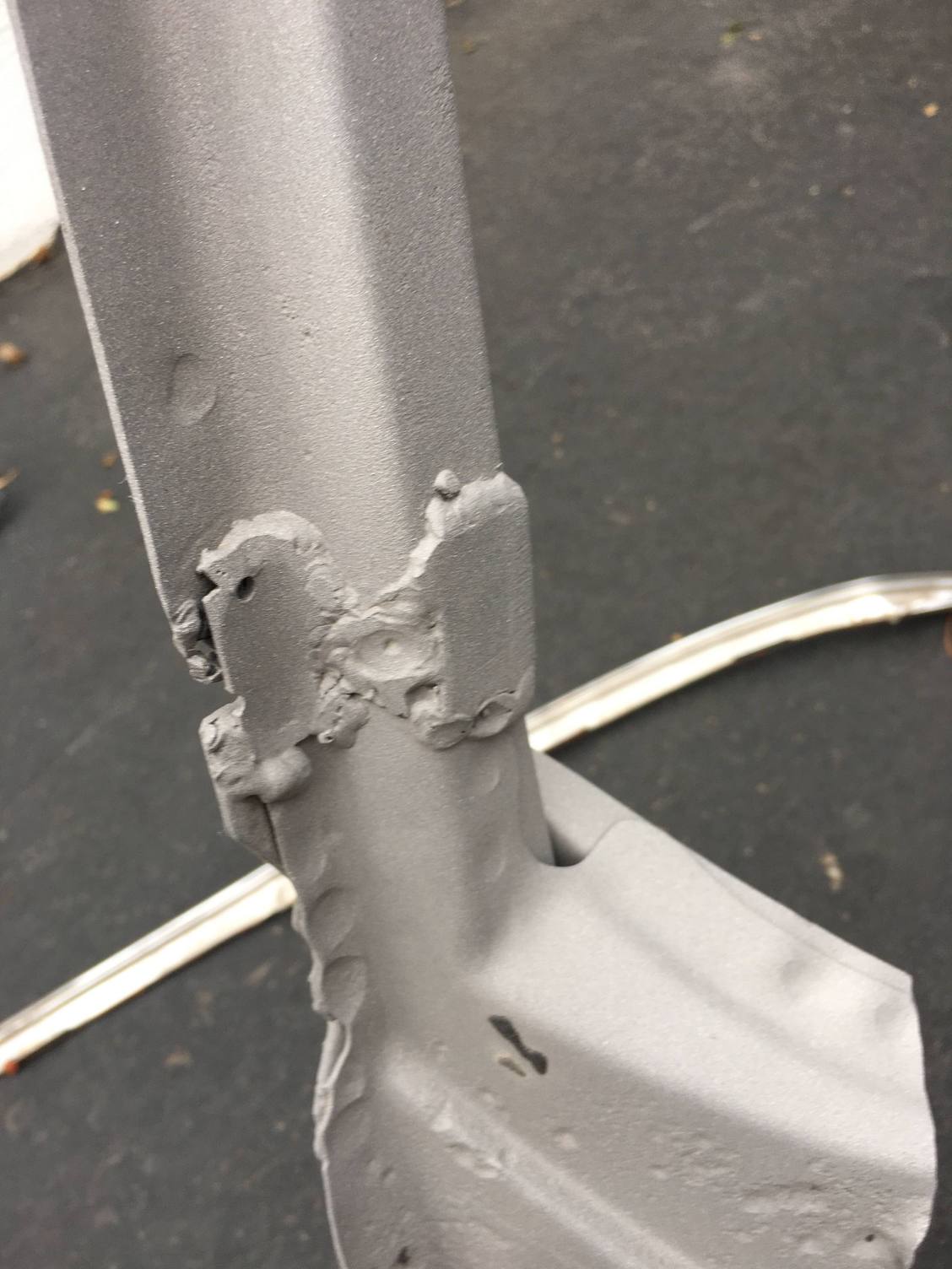

Back from the sandblaster and the replacement part turned into a dud.
With all the gook off, it turns out the part was previously repaired, and repaired poorly
Back to the drawing board.

the upper frame is pretty good and the lower pieces look ok. it is the butcher weld job looks like i did it. (self-taught backyard a-hole welder...) i would consider cleaning up those 2 welds and proceeding with that frame.

Didn't I see "insert pieces" somewhere that go inside so you can weld to that rather than trying to butt weld that back together?
