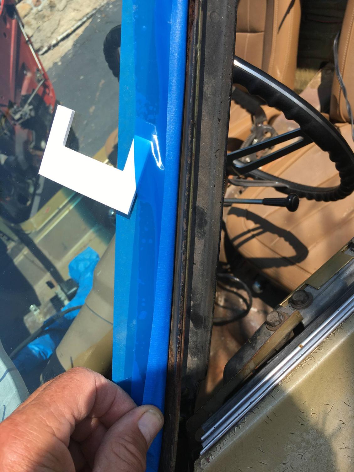

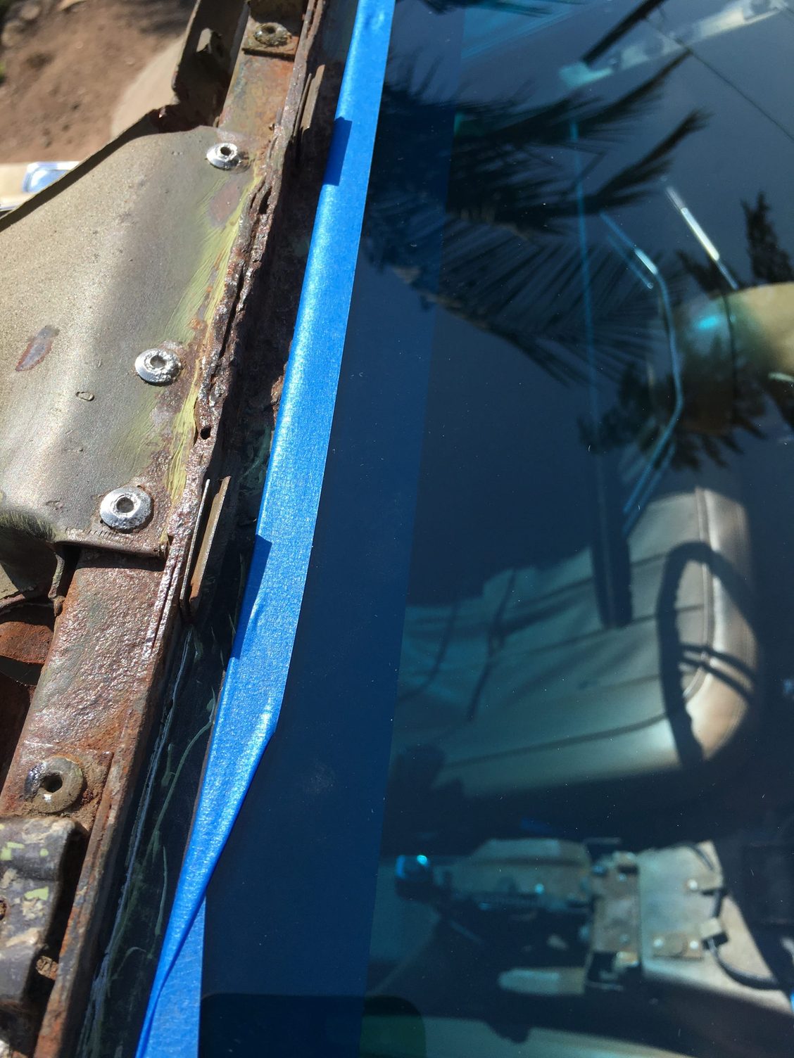

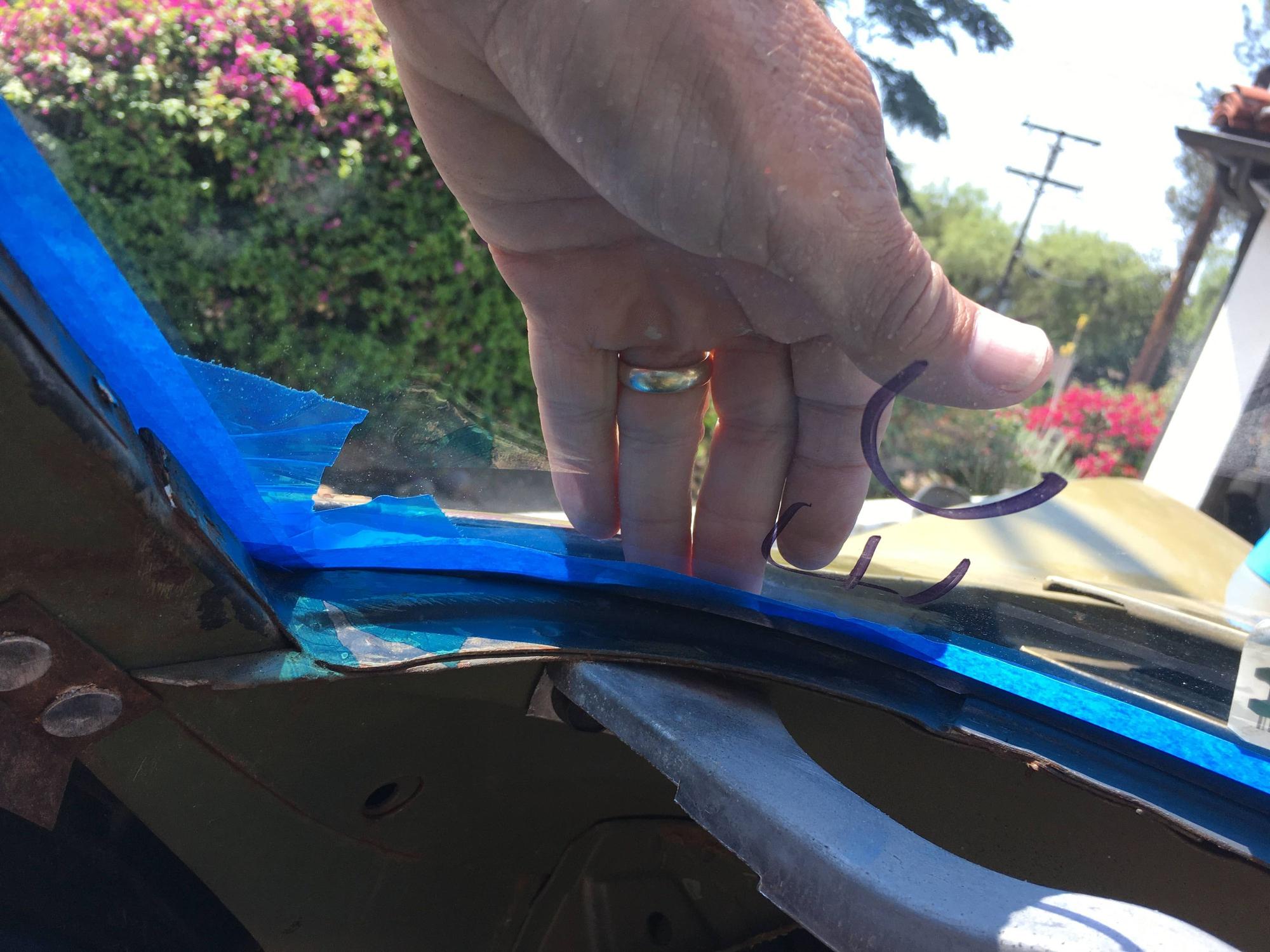

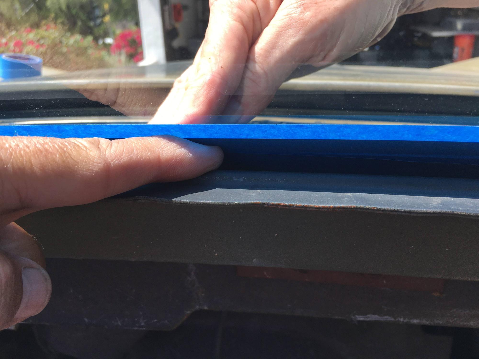

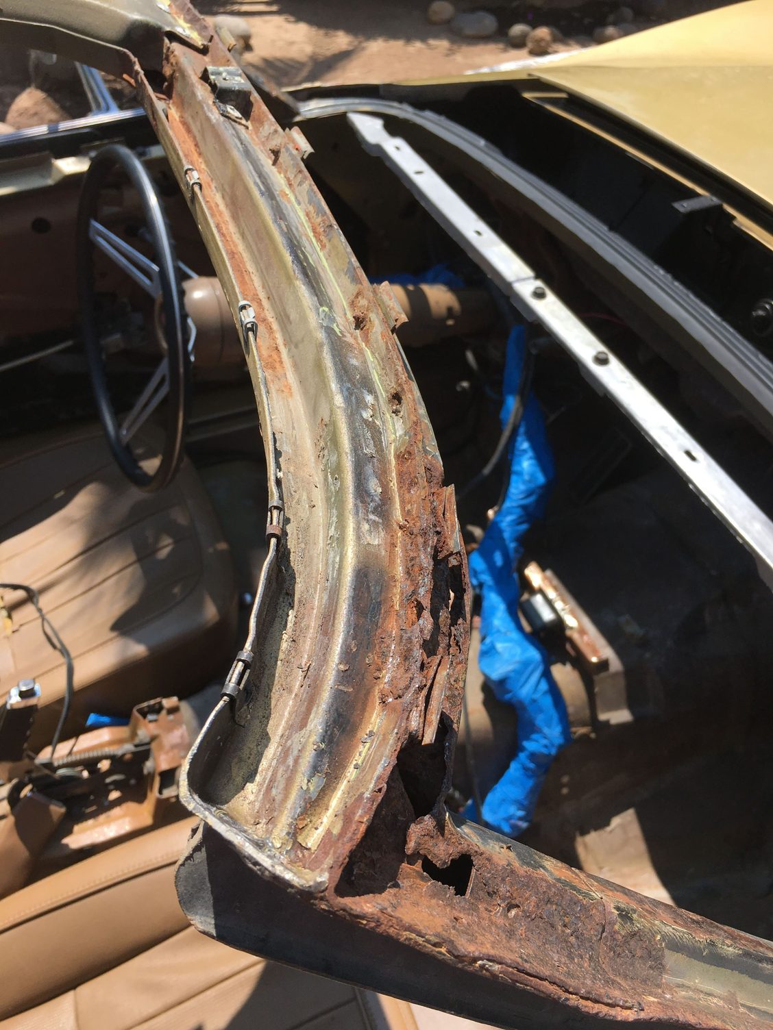

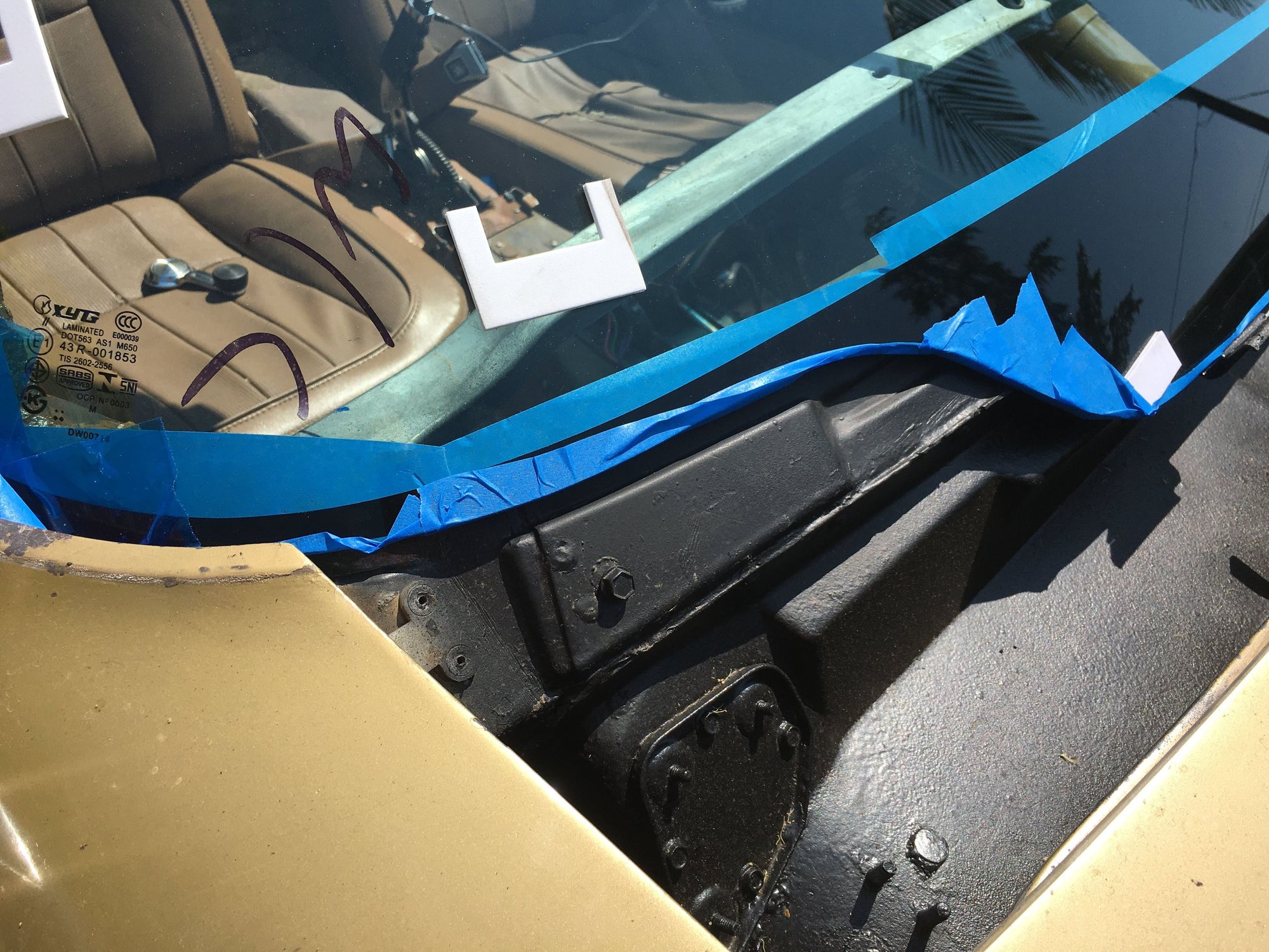

This morning I did two things
1. I started by laying in the windshield to check the fitment with the existing frame.
Surprisingly it fit pretty good and laid flat against the top and sides.
The only concern was a small gap on the bottom.
The picture makes the gap look bigger than it is. Maybe 1/4 of an inch? Is that too much?

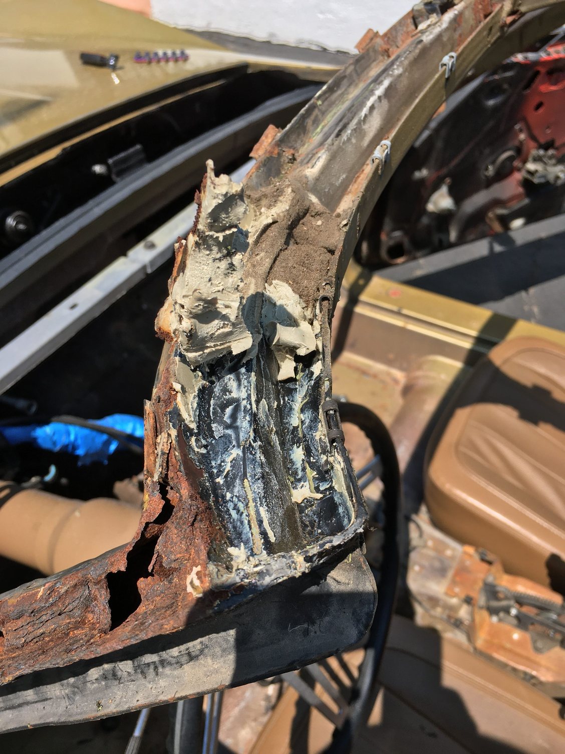

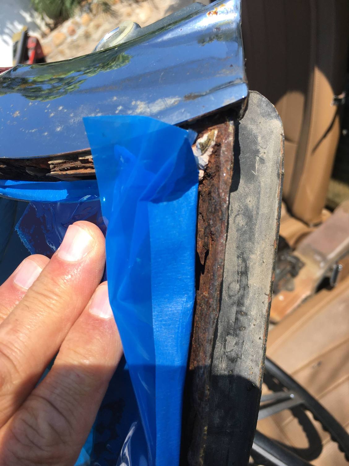

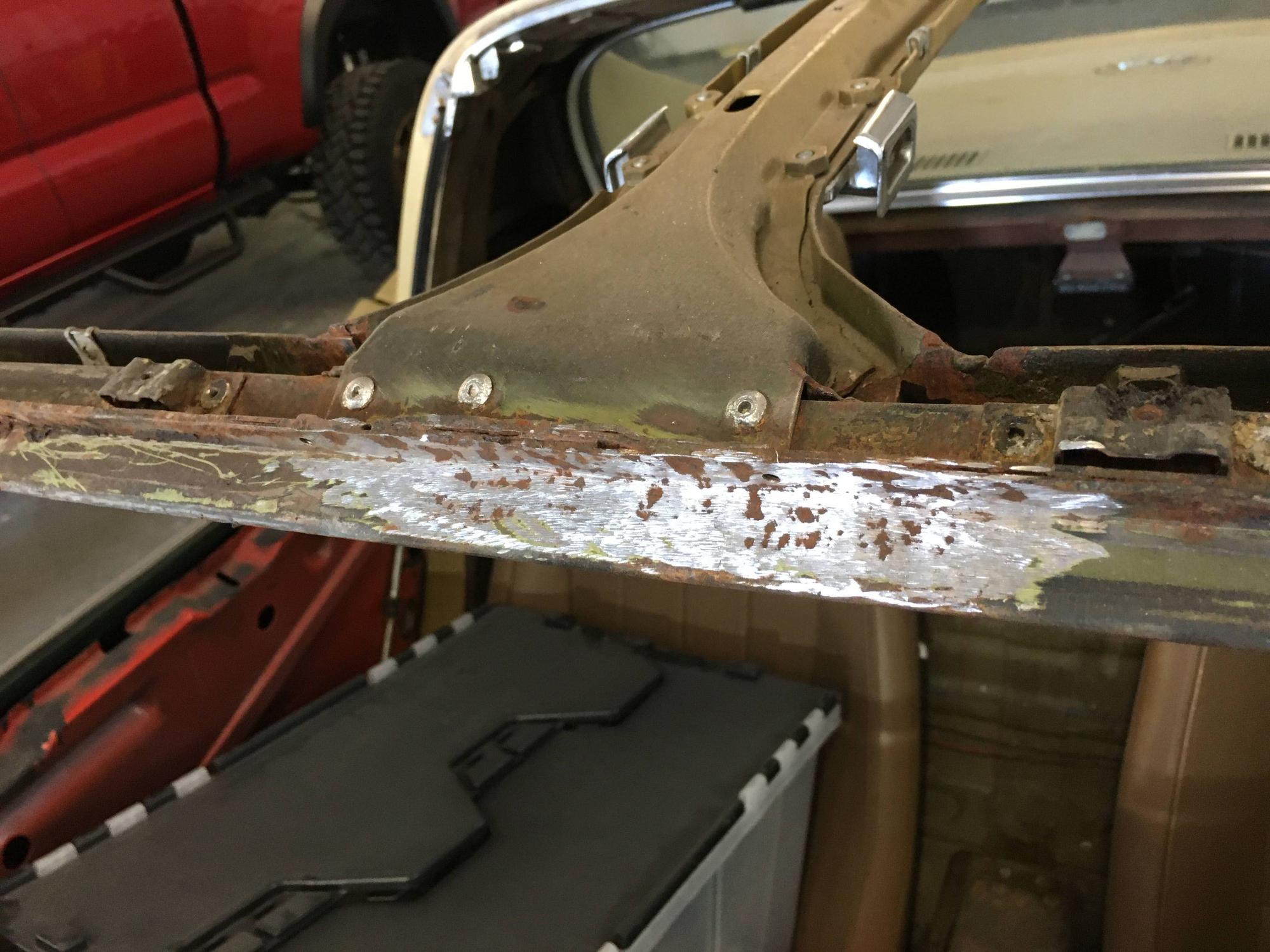

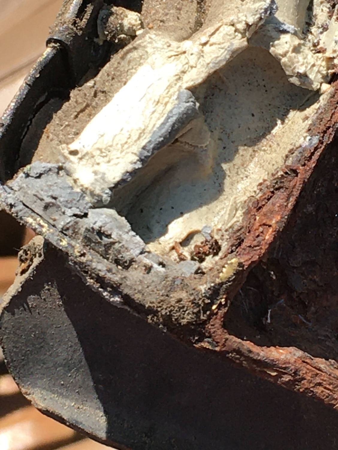

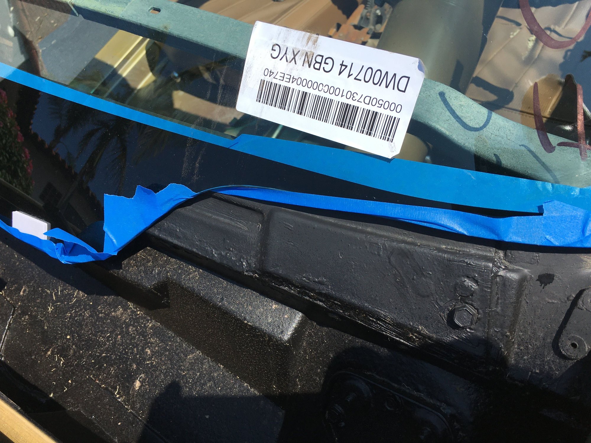

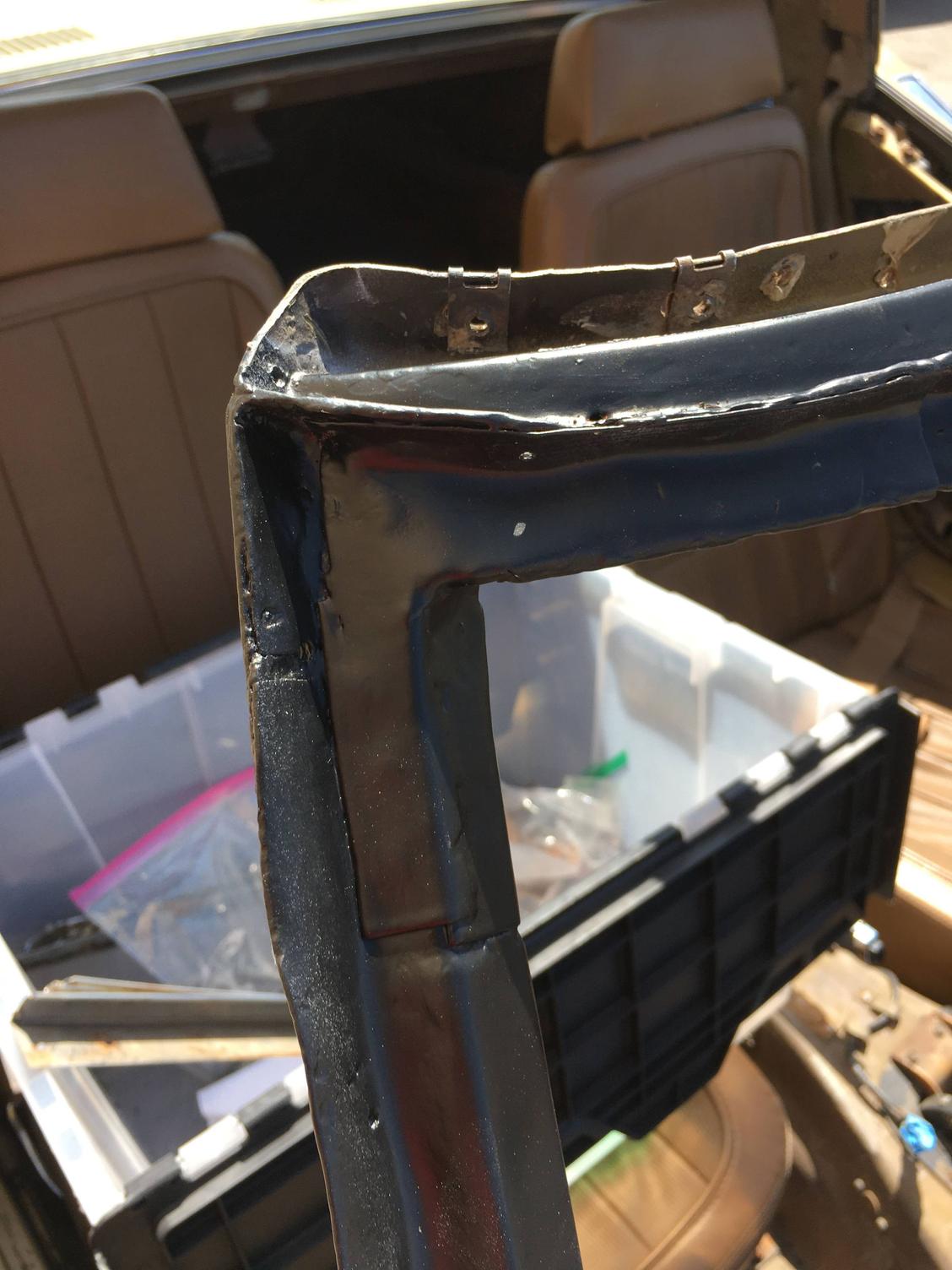

2. Then I took off the corner pieces and found a bunch of calk, which I proceeded to remove
Driver's side
Passenger side
So the good news is that at every point of the surround, there is solid metal
Most of the rusted out areas are located on the outer facing surface of the A pillar
So in theory you could cut out that outer facing metal and patch it.
More to ponder

That is good news Glen. Damage like this is usually on the front face (unless it's really severe). You have good structural integrity left there.
Whatever areas you can't get into well with a wire wheel, use a good rust remover like Evaporust, Loc-Tite Rust Dissolver, Rustoleum Rust Dissolver, etc. Spray/rub them in and/or slop it in with a paint brush, rinse it out. I assume you have access to an air compressor to blow it out real well when you're done. Temp in SD is 81 today so it should go very well for you.

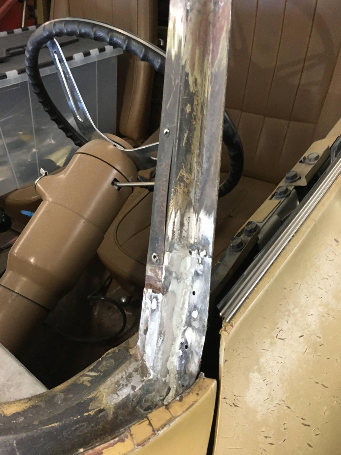

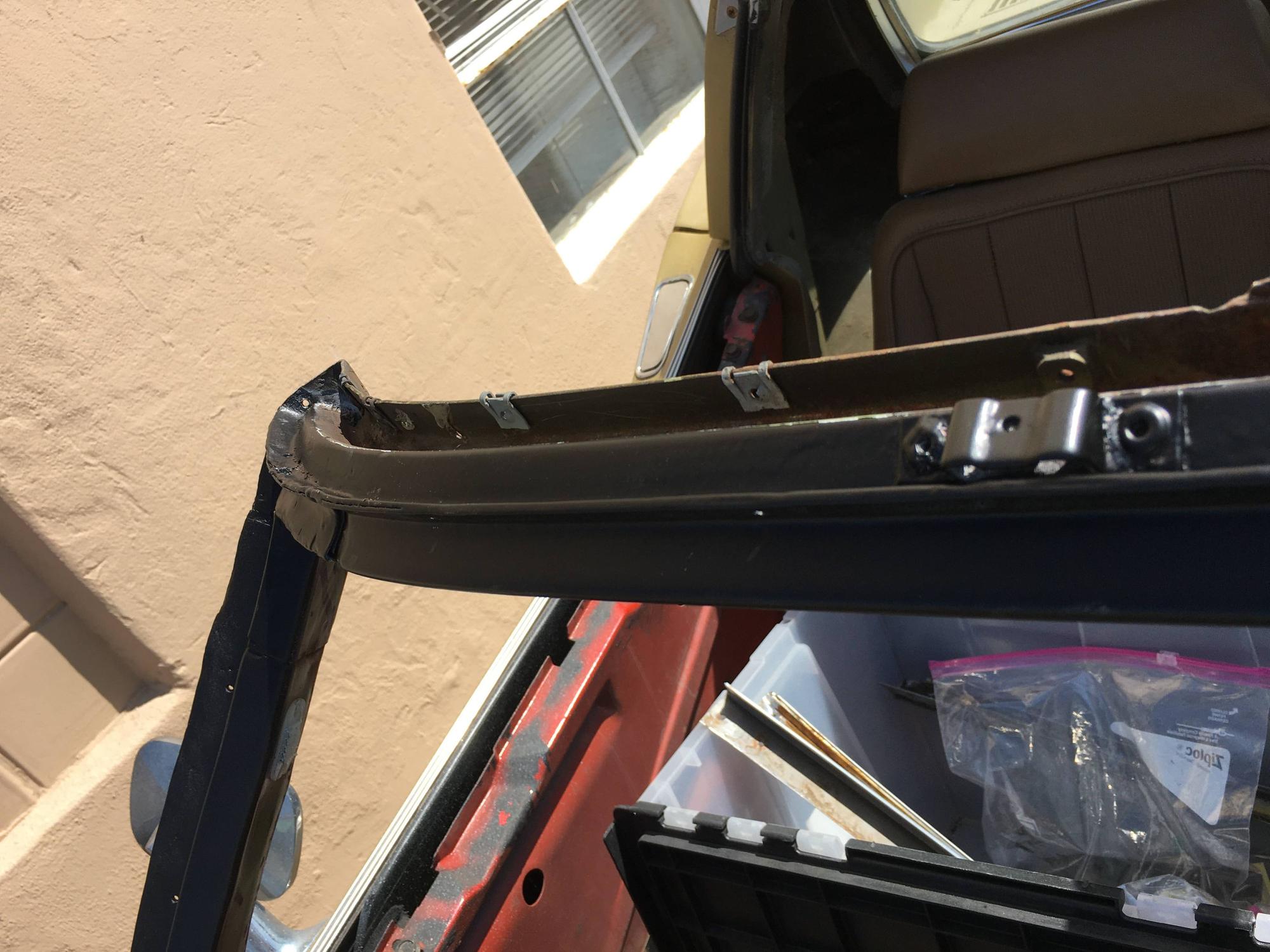

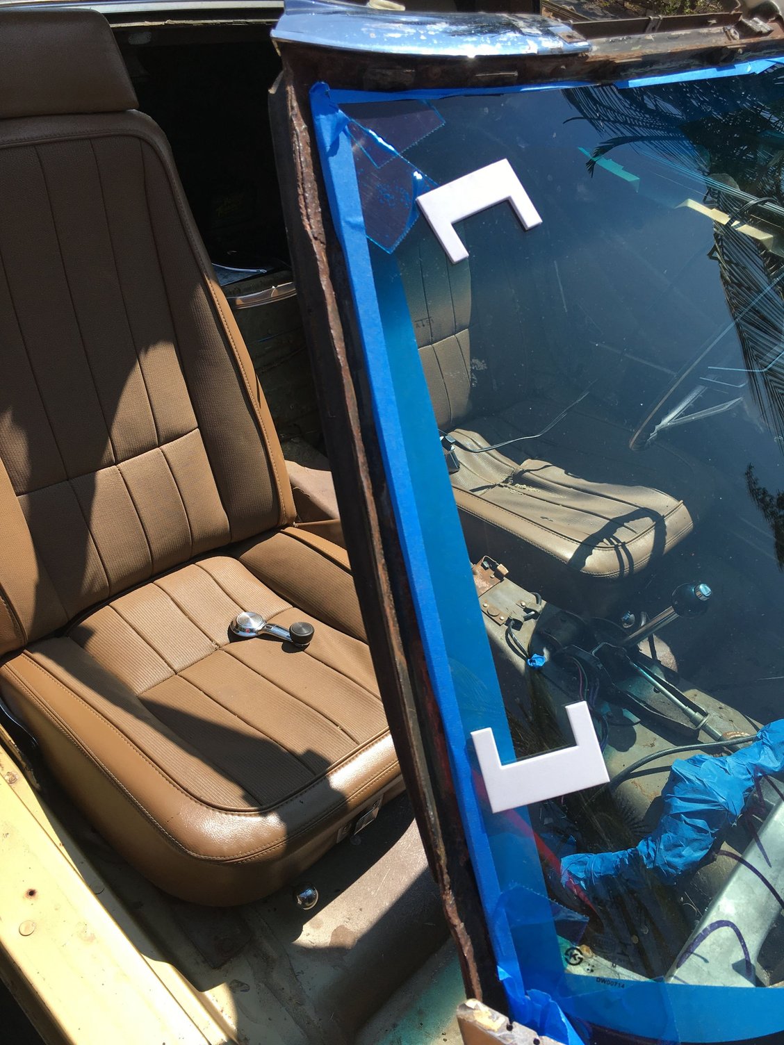

Men, the plot thickens

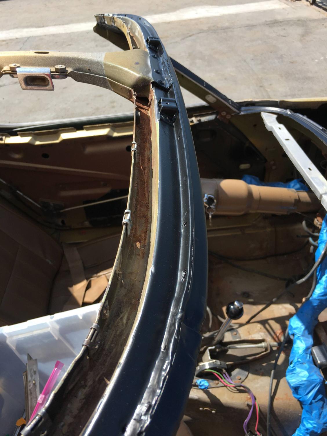

As I was working on the windshield surround today, it appears as if the passenger A pillar was bent when the
passenger door was hit years ago. It has been straightened but it does give more things to ponder here

Shouldn't be too difficult to straighten out with a little heat from a torch now that it's all apart.

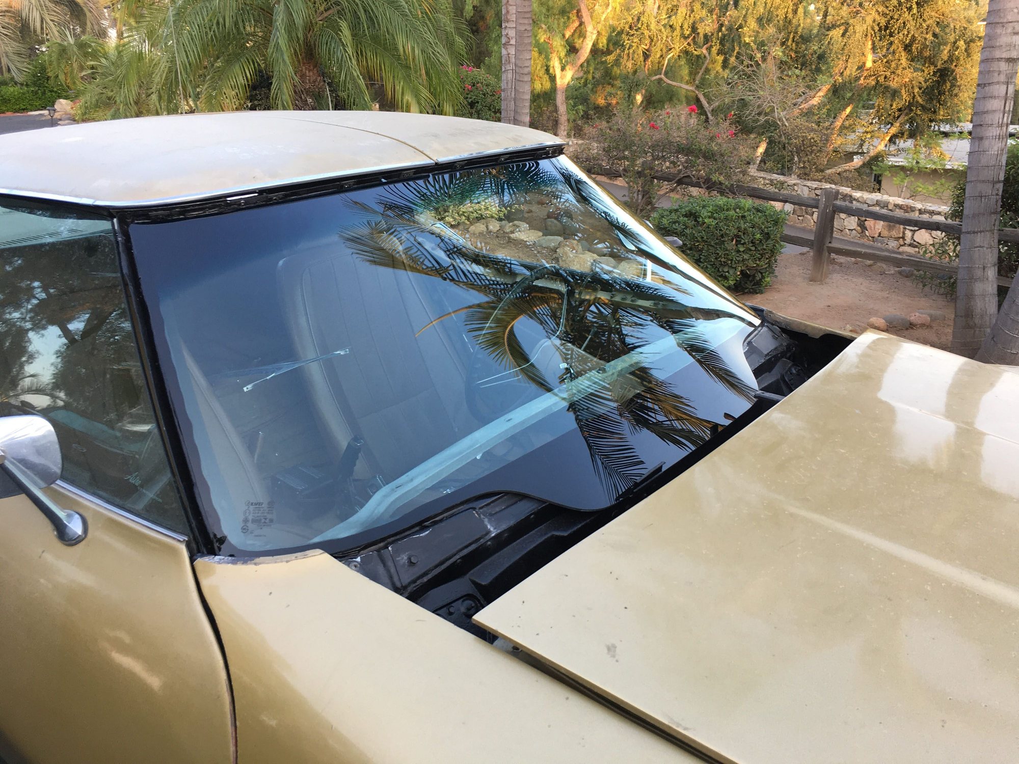

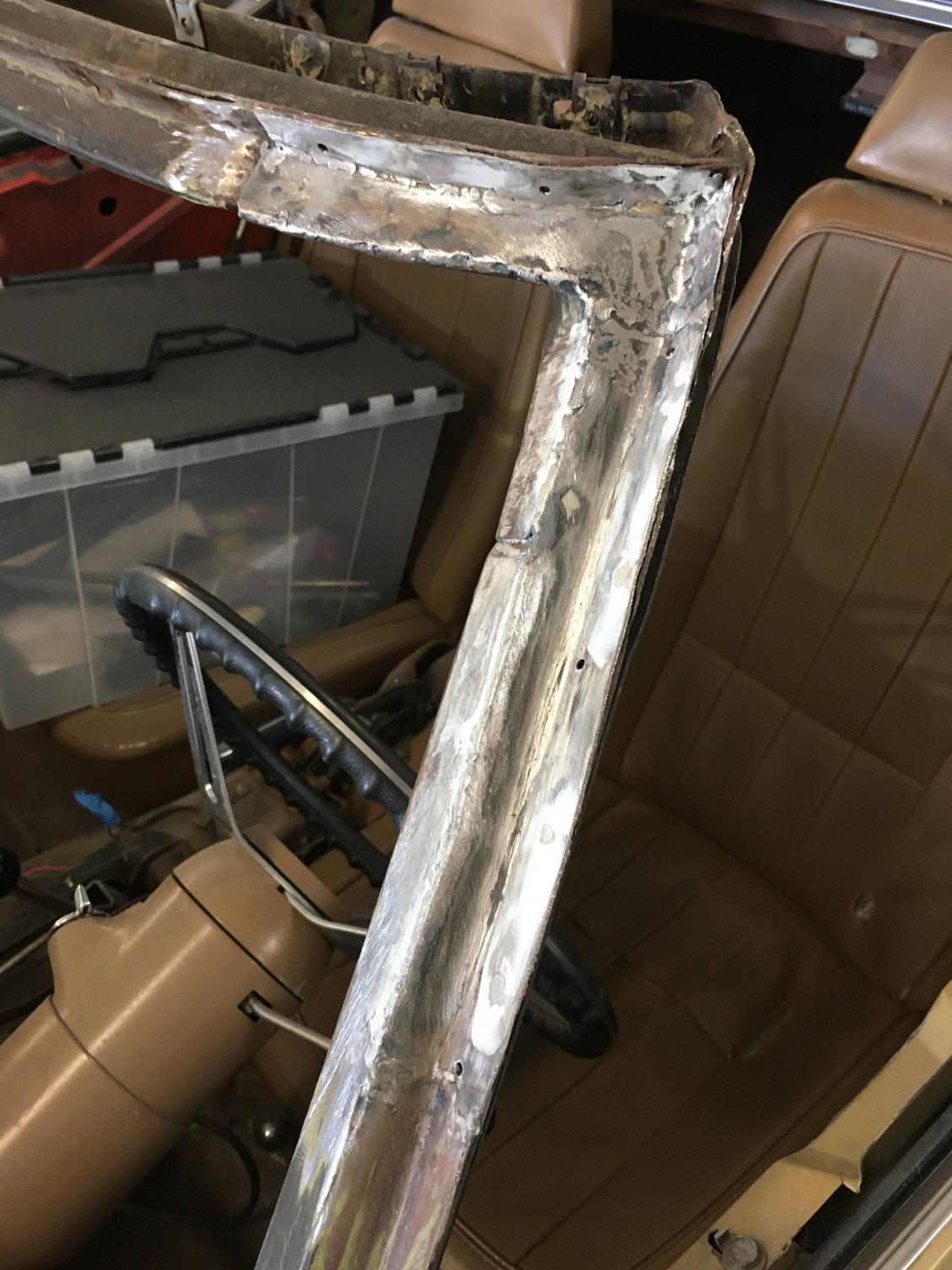

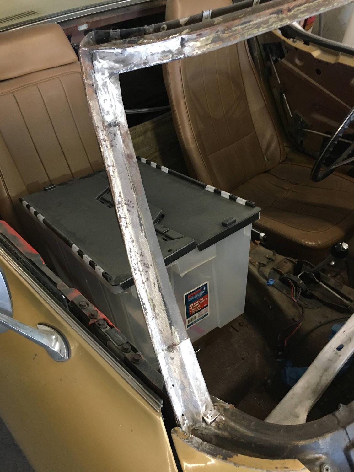

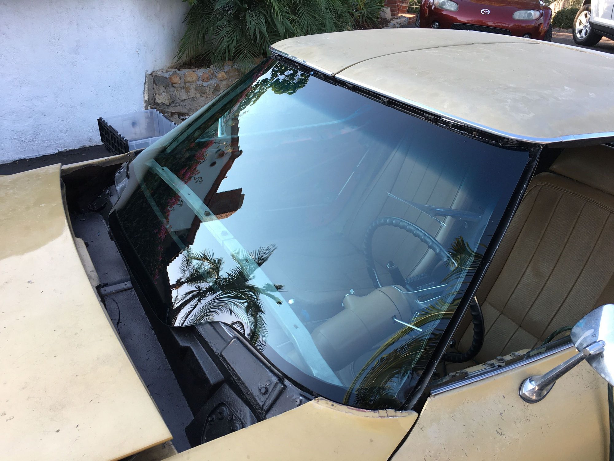

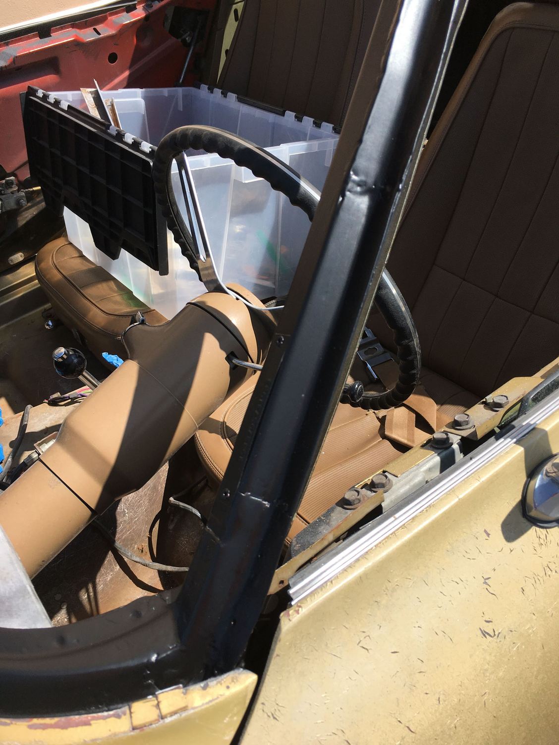

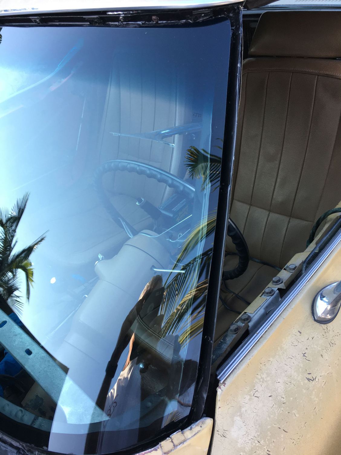

Progress!
Rusty metal cut out, new metal patches being welded in
Time for paint
Windshield installed
I still need to check trim fitment but at this point I will call it a win!

Congratulations and VERY NICE Work by the welder!!!
Onward to the next item!
BTW, what did you paint the windshield frame with, looks great?

Real nice work Glen.
Exactly the way I would have done this repair too.

Will need to ask the body shop about the paint
