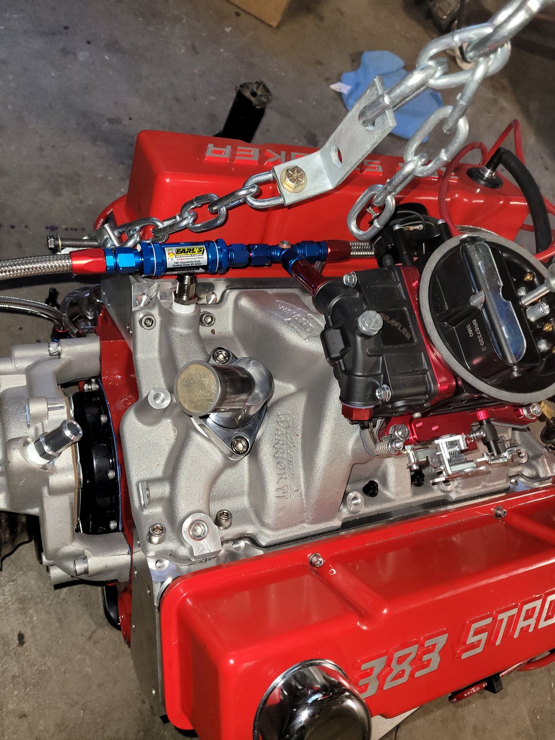

I bought a holley type dual feed rail that summit sells that has a built in fuel gauge and a removable brass fuel filter inside. I have the popular generic black and aluminum 30 micron AN fitting filter but couldn't find a convenient place to mount it so I went with this option instead. I'll know when the filters plugging up as my gauge reading should decrease when that happens.

I did hardlines at the engine to hang my filter and also one with rubber hose by the tank.
