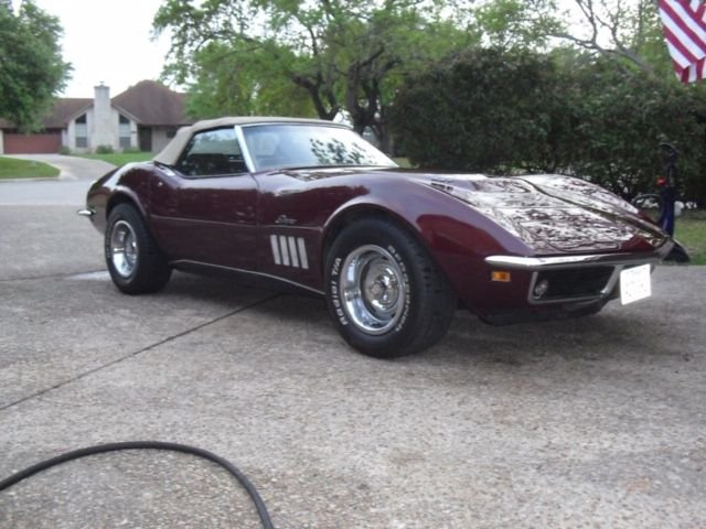

255's rub at full lock on most C3's....but how often do you drive at full lock? If you hear it....let off the wheel some. IMHO a 235 is too small....the 225/70 is too narrow. The 255/60 looks the best to me. Here is my old 69' 427/400 with 255/60/15's....it rubbed very slightly at full left lock, but once you are aware of it.....you will get used to it....and it rubs a small flat area of the frame so damaging a tire is not likely. I hate derby caps so there is that too...LOL!
