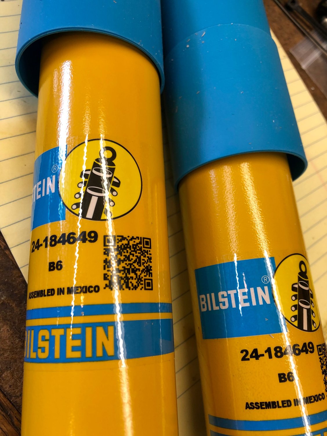

now the rears..made in Mexico???? Damn.. oh well if i knew that i would have gone another USA brand..

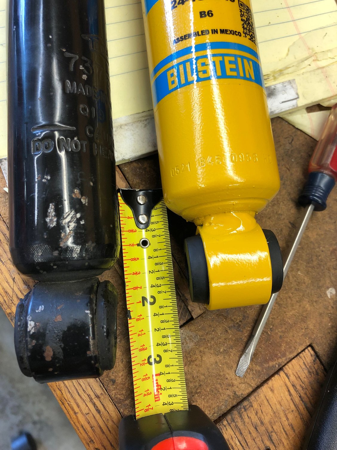

- the rear b6 is 3/4 shorter than the replacements? Is this ok? I had to jack up bottom strut to get it on and so the rear suspension When lifted mow is stopped by the shock..? This ok?

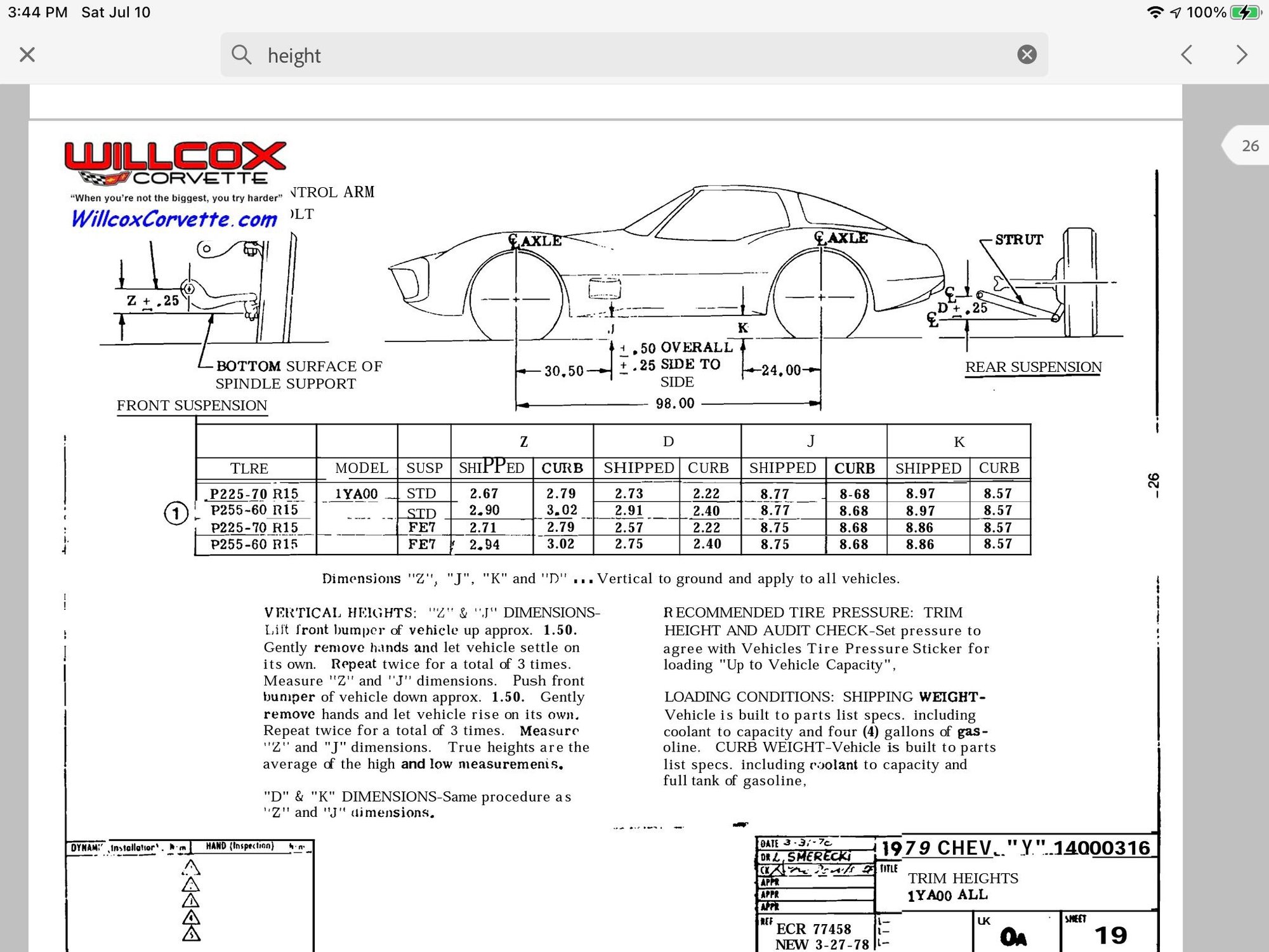

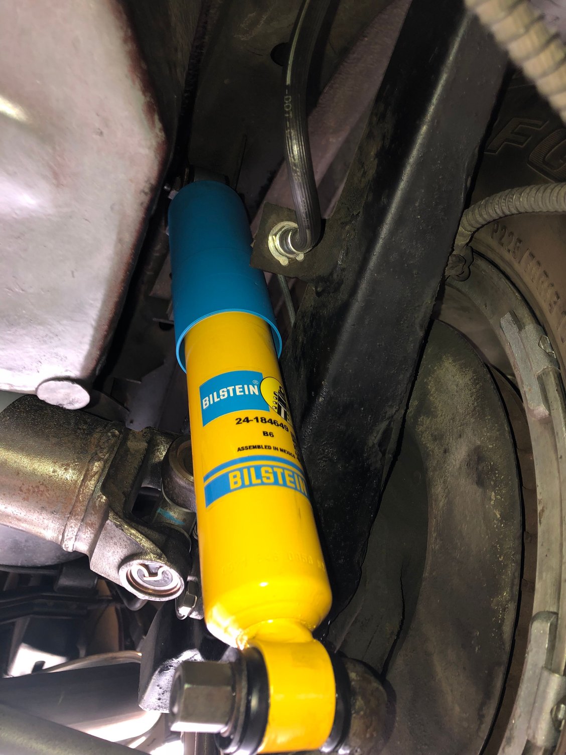

manual says 2.2 inches center bolt upper and lower when torquing..i basically lifted it until off quickjack and torqued 50 NM
Reading the manual i also put the bottom washer the wrong way..it should flare out not in so that is correct…seems illogical but…

Says D height 2.2 in hes when torquing
3/4 shorter??
Damn..mexico..paint thin too
I had washer wrong bottom see note

I noticed that my Bilstiens were a bit shorter as well. But I have the B8's in the rear. So I figured that was normal. I have a glass spring and slightly lowered rear. So seemed perfect for me. a have about 3 thousand miles on them now and I'm very happy with them. I live in Australia so I had to have them shipped over. cost me double what the guys in the states pay. And I'm still happy. I'd say, go for a drive down a bumpy road to settle them in and judge for yourself. I'm thinking you have a steel spring with B6's. Let us know what you think after you put some miles on them.

It would bother me that the shock is extended out and becoming the down stop.
I tried looking up my rear qa1s. I think that they're 15 inches extended. So my smart struts are the limiting factor. I can have the rear tires off the ground and remove the shocks

You would think the concave washers would "cup" the rubber bushings/grommets similar to the top grommets of a front shock?

ride height same 28 1/4 to 28 5/8 all 4

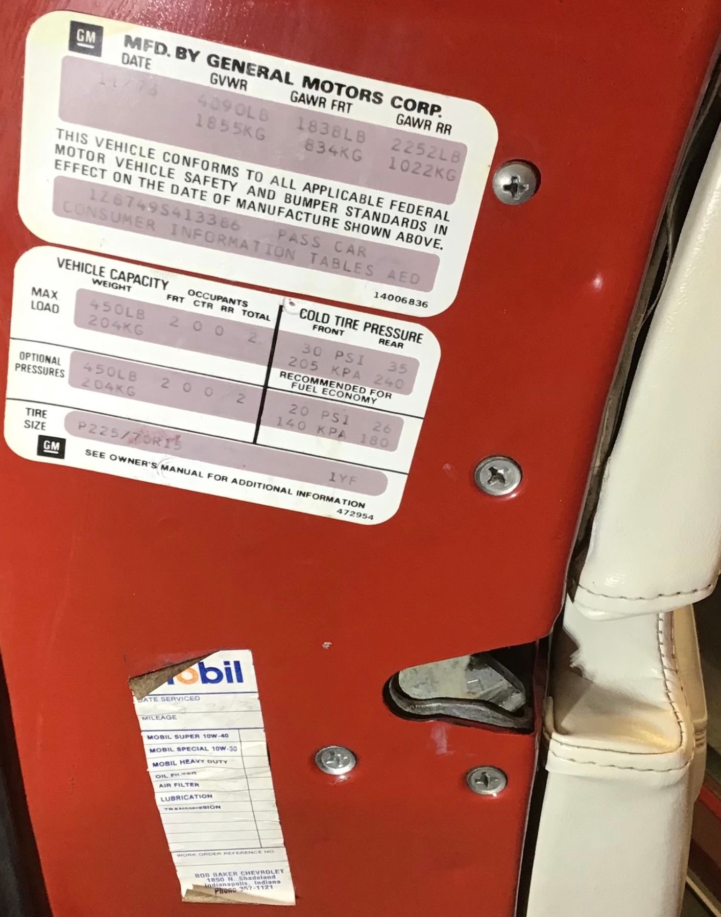

I run 2 psi more than recommended low pressures 22 and 28 psi

Not sure what tires your running, but willing to bet not original. I run Coopers and 32 PSI all around, have for many years. Door sticker pressures are for the original tires. Strongly recommend you disregard them.

BFTA brown letters ..same size as original steel radials..
ive tried a lot of pressure…i like the ride and handling at the lower settings and add a few pounds cold.. I’m rarely 80mph plus for any length of time
Edit….i also notified vendor that clearly advertised 🇺🇸

I believe that the concave washer is installed that way to put more squeeze in the middle of that rubber to help it stay centered and to prevent the rubber from 'walking out' of the shock loop.
