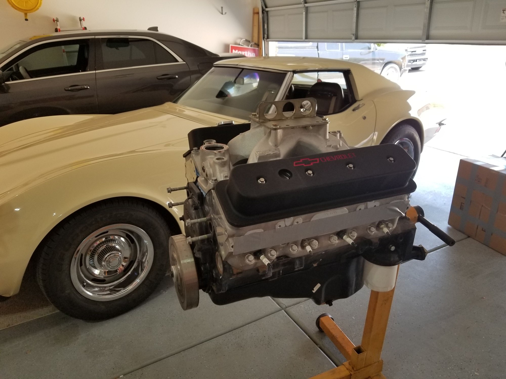

Will do. Its still on the stand getting dressed and should be in and running by mid Aug if all goes well.
I'm debating painting the alum heads orange, I'm torn but I think it would look more original.
