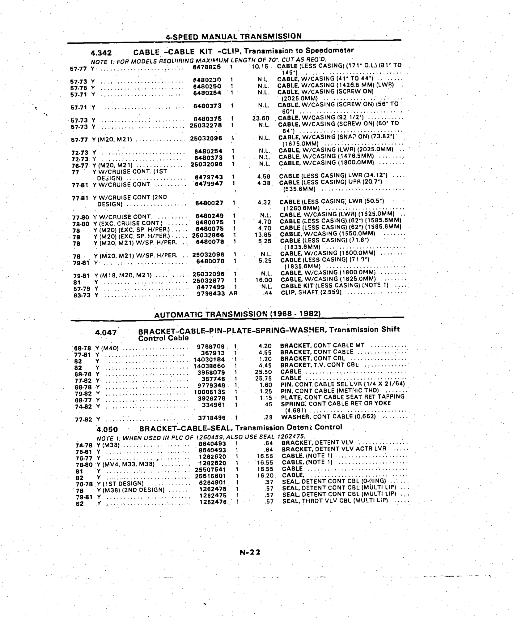

From GM parts catalog

P/N's are different; the square drive and coupling on the end of GM speedo cables is the same...
